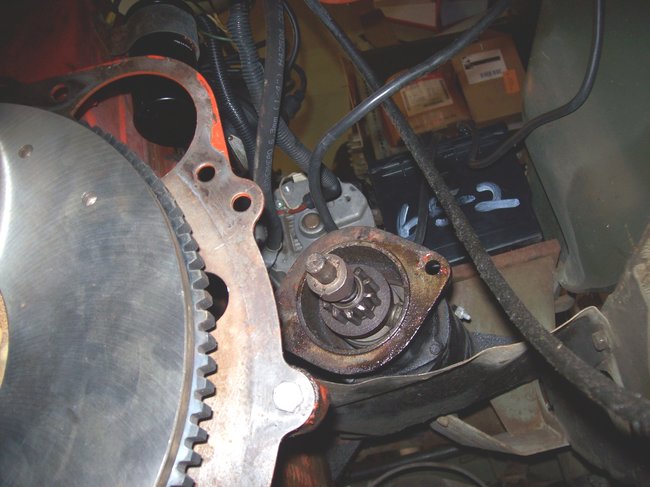

I HAVE BEEN LOOKING FOR YOUR STARTER EBAY/ ONLINE/ ONLINE PARTS STORES
I WANTED TO SEE IF IT LOOKED AND WORKED SIMILAR TO "WILLY'S" STARTER (MY '46 WILLYS JEEP)
HERE'S THE CATCH, HAS SOMEONE MODIFIED IT FROM 6 TO 12 AND IS IT STILL POS GROUND (IF IT EVER REALLY WAS)?
MY JEEP 6 VOLT STARTER SPUN MEGA FAST WHEN A 12 VOLT BATTERY WAS HOOKED TO IT. ("THEY" SAID IT WOULD BE OKAY!) WELL IT WUDDN'T, IT SPUN FAST AND THE STARTER DRIVE SLUNG OUT SO HARD THAT FORCE WOULD BUST THE END OFF OF THE STARTER DRIVE AFTER MAYBE EVERY 100 CRANKINGS. AFTER TALKING TO A "STARTER GUY", HE SAID I COULD CHANGE THE FIELDS TO 12 VOLT FIELDS AND THE STARTER WOULD SLOW BACK DOWN (ON 12 VOLTS) TO ABOUT THE SAME RPMs AS IT WAS ORIGINALLY ON 6 VOLTS.
THE FOLLOWING IS PASTED FROM A 2011 POST I ANSWERED
MY STARTER (SHAFT) WILL TURN BACKWARDS--HOWEVER THE STARTER DRIVE WILL NOT KICK FORWARD. IT WORKS WITH AN ECCENTRIC WEIGHT, AND A ACME SCREW, AND TURNING BACKWARDS ACTUALLY SCREWS IT "INWARD" AWAY FROM THE FLYWHEEL!
IT GOES ZZZZZZZZZZZZZZZZZZZZZZZZZZZZZZZZZZZZ! (WHEN IT SPINS BACKWARDS)
NOT A RUMP A RUMP A RUMP A RUMP!
I FOUND THIS OUT WHEN I INSTALLED MY NEW 12 VOLT FIELDS INTO THE OLD 6 VOLT STARTER HOUSING. HERE'S THE CATCH. INSTALLED MY BRUSHES PLATE A 1/4 TURN, FROM THE CORRECT POSITION (CAUSE I FAILED TO MARK THE HOUSING WHEN I TOOK IT APART)
I TOOK IT ALL BACK APART AND TOOK THE FIELDS BACK TO THE ALTERNATOR SHOP AND PROCLAIMED "I HAVE THE WRONG FIELDS, THEY TURN BACKWARDS",
THEN THEY SORTA GOT ME ON TRACK, AND I HAD TO INSTALL THEM AGAIN, THIS TIME ROTATE MY BRUSHES A 1/4 TURNBACK INTO PLACE
LESSON WELL LEARNED---MARK POSITIONS OF ANY DEVICE WITH A MARKER, CHISEL, ETC. SO THINGS LINE BACK UP LATER!
THE FIELDS WERE ABOUT $12, $60 FOR THEM TO INSTALL 'EM. I CHEAPED OUT AND HAD TO DO IT TWICE AND ENDURE THE EMBARRASSMENT OF DOING IT WRONG AFTER ANNOUNCING MY IGNORANCE!
SO I'M LEADING INTO THIS
WILL YOUR STARTER TURN BACKWARDS, IF THE POLARITY WRONG AT THE BATTERY? WHICH MAY SET YOU ON THE TRACK OF CORRECT POLARITY.
