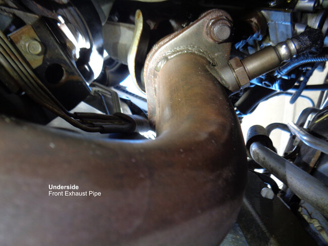

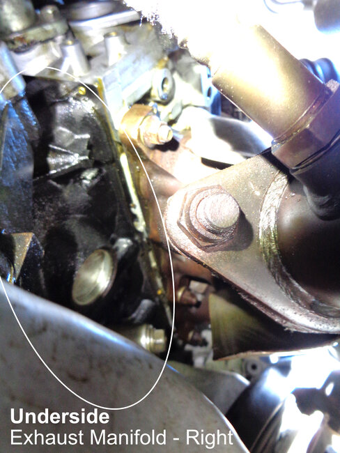

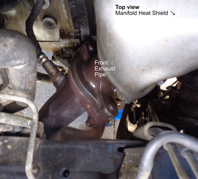

When I was bolting together the right, passenger side cata to the front exhaust pipe connected to the exhaust manifold it swayed and budged because I did not tighten the mid bolt hangar to the exhaust. I instantly regretted it and felt shocked that it did that.
So now even though the cata system is tight, the original error codes are back as I'm afraid I sheared or cracked the exhaust manifold or front pipe because now I hear a loud clicking near the valve cover.
I don't smell much if any exhaust but maybe. The Montero needs to be pumped with gas hard to start up now. Must I take down that side of the engine bay, heat shield, EGR, and inspect the manifold? Are there any ODB cues I should look for?

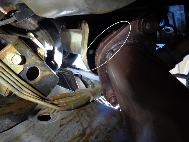

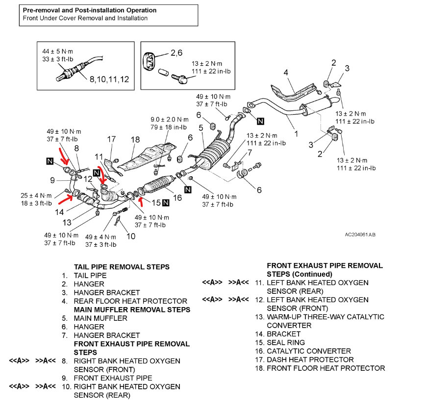

Nice work winning the Dakar! It sounds like the connection between the head pipe and exhaust manifold is the problem. There cannot be a leak there or the system will run rich. I would start with new gaskets and do an inspection of the system while it is apart to check for cracks or rust, like I say, there can be no leaks. It seems like you can do the work yourself so please use us to answer any question or guidance you need. Once we get the exhaust straightened out, we can deal with the other issues. The head pipe should not move once connected to the exhaust manifold so the hanger would have nothing to do with it so don't feel bad. Please upload images or a short video of any issues you may find. Please check out the images below where I have marked the gaskets and flange in question.

Nice response. Well, it would be good news that it would be only the front pipe gasket and not the exhaust manifold that "peeled away" from the engine block. As I just replaced the catalytic converter with all new seals and bolts and it's running silent with no exhaust smell, super tight install - it would be only the front exhaust pipe to manifold gasket I would be replacing.
I like things perfect and to only do a job once. Would it be advisable to install a brand new front exhaust pipe (9) that's between the manifold and converter along with commiserate gasket or is that overdoing it?

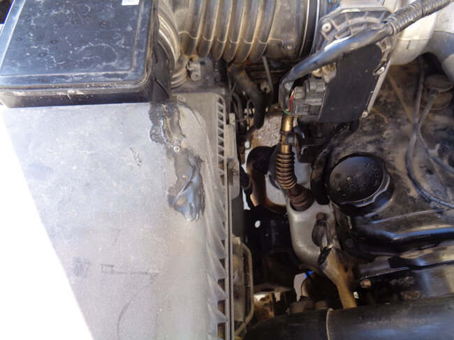

Also, I just noticed that the prior mechanic put a crack in my airbox and replaced premium MAF with Chinese single wire crap which also may account running too rich, but also Cylinder 5 misfire which is right in-line with MAF on right side? Could that also be the cause?
What ODB tests can I run to determine if the cylinder misfire is from the airbox leak, badly matched MAF rather than exhaust leaking?
I should hold off on visually inspecting the manifold and do the front pipe gasket first? It *is* heavily rusted. Can I use a valve clearance gauge set to see if there is a gap in the join between the exhaust manifold and front exhaust pipe to avoid taking it out or just do it? ;)

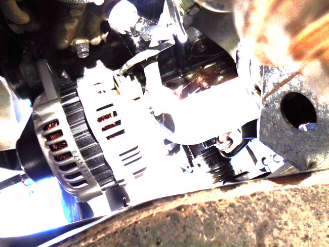

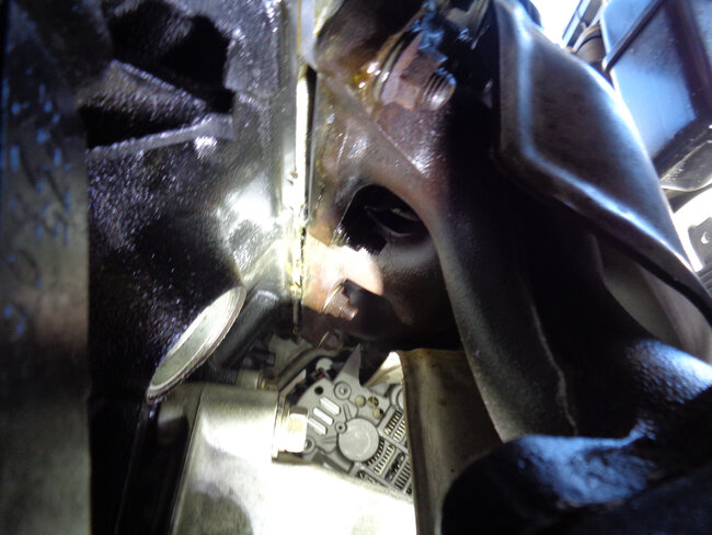

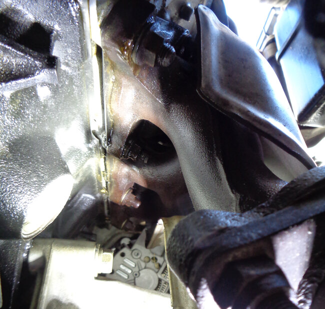

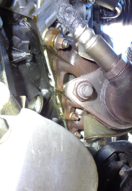

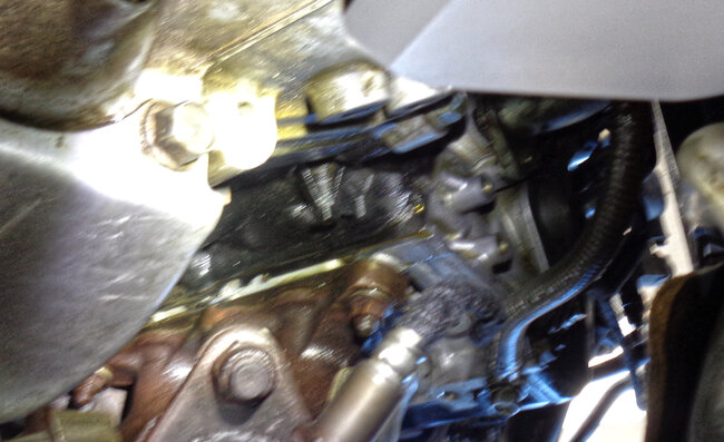

I'll add pictures after lunch.
Mar 19, 2025 at 11:43 AM
WRAVOC
  • 19 POSTS
First set.
Mar 19, 2025 at 2:30 PM
WRAVOC
  • 19 POSTS
Second set.
Mar 19, 2025 at 2:31 PM
WRAVOC
  • 19 POSTS
Better flashlight.
Mar 19, 2025 at 2:51 PM

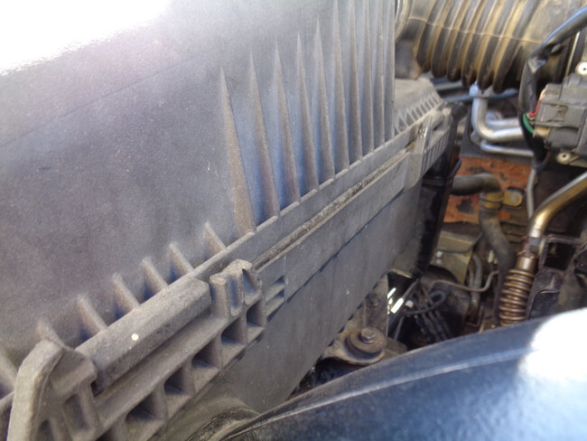

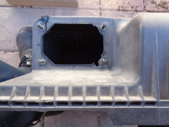

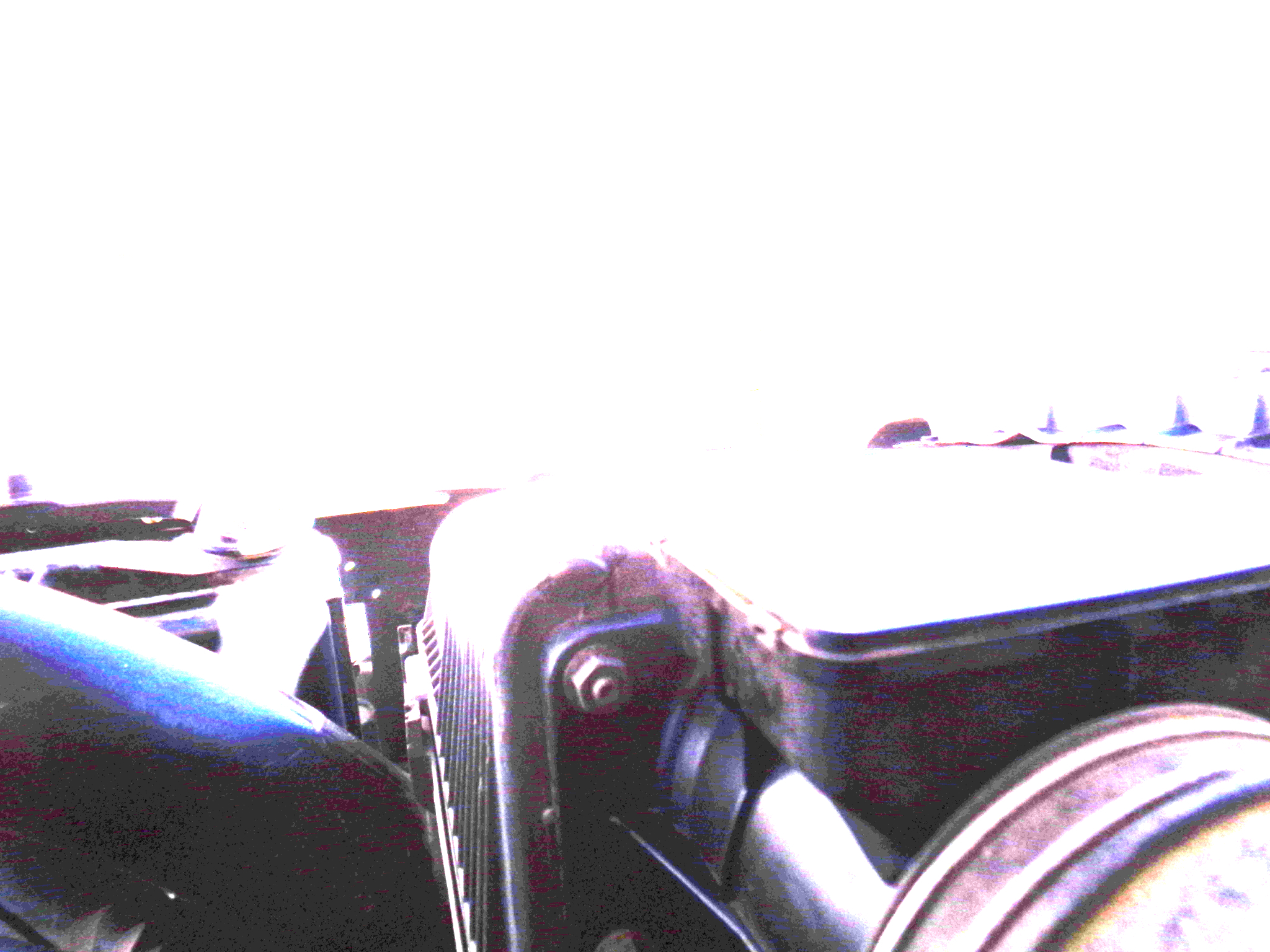

Wow, I just noticed that the last shop not only left a crack open in the putty sealing of the crack that they themselves made in the Airbox, the fasteners are totally broken. There is supposed to be a bar that goes across those broken plastic hold-down crowns.

Clarifying that I used "super-tight install" as a euphemism. Everything is torqued to spec at 33lbf except whatever the odd sets of bolts were, but that too. I have every possible manual for the Montero that exists.

Thanks for the images. the exhaust system looks okay, I don't think the damage to the air box will affect the way the engine is running. I think it would be best if we do a compression test for #5 to see if the engine is okay. Please go over this guide, also can you please upload a short video of the engine idling from under the hood?
If you have a scanner, you can read the fuel trims to see if the computer is giving fuel or trying to take it away. If the compression is good let me know the readings so we can go from there, also when the spark plug upload an image of it so I can see the color.

Okay, I'll send video and compression test results tomorrow, but this Airbox is more damaged than I thought. **All** tabs and skirts are missing, and the hole pictured bottom right extends past the MAF faceplate.

I'm going to plastic bond the airbox as best I can and test it like that tomorrow. I doubt the odb2 scans will come up right with a hole in it?

The damage to the air box should not trigger a check engine light. How does the engine seem to run? If okay, you might want to try just clearing the codes to see if it comes back.

The engine runs really rough with the Cylinder 5 misfire and of course has the clicking sound coming from the valve cover it seems. I glued the Airbox even more today because the MAF bolt housing is disintegrating, refusing to hold the MAF sensor closely.

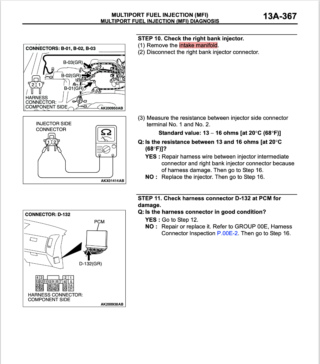

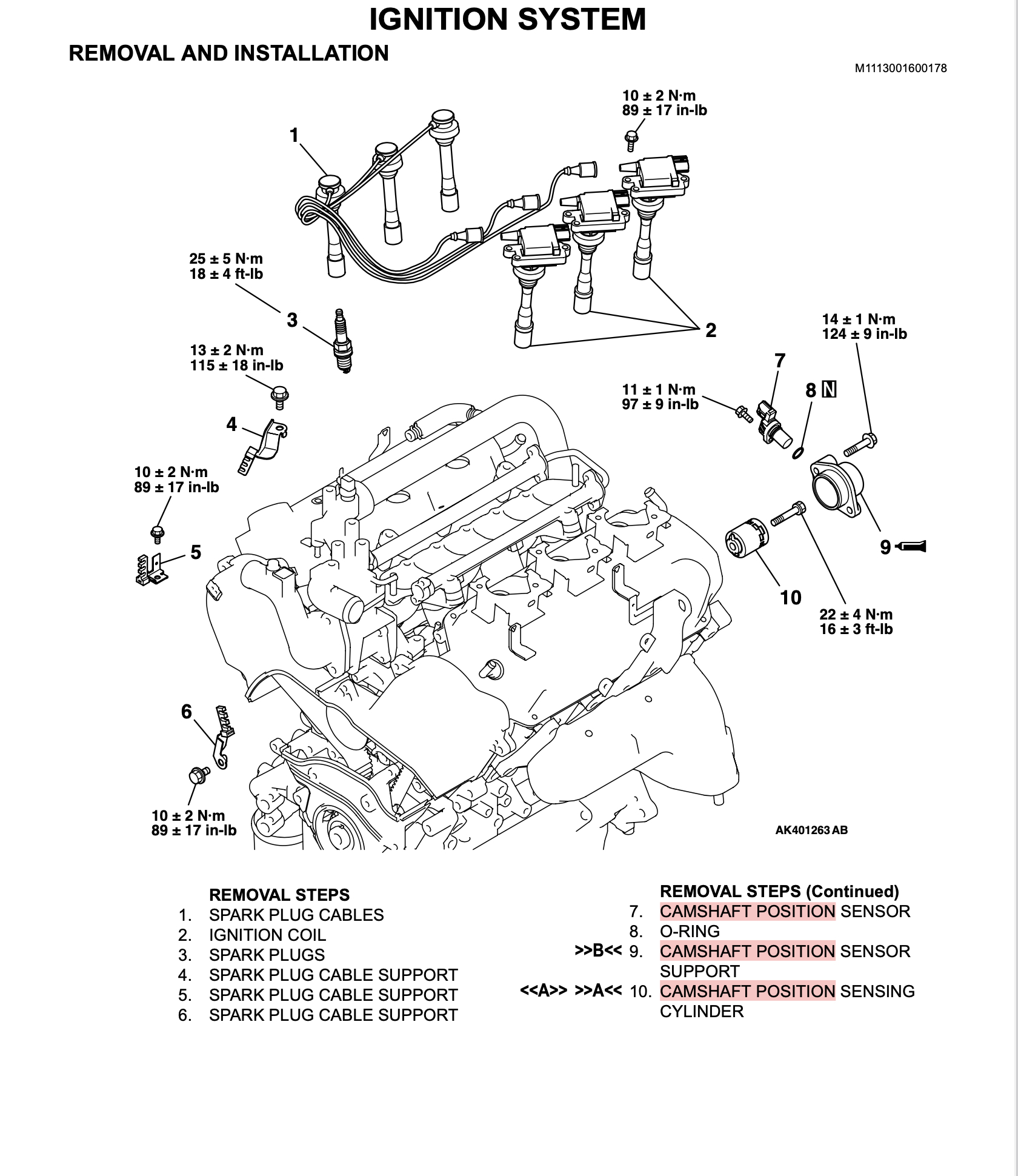

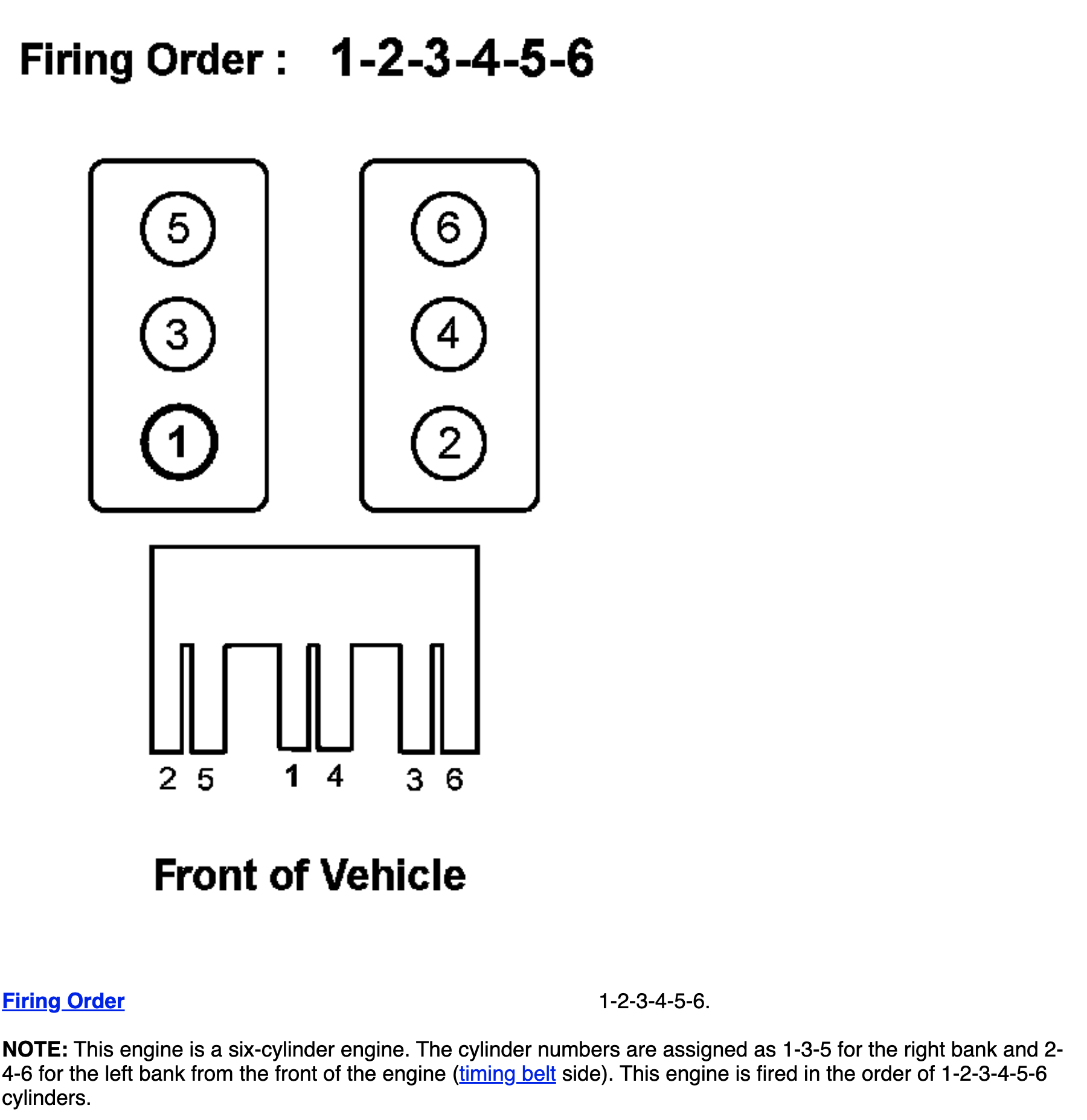

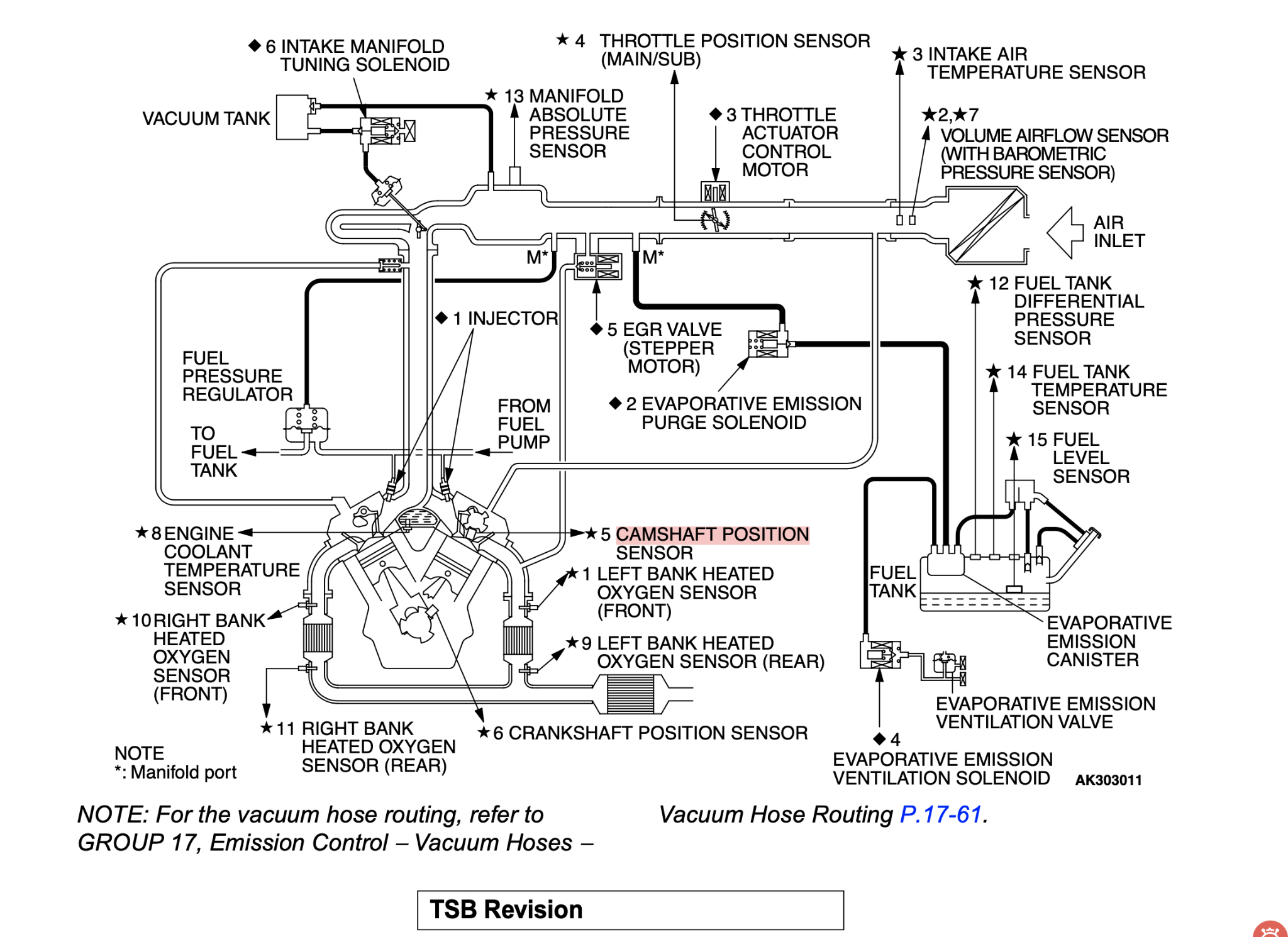

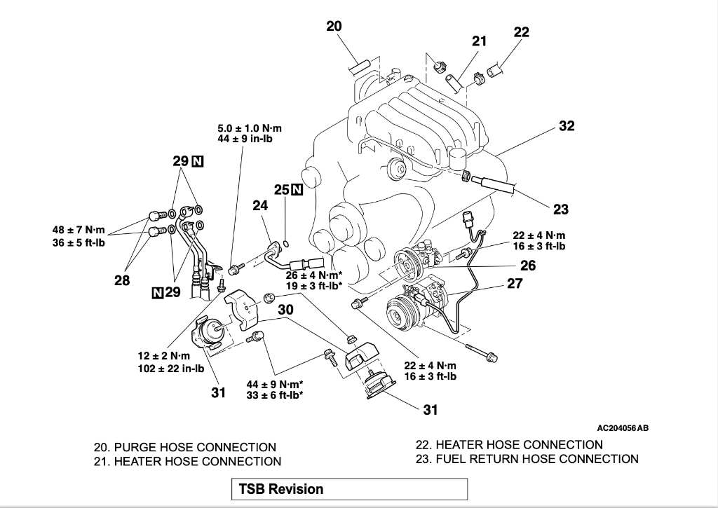

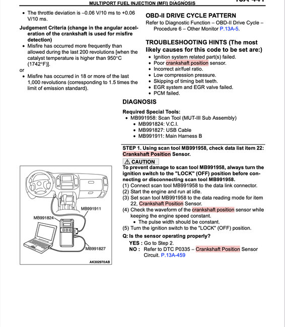

I assume so since the vehicle does run, but rough. Thing is when doing any of your suggested tests or fixes for the 2005 Mitsubishi Montero, you have the take the entire intake plenum and perhaps lower plenum off, it's a job.
So logically to compression test, I'd have to remove the intake manifold, remove the spark plugs, then reassemble the manifold, that's a lot of work. I think that if I'm in there that far I might as well check the lifters, valves, spark plugs, and cam.
A thing I can do easily is get the stethoscope on the Cylinder 5 Injector, I'll do that soon.
I'm not really too worried about compression because the lower block is actually a New "ES Engines" (Chatsworth CA, I think now defunct) Lower Block.

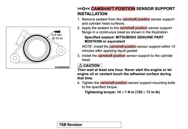

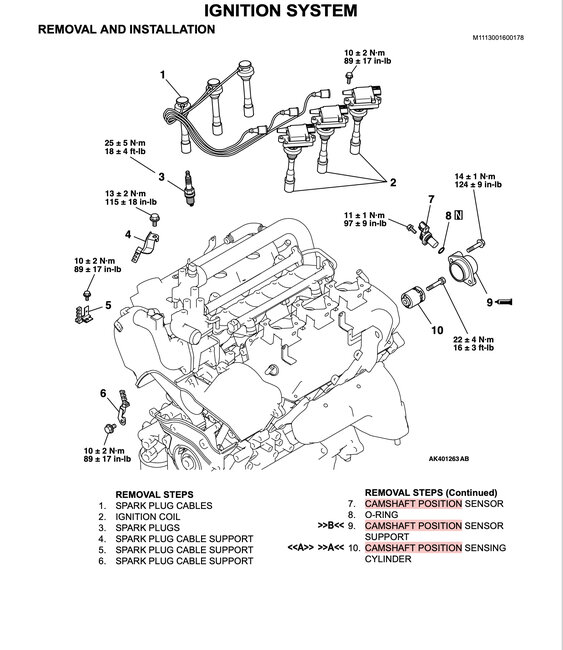

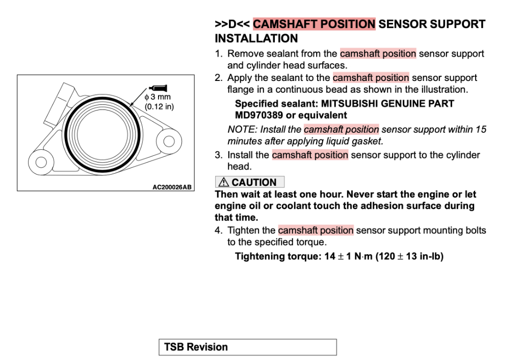

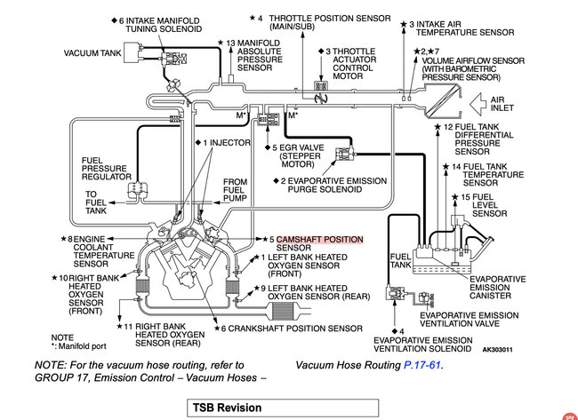

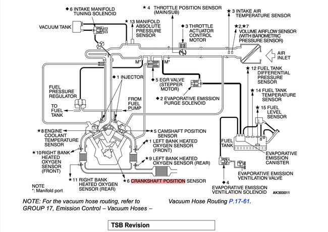

Screenshots are from the Mitsubishi Dealer Service Manual.

So help me out on the RPM sensor thing, that has got to be a big clue. It failed right after there was no leak in the catalytic converter y-pipe.
Is it the camshaft position sensor that does RPM? Cylinder 5 is right across from where that sensor is, toward the interior cabin, back of engine.
Mar 23, 2025 at 1:38 PM
WRAVOC
  • 19 POSTS
I just looked up Crankshaft Sensor. The last year it seems I've had every symptom of a bad crankshaft position sensor:
Misfire Cylinders 5 & 2
Hard Starting (just now after RPM gauge not working)
Stalls
Rough Idle
Poor MPG
Mar 23, 2025 at 2:20 PM
WRAVOC
  • 19 POSTS
The Airbox is fubar, so I ordered a new one and also crankshaft and camshaft sensors. I'm going to install all that, see how that affects the vehicle, then if necessary, take the manifold and valve covers down to inspect everything. I'll let you know with the video.
