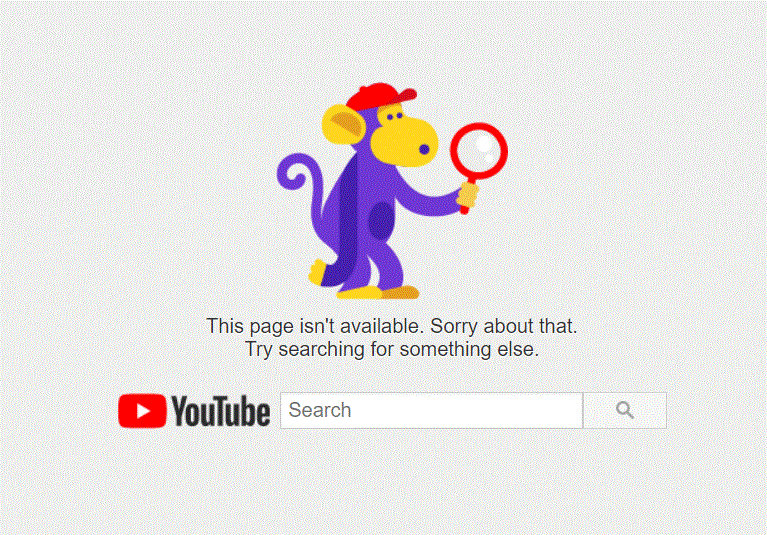

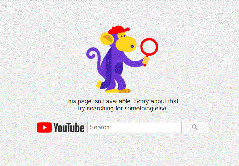

As far as the YouTube link, it wouldn't let me go to it. See pic 1 below for what I get.
Also, what am I listening to in the first video you made?
See pic below.

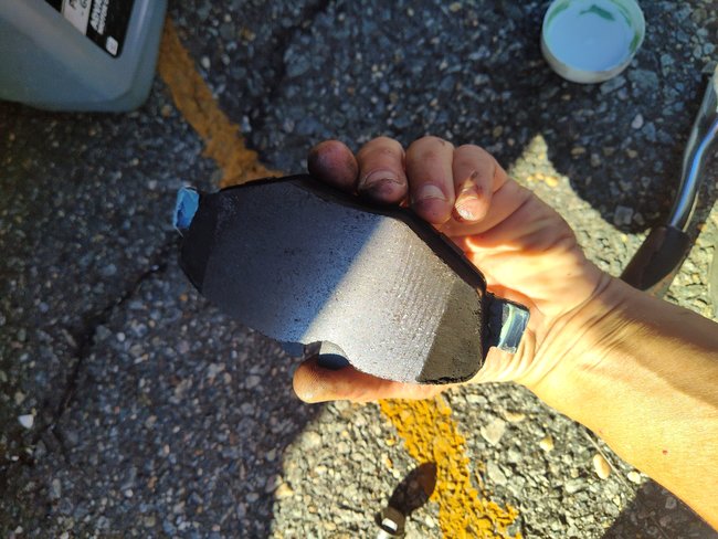

What causes that swirl pattern on brand new pads and rotors?
Tuesday, July 5th, 2022 AT 8:47 AM
  • 109,885 POSTS
That is either coming from the rotor or the new pad hasn't fully worn through the top layer.

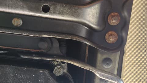

You want a good laugh. Bet you can't guess what caused it. It's my airmatic compressor. Yes the compressor mimic driveshaft and break vibration and noise. I decided to go back to when it started and it first started doing it after I installed the compressor. Since the bushings are worn and the mounts aren't holding it still it's vibrating. The relay is bad as well it's causing it to run when it shouldn't. I removed relay everything goes away and comes back when reinstalled. The only thing I can feel now is my lower driver side ball joint which I already know is bad and the carrier bearing which Im replacing anyways as it should be every 10 years. I still can not believe a compressor was able to mimic driveshaft and break vibration and noise.

I didn't include it in other messages. I got back from Mercedes about my brakes, and they are working just fine. The guy said since the car has semtronic brakes that's how they operate. Each wheel breaks independent of each other based on traction, road conditions, speed ECT. When in park the brakes will not function fully to prevent unnecessary pressure and heat. There is a lot more that is very technical but that is the very basics of it. They also confirmed that I was right, and the compressor is the cause of everything. They have never seen a broken bracket for compressor cause drive shaft and break like grinding, binding and vibration.

I hooked it back up and it starts doing it again. Mercedes confirmed it as well. Broken compressor bracket caused everything. All the noises, the shaking, the vibration, everything. Since it isn't properly bolted down it's vibrating through the frame. That's why it was so hard to pinpoint the noise and why it was felt in many locations. Also, why it was felt but not really heard. The location in my car muffled the sounds. It also explains why the car would vibrate and make noise at certain speeds. The car is constantly adjusting ride hide based on speed and conditions. I'm happy it's nothing major. I already ordered the new bracket, mount kit and relay. Should be here next week.

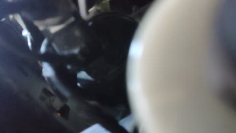

This is just for now as I replaced my valve block. No bracket yet. Still not here. When driving you cannot really hear it, but you feel it. You can understand how intense the vibration is. This is taken in wheel well just below compressor. The compressor isn't connected to anything the phone was mounted to but still vibrated.
Monday, July 11th, 2022 AT 7:20 PM
  • 109,885 POSTS
Wow! That would drive me crazy. I'm surprised you couldn't hear it. But I'm sure you felt it.
