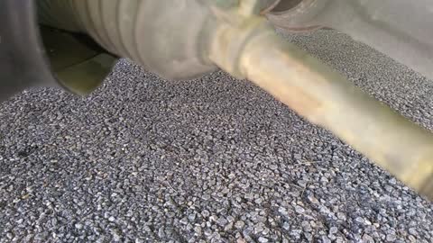

Jun 29, 2022 at 2:34 PM
I posted two videos, what do you think is causing it? It seems to be louder on the right side.
Jun 29, 2022 at 3:04 PM
I hear it. Is it only when you apply the brakes?

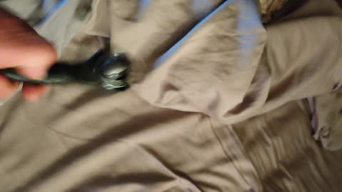

To rule out the drive shaft or bearing flex plate. I'm going to place my phone in the middle of the car around the transmission. If those noises are louder and more pronounced, it means something with the drive shaft is bad. It's just so freaking weird that all of this started when I replaced the compressor for airmatic. It's located behind fog light in wheel well. I had to reinstall the main hose as it blew off. Now it's worse after touching the compressor again. Nothing is rubbing that was my first thought. It's driving me nuts since everything happened after, but nothing is causing it.
Jun 29, 2022 at 8:47 PM
So, I put the phone about 6 to 8 inches from the center of drive shaft next to bearing. While the rumble/grinding barely happened. It did that binding scraping when coming to full stop slightly. While it barely happened, you cannot hear any of those noises from yesterday at all. So that rules out that part of the drive shaft. Now I have to find a way to get my phone to stay under or on side of transmission. If there is little to no noise that means the problem comes from the right wheel. As that was the loudest pronounced so far.

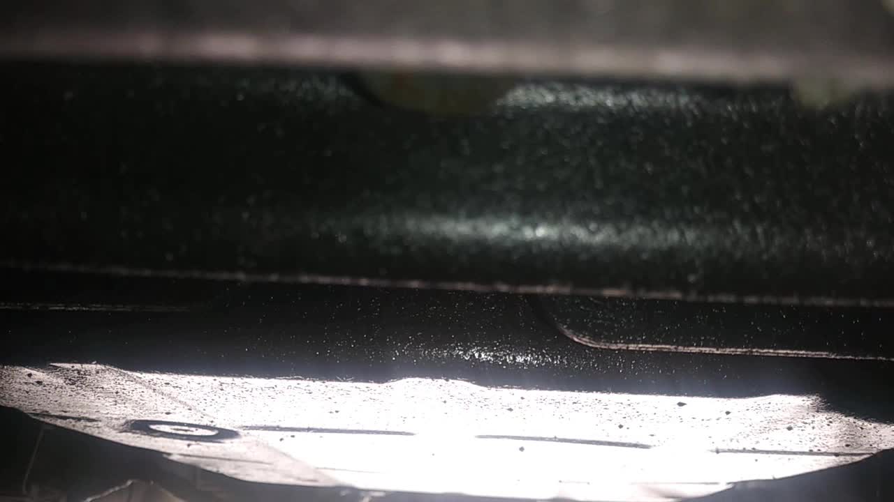

This video is under the bearing for drive shaft. I don't hear anything that screams bad shaft flex plate ECT unless I'm just missing it. Out of all the videos the right side seemed the loudest and worst by far. Both hubs are Brand New. They came with new races, bearings and seals already pressed and prepacked. Yesterday when I drove around and did heavy acceleration, I realized what it feels like.

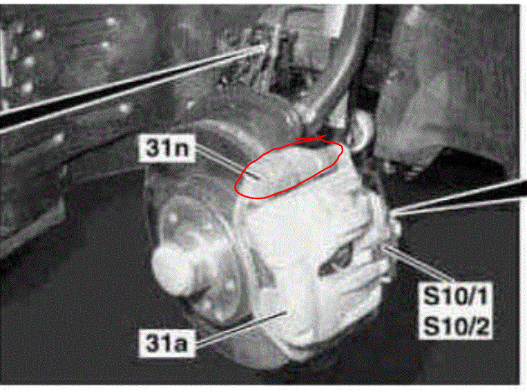

Have a helper hit the brakes and then release them to see if there is an excessive drag on the wheel. As far as it not properly released, is there any excessive heat from that wheel after driving?
As far as the ABS, if the brakes are not being applied, they really wouldn't change anything. However, here is a link you may find helpful. It explains how to test them:

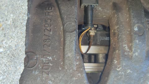

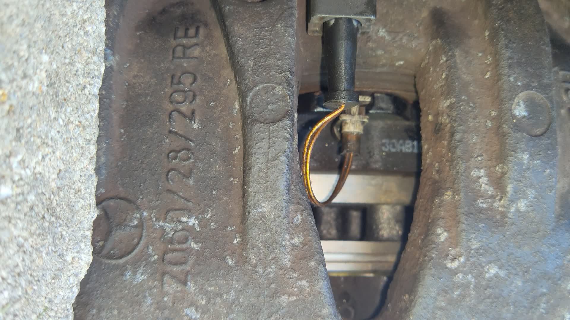

Wow, yes something is hanging up. Does it have caliper pistons on each side? If it does, replace the caliper. If it only has the piston on the inside of the caliper, the slides are not moving, or the brake pad is seized in the mount.
Let me know what you find or if I can help in any way,
Jul 3, 2022 at 12:53 PM
Single piston caliper. I went back and lubed everything still no difference.

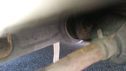

Car is in park. It should not be doing that. It's either the Carrier bearing, flex plates or u joint. Since it's coming from the middle, and I can push it up and down and it makes noise plus I can turn by hand, and it clunks I'm thinking Carrier bearing. But I also think the flex plates are worn as well

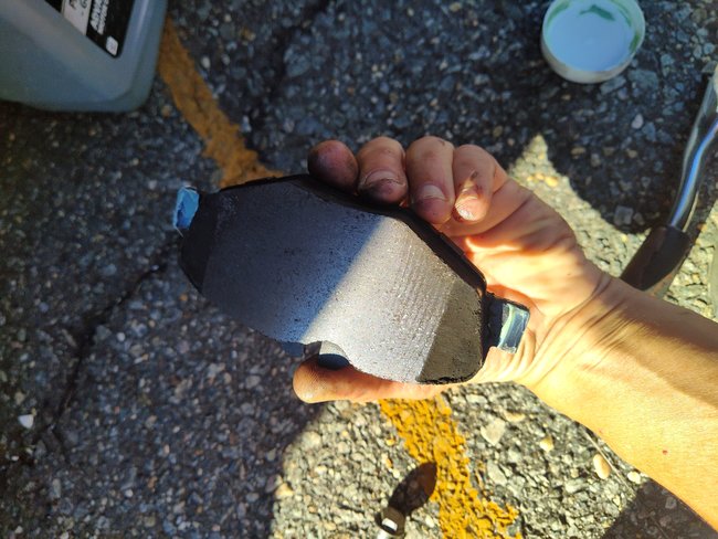

I was able to replicate the exact noise it makes when stopping. The noise is almost exactly similar when you let off brakes, just enough that pads are still making contact but not enough to hold the car. It's little hard to hear but if you listen to the background noise and not engine you definitely hear it. Mostly the last eight seconds. I have no clue what it can be. It's very possible it's a mix of everything, drive shaft ECT I'm just bringing it to shop. I don't want to keep throwing money at it.

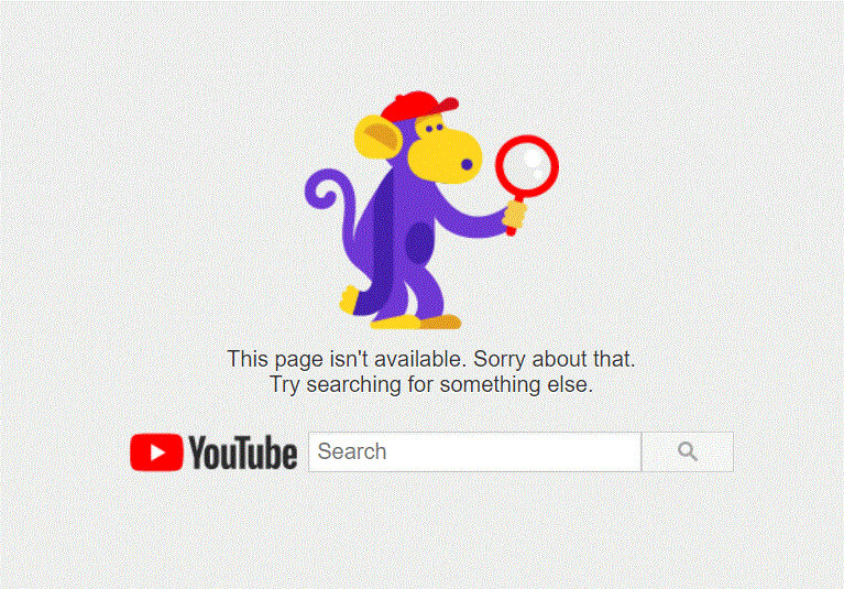

https://youtube.com/clip/UgkxgKCFTJ77PS23CrRVCkGkA7AEzVWPwZ20. This link will take you to a cut if a video of a bad center carrier bearing. It is making the exact noise my makes by hand. It makes sense now. When I would drive and hit a bump sometimes it would rumble and feel like a spun bearing but go away in a couple seconds and not come back for days or weeks.
Jul 4, 2022 at 6:46 AM
The brake pad is an issue. If the pad doesn't make contact, the pins are clean and lubricated, and where the pads mount to the carrier are clean and the pads move freely in them, replace the caliper.
As far as the YouTube link, it wouldn't let me go to it. See pic 1 below for what I get.
Also, what am I listening to in the first video you made?
See pic below.

The first video on this page is my driveshaft right at the center support bearing. The video on YouTube is someone with a very similar car who's bearing and rubber support is bad. It's the exact same noise and movement. Also, on Mercedes they use flex plates/ flex disc (5 different names used) at each end of drive shaft that connects to differential and transmission. They are a documented known failure point and consider a must replace every 10 year or less item. I'm not talking about the flex plate in transmission. I'm not sure if that's mixing anything up. Just letting you know to clarify. I'm not sure if that's causing all the issues. The support is definitely bad and has to be replaced anyway. Since the driveshaft has to come out you might as well do the flex plate also. As for the breaks everything is cleaned and lubed 5 times now. Nothing is sticking or binding. I'm waiting for the shop next to my house to open. I'm just going to drop it off to them and see what they say.

I am going to replace the right caliper as well. It definitely has something wrong with it. Also, I have noticed something but haven't thought about it much until now. My steering will pull randomly to one side then it will slowly correct itself. I didn't think about it until now since I knew my outer rods were shot. Since then, I replaced both and it still happens. Since the noise seems to be from the right of car I'll start there.
Jul 5, 2022 at 12:45 AM
That is either coming from the rotor or the new pad hasn't fully worn through the top layer.
Let me know how things are going for you.

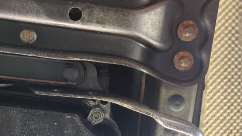

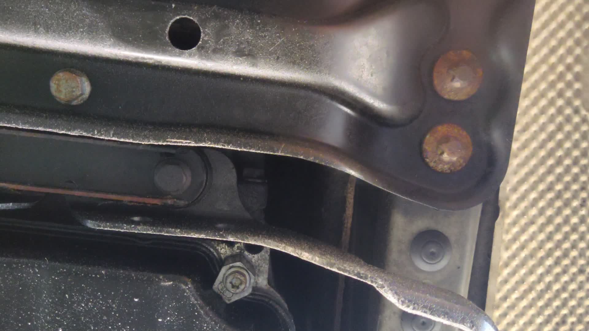

You want a good laugh. Bet you can't guess what caused it .... It's my airmatic compressor. Yes the compressor mimic driveshaft and break vibration and noise. I decided to go back to when it started and it first started doing it after I installed the compressor. Since the bushings are worn and the mounts aren't holding it still it's vibrating. The relay is bad as well it's causing it to run when it shouldn't. I removed relay everything goes away and comes back when reinstalled. The only thing I can feel now is my lower driver side ball joint which I already know is bad and the carrier bearing which Im replacing anyways as it should be every 10 years. I still can not believe a compressor was able to mimic driveshaft and break vibration and noise.

I've removed the relay for compressor 10 times and each time everything stops.
I hooked it back up and it starts doing it again. Mercedes confirmed it as well. Broken compressor bracket caused everything. All the noises, the shaking, the vibration, everything. Since it isn't properly bolted down it's vibrating through the frame. That's why it was so hard to pinpoint the noise and why it was felt in many locations. Also, why it was felt but not really heard. The location in my car muffled the sounds. It also explains why the car would vibrate and make noise at certain speeds. The car is constantly adjusting ride hide based on speed and conditions. I'm happy it's nothing major. I already ordered the new bracket, mount kit and relay. Should be here next week.

This is just for now as I replaced my valve block. No bracket yet. Still not here. When driving you cannot really hear it, but you feel it. You can understand how intense the vibration is. This is taken in wheel well just below compressor. the compressor isn't connected to anything the phone was mounted to but still vibrated.
