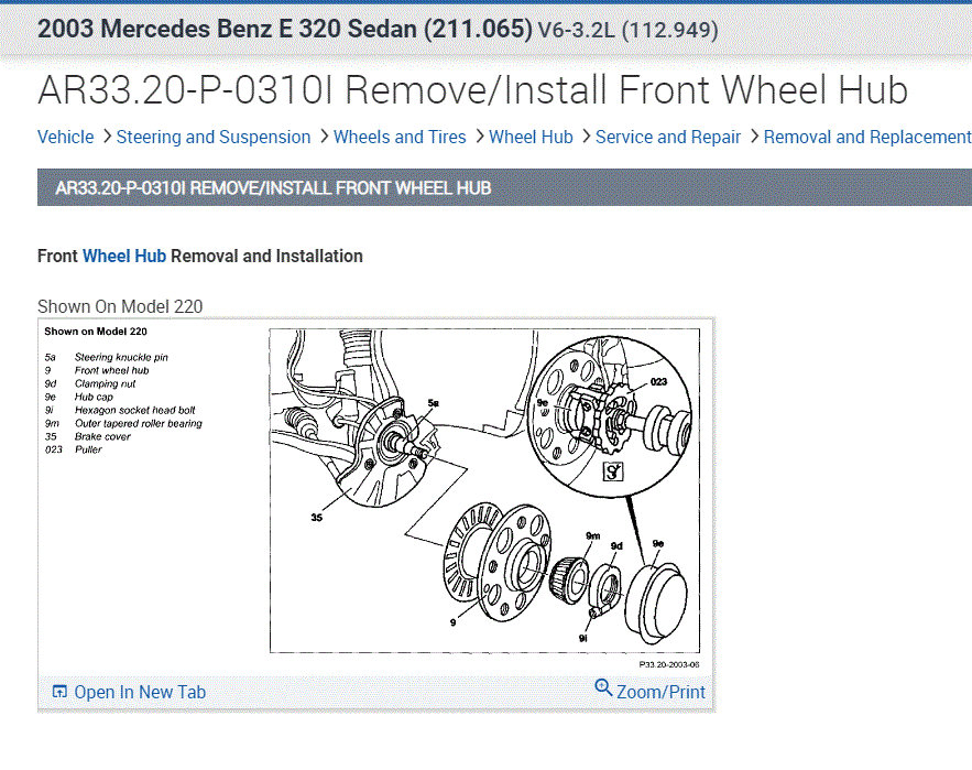

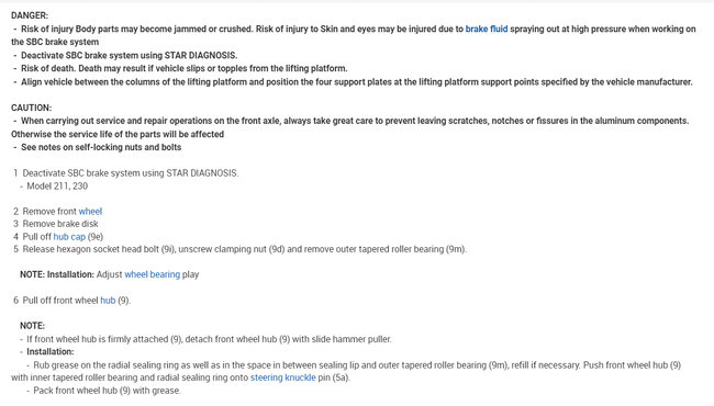

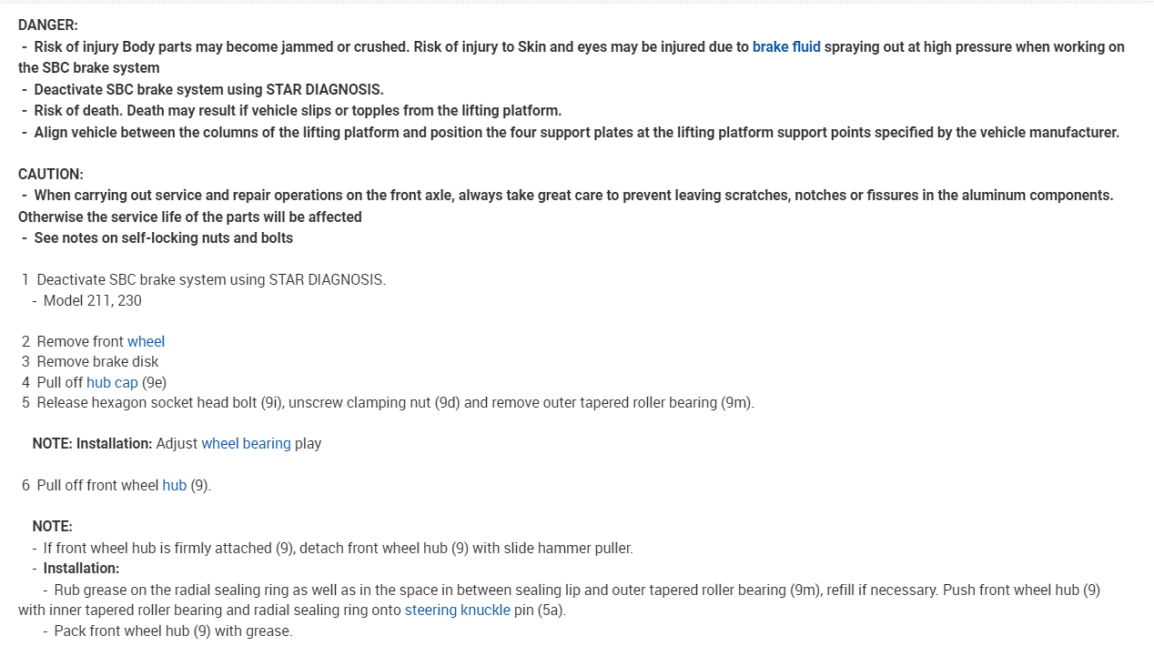

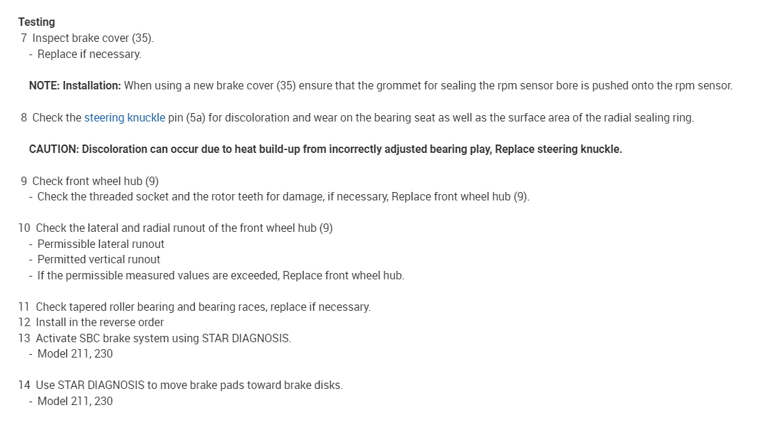

I attached the directions for the removal and replacement of the bearing below. Take a look through them and let me know if this helps and if you did the driver's side in this manner.

The photo is somewhat wrong. My hub has two bearings and plate, or shield is connected to the knuckle not hub. I just remembered something in the past I only had this rumble/slight grinding sensation come from front of car when hitting pothole or bump then it would go away. Sometimes it wouldn't happen for days or weeks. Over time I had a slight shake that developed and got slightly worse as time went on. It mostly happened at 60 to 65 and up. But nothing at lower speeds until a few days ago. I replaced my compressor on the left side of car for my Airmatic. I had the car jacked up for 4 hours since I had to run out. I'm thinking the pressure on the right side from being jacked up did something to an already failing bearing. I didn't have any of these current issues till that exact second. Yes, I checked everything over and nothing is rubbing, and everything is tight.

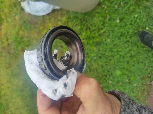

Here is one of the old inner bearings. There is definitely wear on inside and the grease is definitely not good.
Jun 16, 2022 at 12:27 AM
  • 110,251 POSTS
That doesn't look good. LOL As far as the future work you plan to do is concerned, let me know if there is anything I can do to help. Actually, I'm glad to hear you are replacing everything. The play that I saw in your video worried me. LOL

So, I need your help with the lock nut. I checked online and other sources of information and it's all conflicting. I don't have a tilt gauge to accurately tighten lock nut for wheel bearing. Some say to hand tighten and that's it. Other day hand tighten use wrench do a 1/4 turn and back off slightly. Some say to do a 1/2 turn and 1/4 back. What do you think I should do? I hand tighten and went around the block. I was going to turn it few mm more with wrench. What do you think my best bet is and which people you think are most accurate?

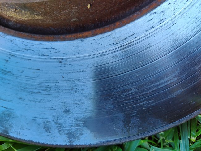

This is one reason why I decided to do the rotors and pads. Also, hubs are seized in rotors. My side pins were also dry and stuck like crazy. That explains the clunk and banging sound when letting off brakes.

When I do it, I snug it, spin the rotor, and re-snug it until it is somewhat tight. At that point, i spin it again and normally feel a bit of drag on the rotor. Then I back it off until the drag is basically gone. There really isn't a specific direction for how far to back it off. You want it to the point where there is no drag and no play between the bearing and hub.
The tightening multiple times is done to make sure it is fully seated.
Let me know if that helps. And certainly, the brake rotors look bad.

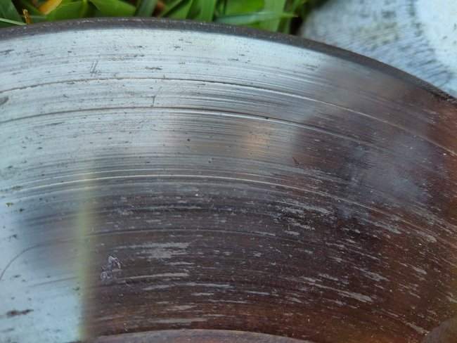

I haven't taken the car to shop yet. I'm convinced it's either my slide pins or calibers cause the problems. I was at a stop sign holding down brake pedal and when I lifted foot, it clucked. Then i lifted my foot, but this time I pressed the brake pedal down slightly and it clunked. When I first did brakes, I cleaned the slide pins and lubed them but three of them had issues after. One was stuck completely and two were sticking bad. Cleaned and lubed again but they still are sticking. I'm going to have to really clean the slot and pins, add a lot more lube. I'm really starting to think it's the cause since the issue is intermittent and car feel like it has drag.
Jun 23, 2022 at 6:46 AM
  • 110,251 POSTS
Absolutely, that sounds like the issue. If the brakes hang up, the rotors get really hot. Interestingly, the hotter they get causes the brake fluid to expand applying more pressure on the pads. That could be the cause of everything.

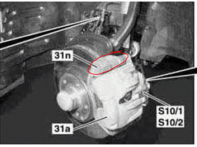

Do me a favor. When you have it apart, take a few pics of the slides and upload them for me to see. Also, when I do these, I take an ignition file (which is very fine) and file away dirt, rust, or whatever is on the parts. Try that. Keep in mind, if they are hanging up after you do this, I would replace them.
Also, the floating caliper support needs to be cleaned as well (pic 1). I use a small round file to clean debris out of them as well.
I hope this helps. Let me know if you have questions
See pic below.

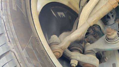

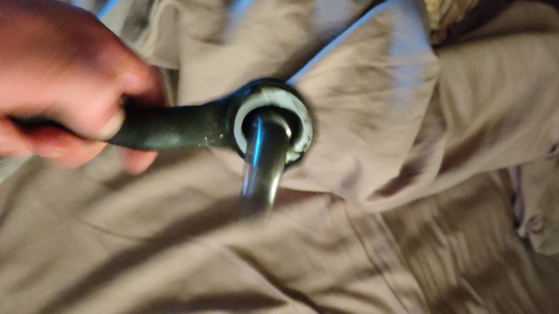

I did the outer tie rod today, It was really bad and most likely would of failed soon. It was really hot today and I forgot to take the photos of the slides and other components. Monday I'll try to do it.

Definitely not in good shape.
Jun 25, 2022 at 9:31 AM
  • 110,251 POSTS
Wow! That thing is done. I'm glad you found it. That could have caused an accident if it would have come apart.

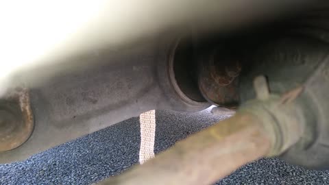

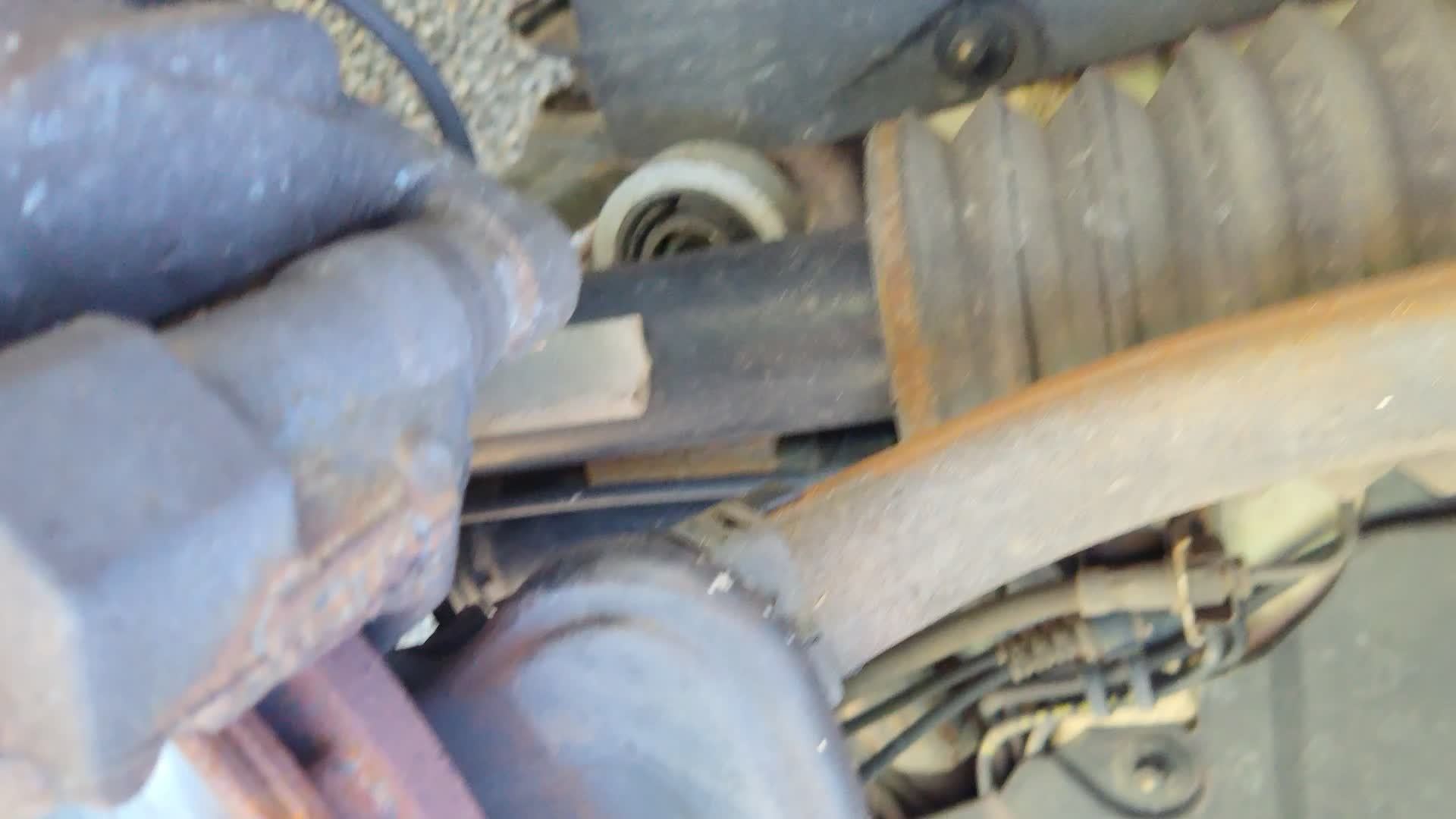

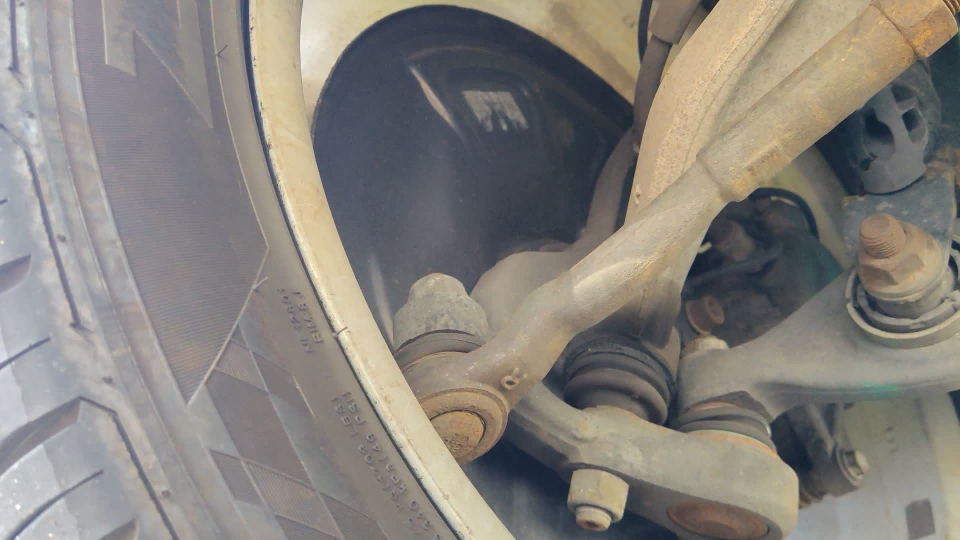

Both outer tie rods are done now. The inners on both sides aren't the greatest but they still have a little more life. When the car was jacked up, I noticed my left lower ball joint was bad and leaking. I already knew that was bad and needed replacement. Before I do that, I want to find out what's causing that grinding, skipping, and binding issue. I really wish I could give an exact explanation. I found an old cell phone, I'm going to zip, tie it to each wheel and record. Maybe I can find the issue or at least narrow it down to a location. I'll try to get the photos of slide pins later today.
Jun 26, 2022 at 10:39 PM
  • 110,251 POSTS
What an ingenious idea with the phone. If it's old, it won't matter if it gets damaged. I like how you think!!!

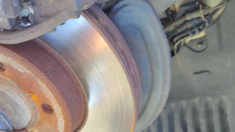

So, I pulled the slides, and the two bottoms were completely jammed I had to remove using a screwdriver and a lot of force. The rubber or ring on both expanded causing them to lock up. I did remove the o rings, lubed everything up and now the bottoms move freely. The tops aren't nearly as bad, but they aren't moving freely like they should. I cleaned, lubed and installed. I only took it around the block, and it does seem a lot better. It does still do it but it a lot better. I'm going to do the rears sometime this week and will remove the fronts again and add a little more lube. I used the cell phone trick a few times, it actually works. I was working on this older woman's car and she was told her transmission is bad. The car was shaking and when she would accurate the car would stop accelerating then reengage. It would also jump and make a very loud bang noise when it happened. I used my old phone to take video and audio and when I took on test drive, I was able to reproduce everything. I watched the video, and it wasn't the transmission it was the CV axles. When you give it gas both start to separate and spin freely in the boot. Let off gas they return to normal. She only had to buy two axles instead of a transmission.
Jun 28, 2022 at 2:04 AM
  • 110,251 POSTS
LOL, I love that idea. I suspect she was happy. LOL
As far as your vehicle is concerned, let me know what you find on the rear. Take a few pics of what you find. I'm interested in seeing what you're dealing with.

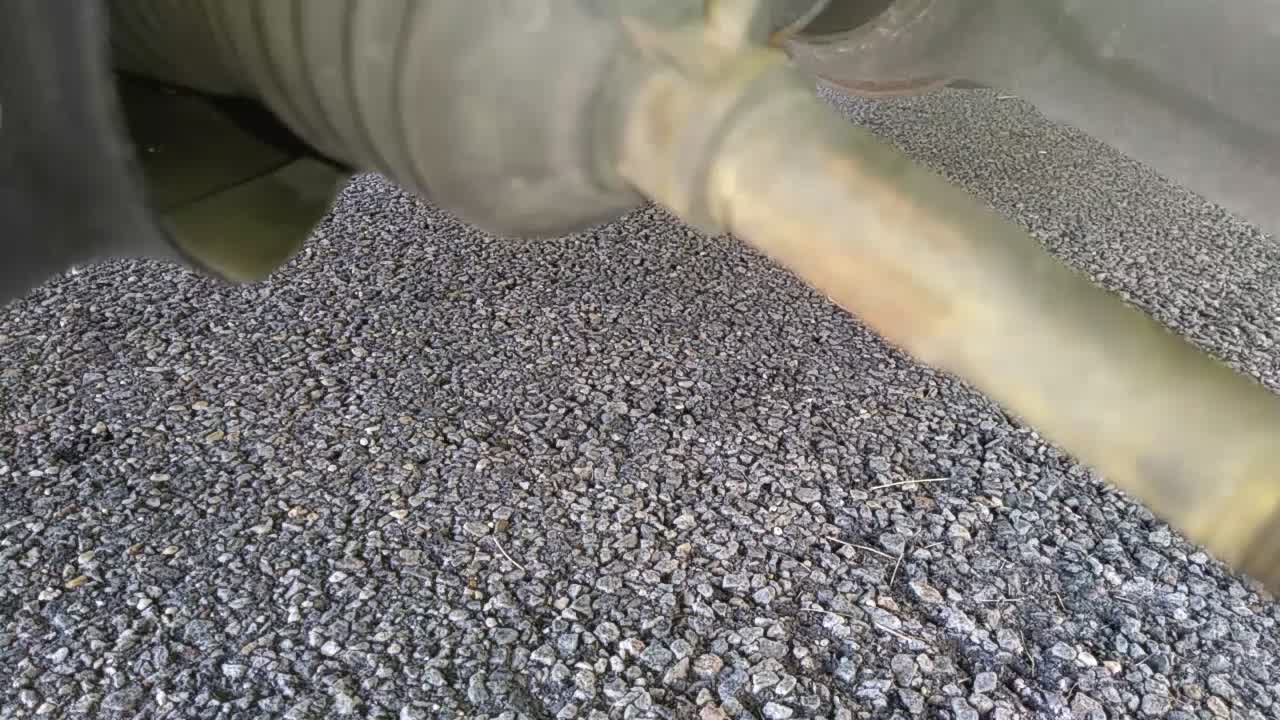

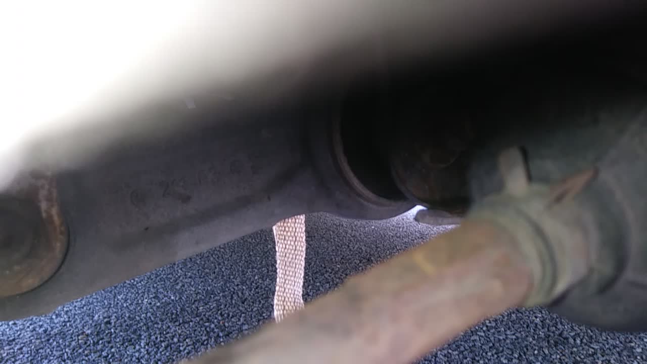

It started doing again a little worse than before. Tomorrow I'll take pictures of everything. Now it's starting to do something new. Right before you come to stop it makes grrrr and errr noise and you can feel it also.
Jun 28, 2022 at 11:03 AM
  • 110,251 POSTS
Is the sound coming from the front? Let me know. Also, pics and videos with audio would be great. I would like to hear what you are describing. Something isn't going together properly or needs to be replaced.
