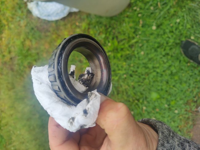

GENESIS88
  • 140 POSTS
Here is one of the old inner bearings. There is definitely wear on inside and the grease is definitely not good.
Jun 16, 2022 at 12:27 AM
  • 110,240 POSTS
That doesn't look good. LOL As far as the future work you plan to do is concerned, let me know if there is anything I can do to help. Actually, I'm glad to hear you are replacing everything. The play that I saw in your video worried me. LOL

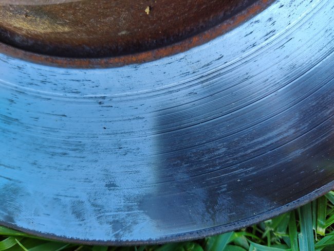

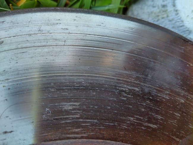

GENESIS88
  • 140 POSTS
This is one reason why I decided to do the rotors and pads. Also, hubs are seized in rotors. My side pins were also dry and stuck like crazy. That explains the clunk and banging sound when letting off brakes.
Jun 20, 2022 at 5:58 AM
  • 110,240 POSTS
When I do it, I snug it, spin the rotor, and re-snug it until it is somewhat tight. At that point, i spin it again and normally feel a bit of drag on the rotor. Then I back it off until the drag is basically gone. There really isn't a specific direction for how far to back it off. You want it to the point where there is no drag and no play between the bearing and hub.
The tightening multiple times is done to make sure it is fully seated.
Let me know if that helps. And certainly, the brake rotors look bad.
