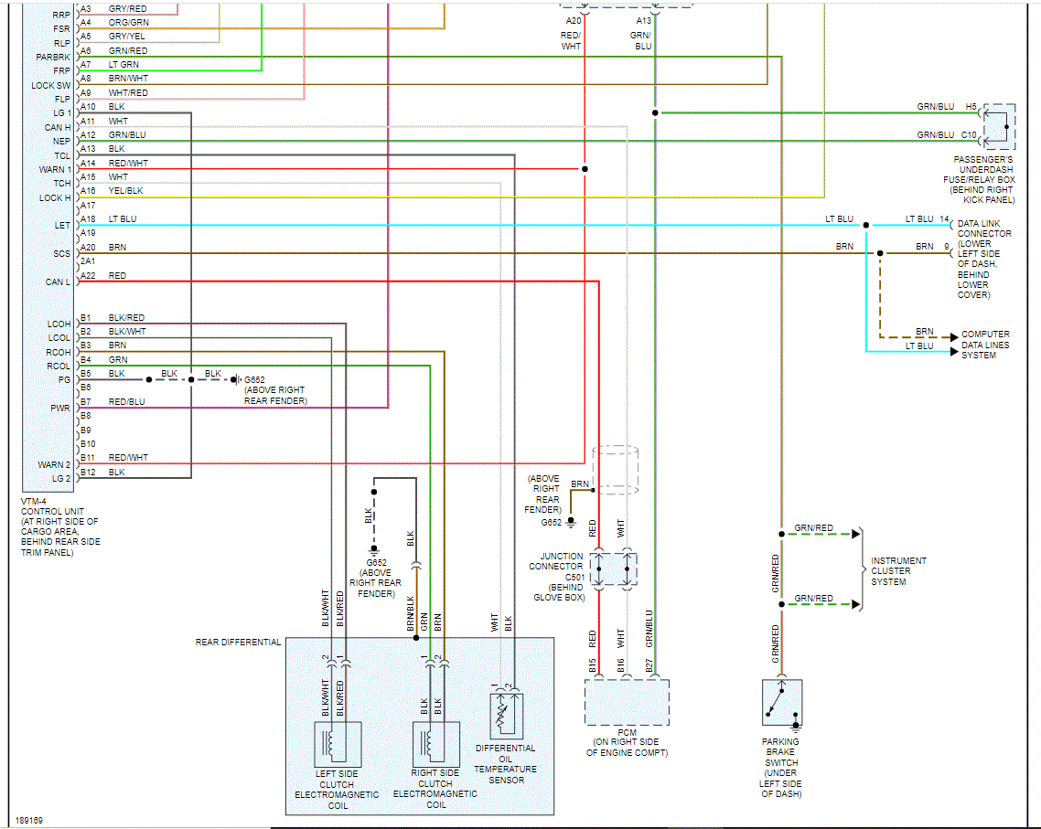

Vtm-4 lock not working
2004 ACURA MDX
134,000 MILES • 3.6L • V6 • 4WD • AUTOMATIC
EALVARADO5848
  • 7 POSTS
Vtm-4 lock button does not turn on , do i have to replace the transmission to fix?
Aug 22, 2021 at 10:28 PM
  • 110,244 POSTS
No, that could be a few different things. First, I would suggest having the can-bus scanned for codes. CAN stands for controller area network. Basically, all the modules/computers are tied together via a few wires. This will identify any code regardless of the module it's stored in.

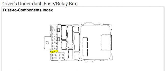

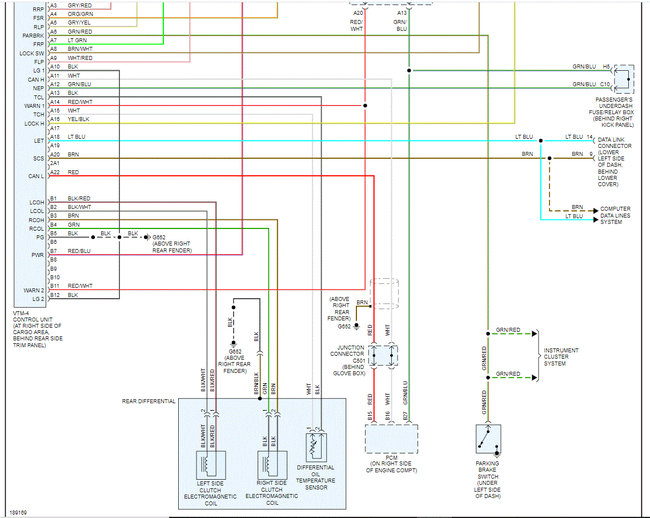

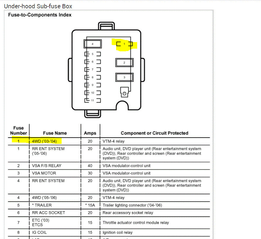

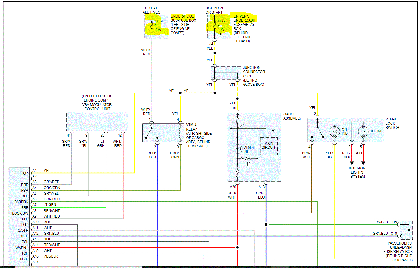

The first thing to check before scanning is the power supply to the circuit. If you look at pics 2 and 3 below, I included the wiring schematic for the system. I highlighted the two fuses needing to be checked. In addition to checking the fuse, make sure there is power to and from it. Here is a link you may find helpful:

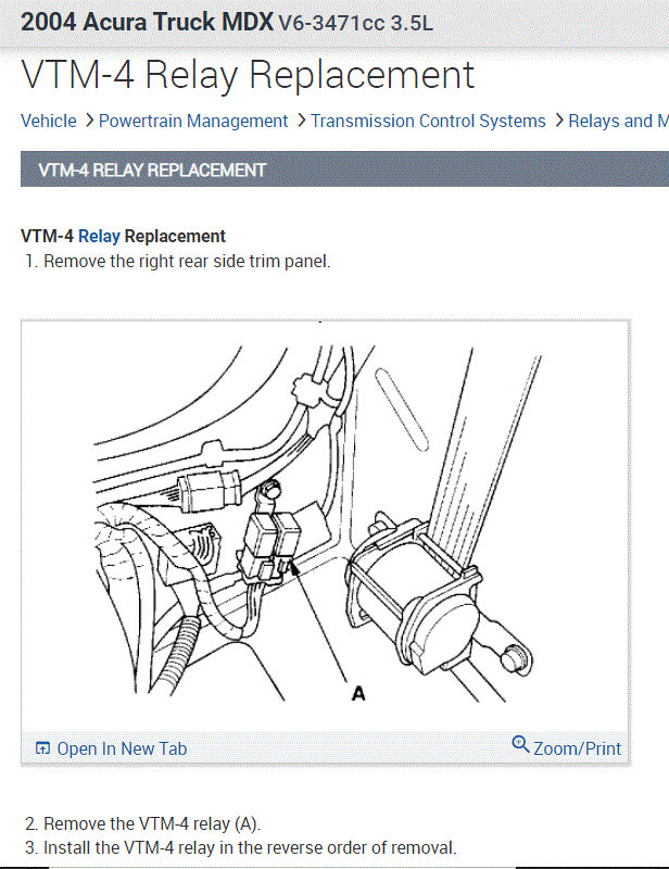

Next, there is a Vtm-4 relay we can check easily. If you look at pic 1 below, it provides the directions for replacing the relay. This shows how to access it. Once you get to it, here is a link that explains how to test a relay:
The last two pics show the fuses and locations to check. Note: one is under the hood and one under the dash.

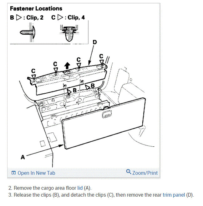

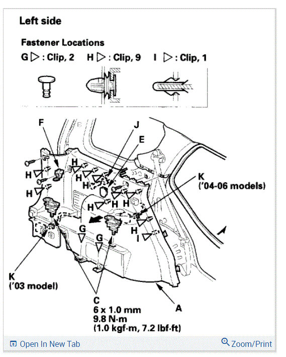

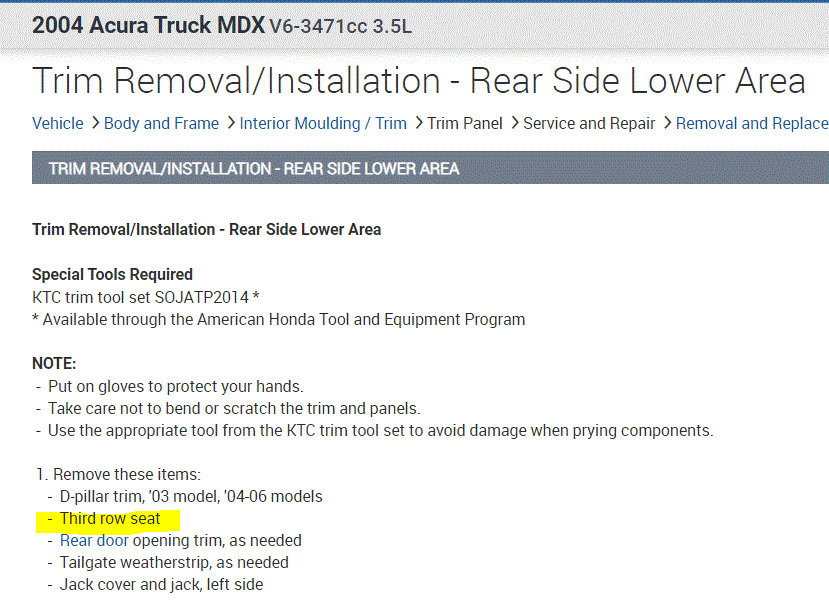

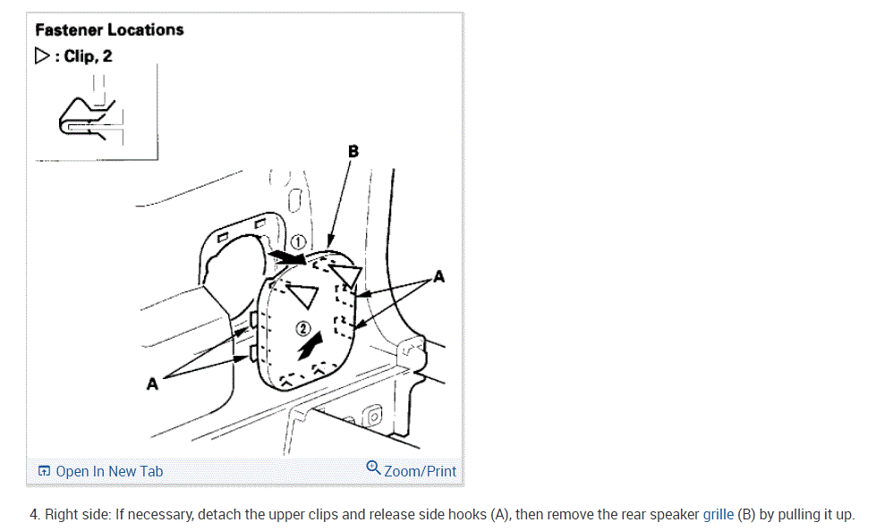

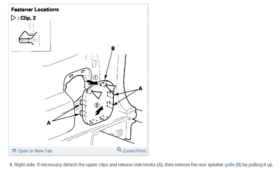

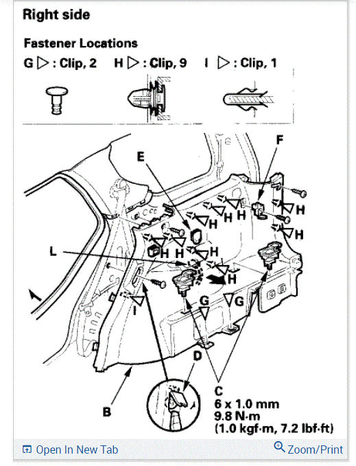

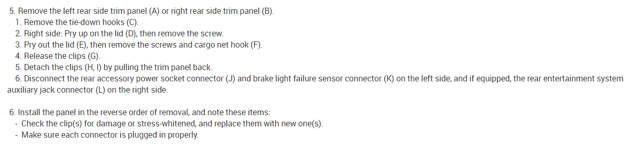

Yeah, thank you very much for the information about the scanner.. now I need help.. i supposed to check the vtm-4 lock relay.. have to remove a rear side panel which I took some screws out but I still can't get out the panel. do I have to remove the third row seat out in order to remove the panel? please advise. I tried to look on YouTube for certain videos on removing a panel there's nothing.
Aug 25, 2021 at 11:23 AM
  • 110,244 POSTS
The 3rd-row seat does need to be removed. I attached the directions below. Take a look through them and let me know if they help. Note: The directions are for both sides, so there will be steps you can skip.
Aug 25, 2021 at 11:48 AM

Thanks for all the help I really appreciate it. I have remove the rear panel and there was two relays they look in pretty bad shape so I replaced them with two new relays which is 1 for the vtm-4 lock and nothing.. still not turning on, the button. any suggestions?
Aug 27, 2021 at 2:35 AM
  • 110,244 POSTS
Hang in there. We'll get it figured out. When you checked the fuses I highlighted in the wiring schematic, were they good? Also, did you confirm there is power to and from them?
Here is a link that explains what to do:
Aug 27, 2021 at 1:45 PM
EALVARADO5848
  • 7 POSTS
Hi, and yes I already checked the fuse for both of them. I got power to them and the fuse are good relay is new. And I just noticed the cruise control doesn't work, so when I press the button it doesn't turn on. I don't know if that's tight together or not just to let you know.. I bought a scanner which the name of it is Bluedriver let me know your opinion about the scanner please. that would be a lot of help too? And i only got the code P0455 no other code came out.
