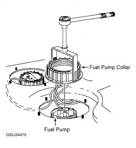

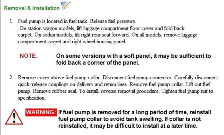

How do I remove fuel pump? and is there a scamatic for this?
Thank you!

https://images.2carpros.com/forum/automotive_pictures/261618_Noname_2386.jpg
https://images.2carpros.com/forum/automotive_pictures/261618_Graphic_585.jpg

Make sure you check your Fuel Pump Relay first! I thought my pump was bad as well because it wasn't pumping when I put the ignition in position 2 but then just to make sure I checked the relay and it was faulty. $50 versus $350
