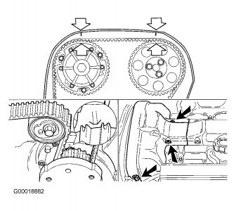

Bad or misaligned timing belt should check timing belt 1st
https://images.2carpros.com/forum/automotive_pictures/99387_1_53.jpg
Sep 12, 2019 at 7:01 AM (Merged)
COTTONEYEDJOE
Timing belt is new, i did the work.....oh no! I did look at it mark or left gear 12 o"clock, mark on right gear not quit at 12 0"clock but about 1/8" before 12.
Is there another mark on the crank? how do I see that?

COTTONEYEDJOE
Timing seams to be correct. I am in question about the belt tensioner, I'm wondering if this is correct. Could this have loosed?
JIS001
  • 3,412 POSTS
You will need to check your timing marks. The crank has 2 dimples one on each spline. On the oil pump there will be a mark as well loks like a groove sticking out. That groove needs to be in between the 2 marks on the crank. Then you will need to make sure the cam marks line up properly as well. If for some reason you removed the exhaust CVVT hub then you will need to get the special tool to lock the cam in place to reset the timing.
