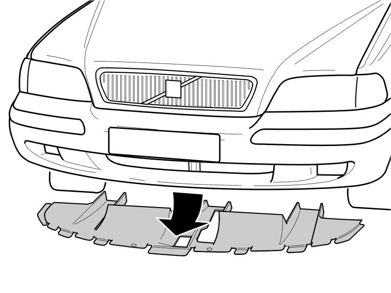

Remove the air baffle.

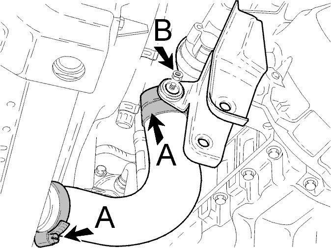

Removing the hose and pipe for the charge air cooler (CAC)
pic 2
Remove the hose clamps (A).
Remove:
- the nut (B)
- the hose.

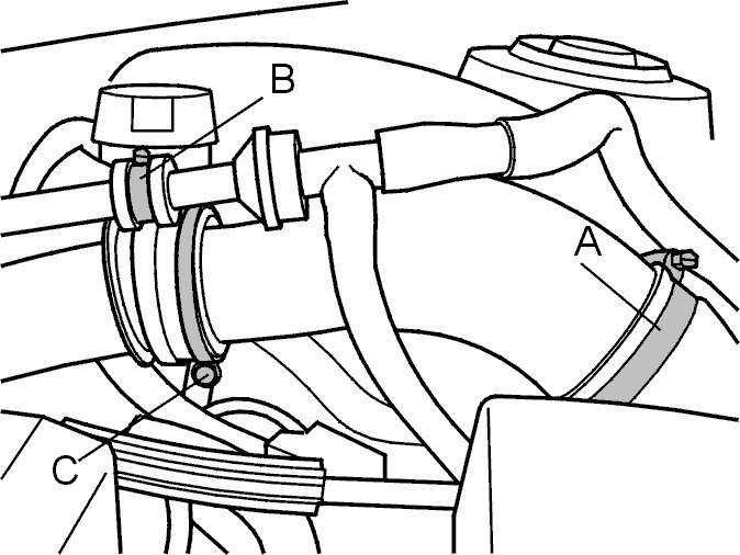

Remove the hose clamp (A).
Remove:
- the vacuum hose (B)
- the mounting for the charge air cooler pipe (C)
- the charge air cooler pipe.

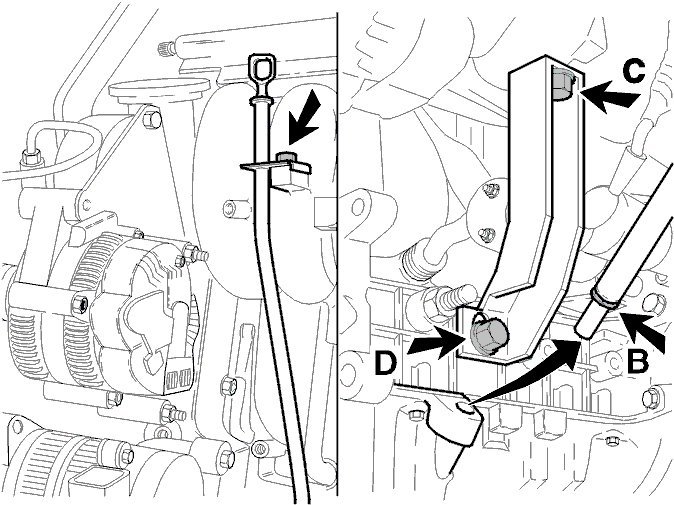

Removing the pipe for the dip stick
pic 4
Remove:
- the pipe for the dip stick and the O-ring (B).
Note! Clean thoroughly and plug the hole.
- the two screws (C) and (D), the bracket for the manifold.

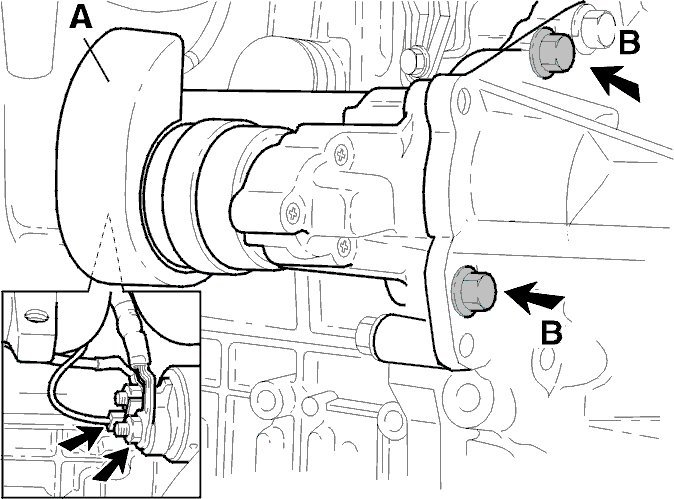

Removing the starter motor
pic 5
Remove:
- the splash guard (A)
- the power cable and the connector from the starter motor
- the two screws (B)
- the starter motor.
Installing the starter motor
Clean the mating surfaces.
pic 6
Install:
- the starter motor using the two screws. Tighten the screws (B) by hand. Tighten to 50 Nm
- the connector and the power cable for the starter motor. Tighten the screw for the power cable. Tighten to 13 Nm
- the splash guard (A).

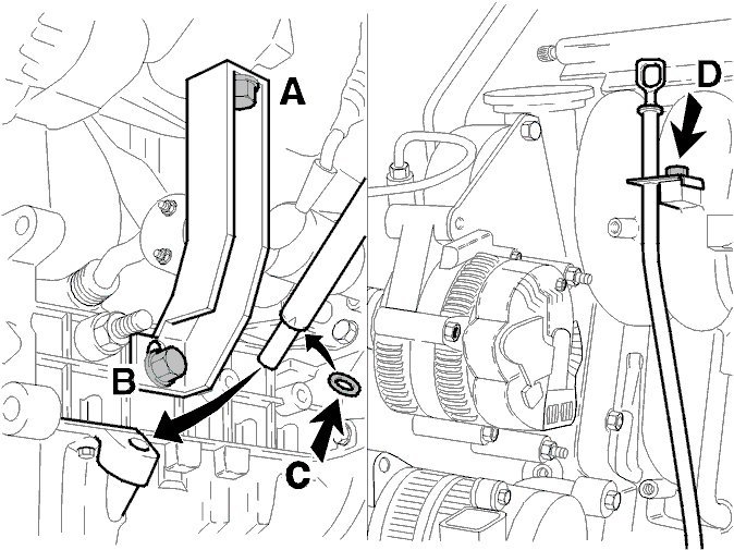

Installing the pipe for the dip stick
pic 7
Install:
- the bracket for the manifold using two screws. First install screw (A) and then (B). Tighten to 25 Nm
- a new O-ring (C) on the pipe for the dip stick, first remove the plug
- the pipe
- Tighten the screw (D). Tighten to 10 Nm.

- the air baffle
