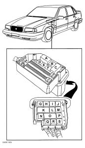

need to know about the fuel pump on a 1995 850 turbo volvo , it is not getting any gas to it . someone told me about this site and said i could trust the response ..since money is so scarce these days I need to have a little knowledge before taking it to the auto shop.

if you pop your gas cap off have a friend turn your key so your dash lights come on you should put your ear up to the fuel filler (where you took the fuel cap off) as your friend turns the key you should hear a light buzzing noise for a couple seconds, if you do that indicates the pump is working it might not be pumping the way it should but you know it is, if you hear no noise at all that means the pump is not working, there is a fuse and a relay for the pump, either way I would check the fuse and relay first before putting the car in the shop

https://images.2carpros.com/forum/automotive_pictures/192750_Relay95Volvo850Turbo_1.jpg
B = Fuel pump relay. #2 fuse (15A) in lower centre of dash is for the fuel pump.
