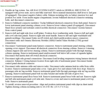

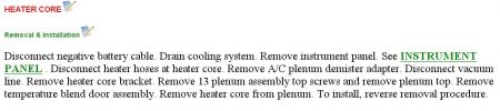

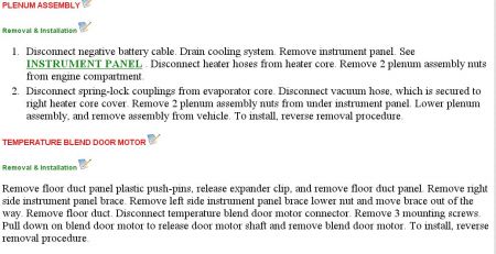

This is a 7.0 hour job for a pro book time. I have no diagrams unfortunately.
