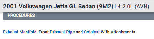

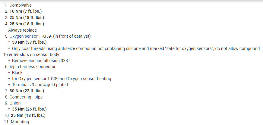

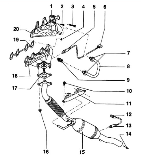

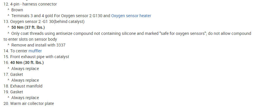

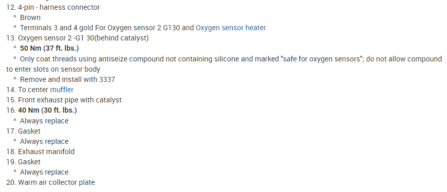

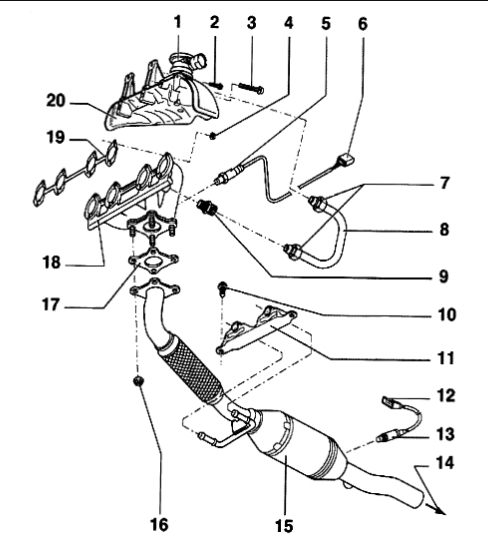

Here is the information you requested. Here are a few tutorials for you to view on testing and replacement of catalytic converters:
https://www.2carpros.com/articles/catalytic-converter-replacement
I've attached picture steps below on how to replace the catalytic converter on your Jetta. Hope this helps and thanks for using 2CarPros.
