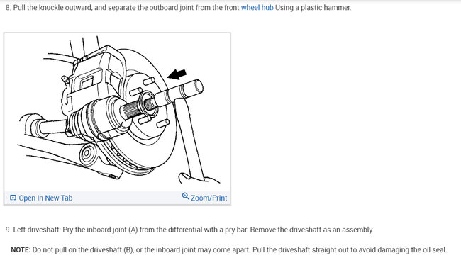

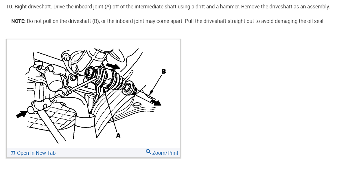

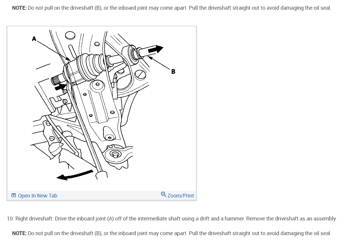

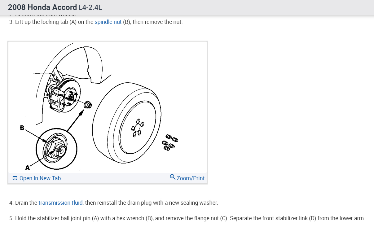

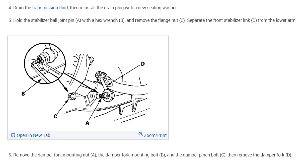

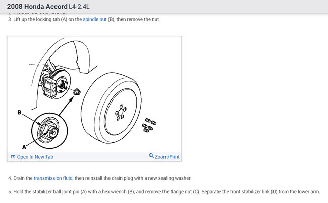

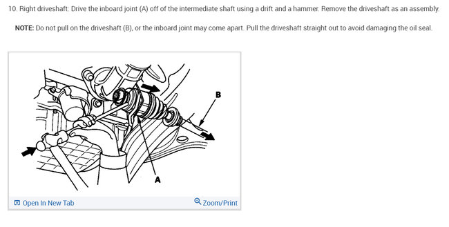

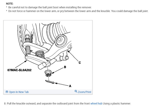

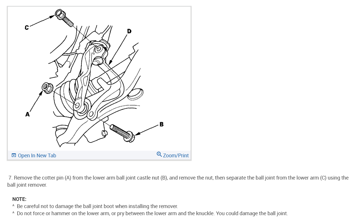

Yes, I would check both again because there are all kinds of different qualities of CV axles. Here is a guide to help you replace the axles with diagrams below to show you how on your car:
Video
https://youtu.be/9OYxj9y3Zjc
and
https://www.2carpros.com/articles/replace-cv-axle
Jan 3, 2020 at 6:55 AM
ELLERBE1
Thanks for all your help Ken. It was the driver side CV axle. Had it replaced no vibration during acceleration.
