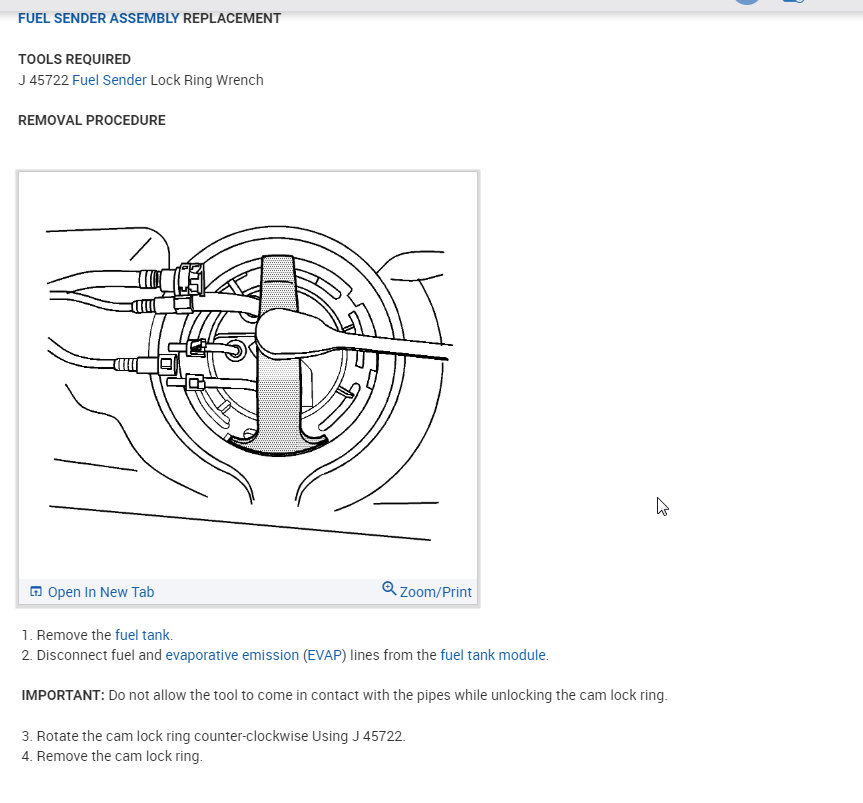

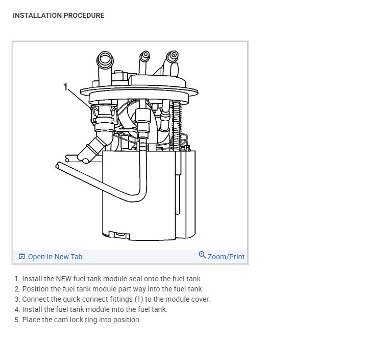

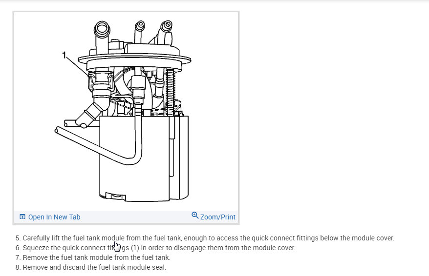

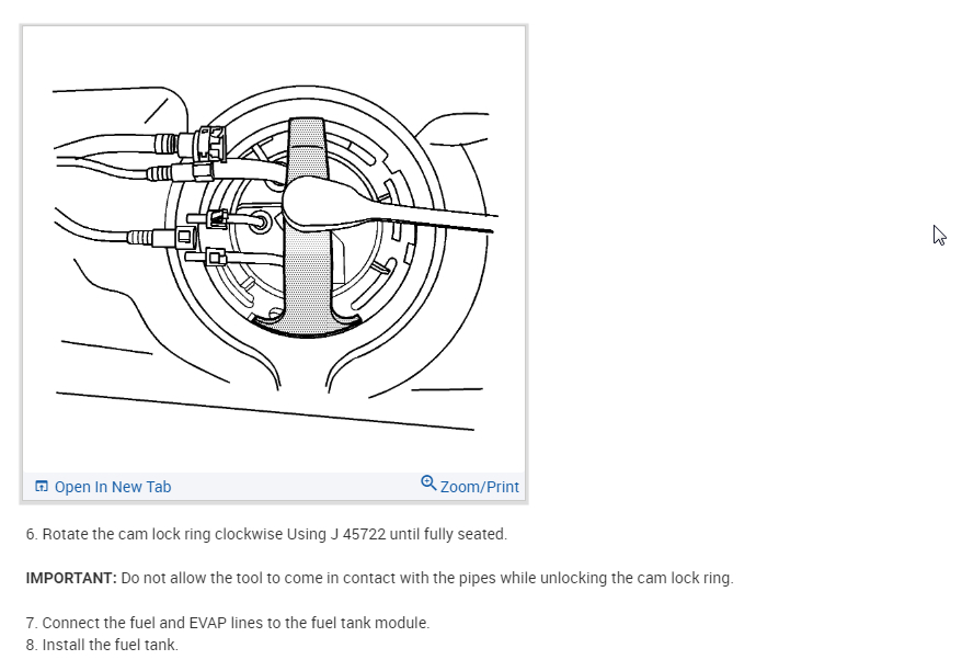

What is the fuel pressure when you turn the key on without cranking the engine? Have you replaced the pump or made any repairs? Here is a guide to help you step by step with instructions in the diagrams below to show you how on your car.

Pulled pump and sat it in a bowl of fuel and it sprayed like 3 feet. so i sprayed any dirt in it out and put it back in and it takes 3 cycles turning key off and on before fuel reaches the quick disconnect before rail and injectors. if it sits for even 5 minutes takes another 3 cycles off and on to get fuel to even drizzle out. hooked everything up did a pressure test the needle moves maybe a cm. i was thinking pressure regulator but i can't find one anywhere to even try testing that.
Dec 9, 2019 at 3:15 PM

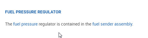

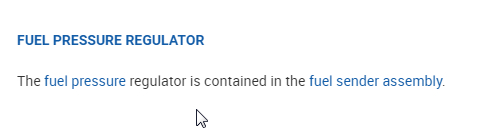

Yep. Your pump is not supplying enough pressure. The regulator is part of the sender/pump and is not serviced separate.

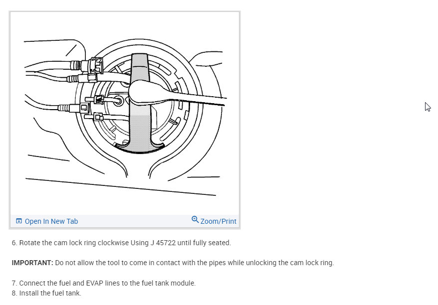

ROBERT LEE4
  • 8 POSTS
Yea i found a temporary solution, lol. i took a pump motor out of an older Tahoe and junked all but the pieces that hold the pump filter etc., and put the new pump into my casing and back into the tank and it runs good, but if i let off the throttle to suddenly after high speed it just shuts off, but starts immediately again.
Dec 10, 2019 at 10:25 AM
ROBERT LEE4
  • 8 POSTS
Also, i wasn't about to wrestle the tank out again. so my solution was a custom access straight to the pump through the floorboard.

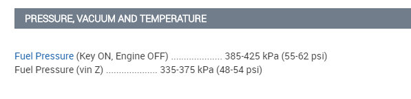

What is the proper fuel pressure for a 2003 Tahoe
Jun 2, 2021 at 7:44 AM (Merged)
  • 75,992 POSTS
55-62 psi - Here is a guide to help you get the fuel pressure reading.

Key On Engine Off .................... 60-66 psi

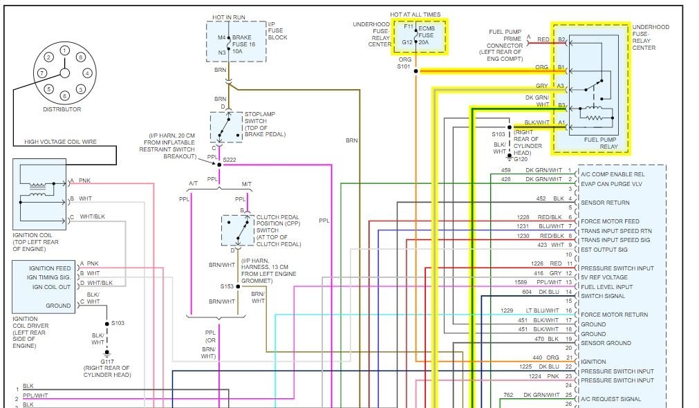

HARRY P
  • 2,292 POSTS

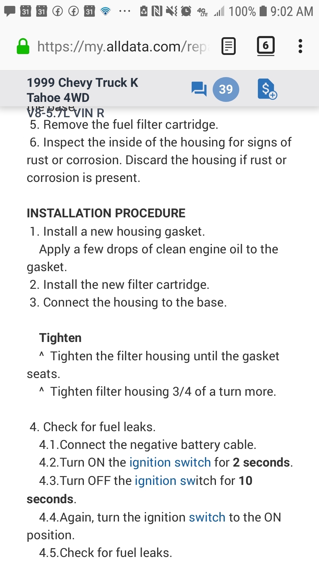

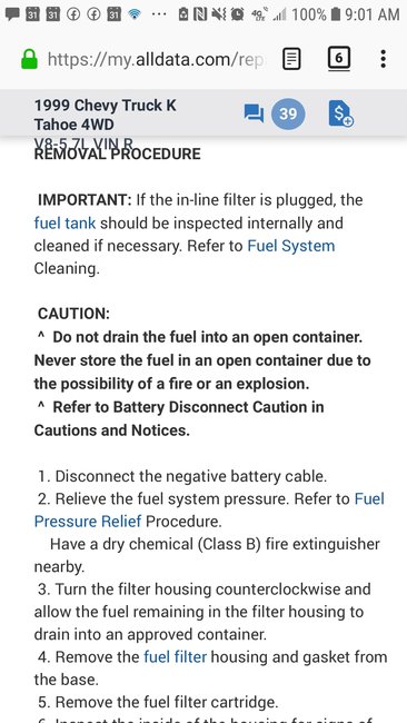

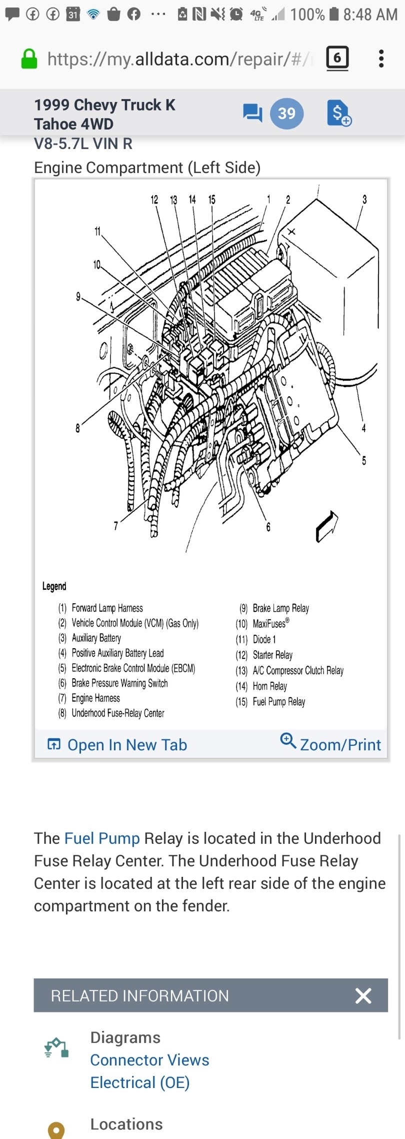

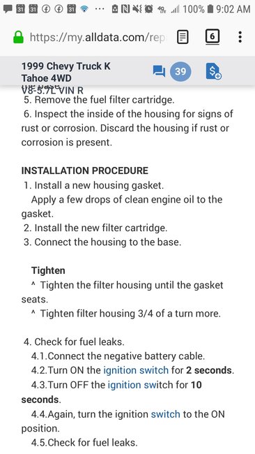

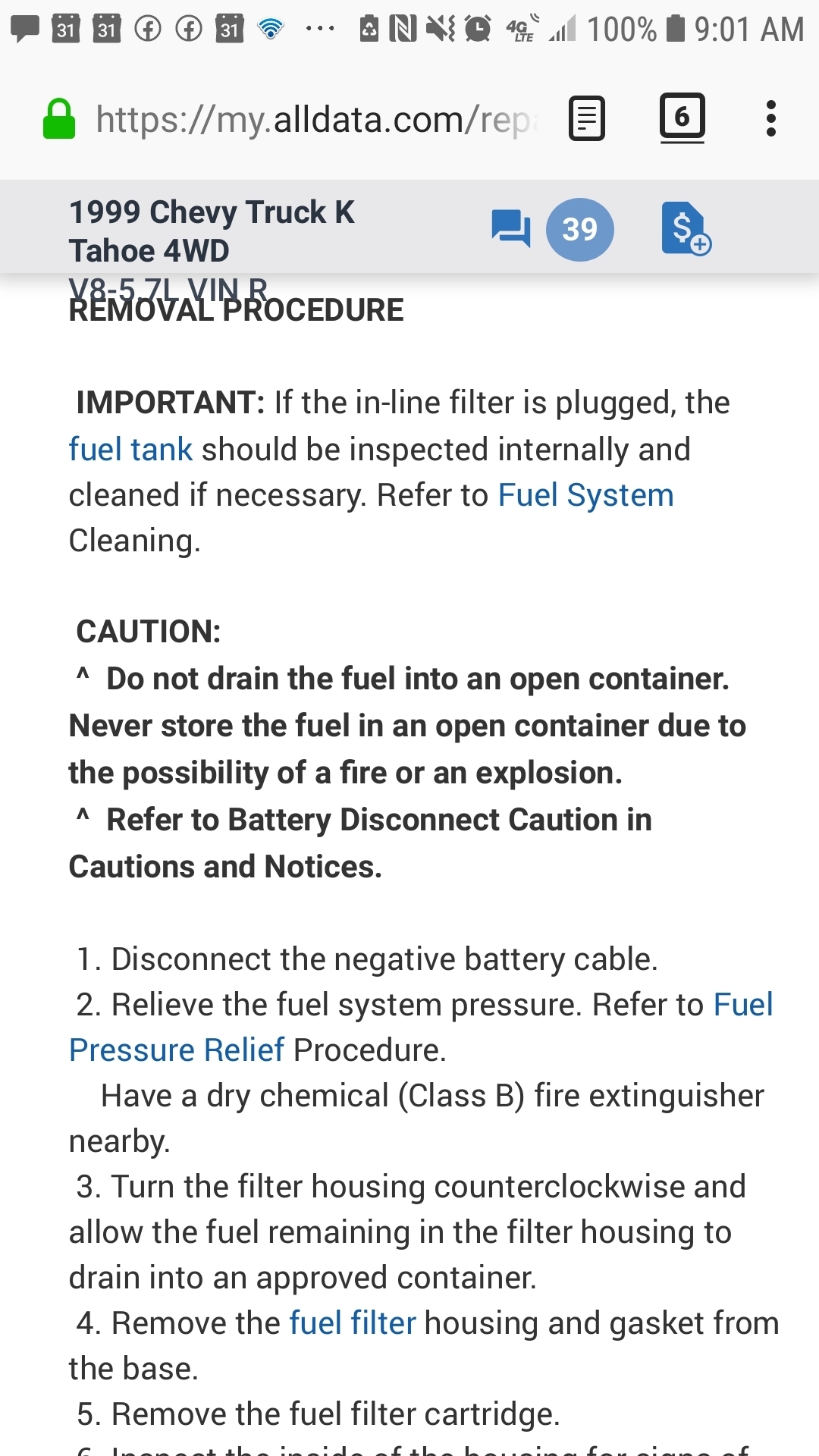

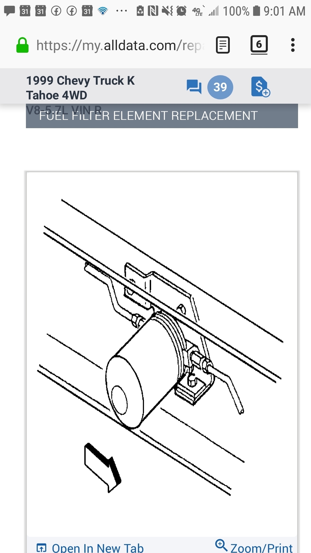

Hello and thanks for stopping by. When you say "good pressure," have you actually measured the output with a pressure tester? Or did you just push on the valve and it sprayed out? If you just pushed the valve, then I suggest borrowing a fuel pressure tester from the local auto parts shop and running a pressure test. Pull the fuel pump relay and crank the engine a few times in order to relieve fuel pressure. Then hook up the pressure gauge. Put the relay back in. Turn the key on and see what it reads. These trucks require at least 60 psi to start. Any less will not do it.
If the pressure is just a few pounds short, try replacing your fuel filter. Instructions for that are in the images attached. If it's really low (like 30 psi or less) then you likely need a new pump, which is common to these trucks. In my experience, after 160,000 miles you're on borrowed time with these pumps.
Here's our official guide in checking fuel pressure. It's much better than AllData's guide. https://www.2carpros.com/articles/how-to-check-fuel-system-pressure-and-regulator
So start there and left me know what you find. We'll go from there.

56 to 62 PSI... Below 56 is where you will start having problems. Also, make sure there isn't a problem with the regulator. Here is a how to video that explains how to check it. I hope it helps.

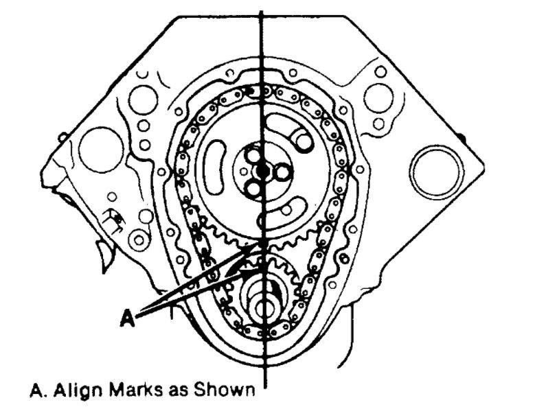

We replaced the fuel pressure regulator, it was washed out and clean right under the regulator like it had been leaking, flushed injection system,then had to clear the codes because of misfires, took truck out for a drive and it still acted up. Put scanner on it and it all looked good except for -14 on cam timing. Took it to my local GM dealer and they reset the timing and said the truck was fine. But now when I go up a hill under load it pings and knocks then goes away. any ideas?

Dpierce.
The cam retard at -17 is not good. The dealer change the position of the distributor to get the 0 reading that the cam sensor requires.
Doing that s compensation for a worn timing chain. That is why you have pinging. Most likely you will need to replace a worn timing chain and then have the cam retard reset.
