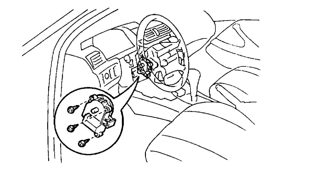

Good afternoon.
There is a mode door motor under the left side of the dash that controls the air direction. Easy replacement and you can get the actuator at any parts store.
