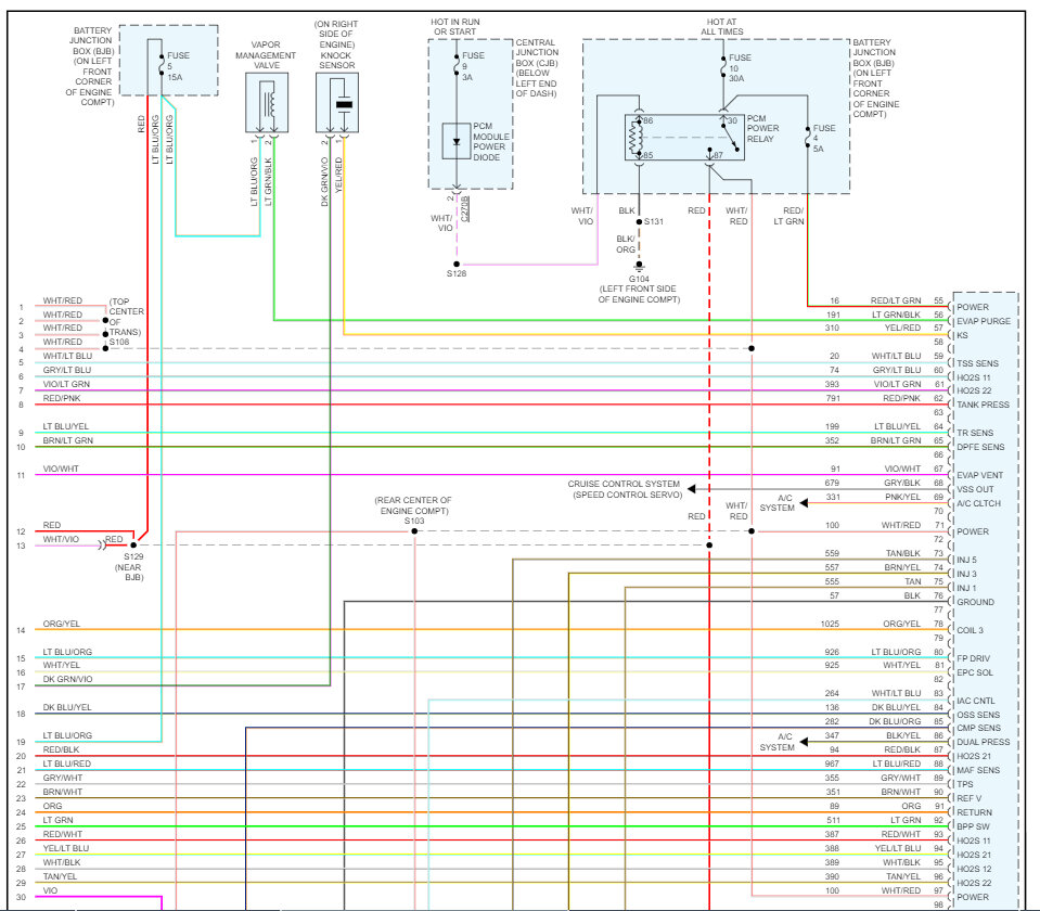

The engine will not start but will crank?
2002 FORD ESCAPE
150,000 MILES • 6 CYL • 2WD • AUTOMATIC
DAVIDGILBERT2003

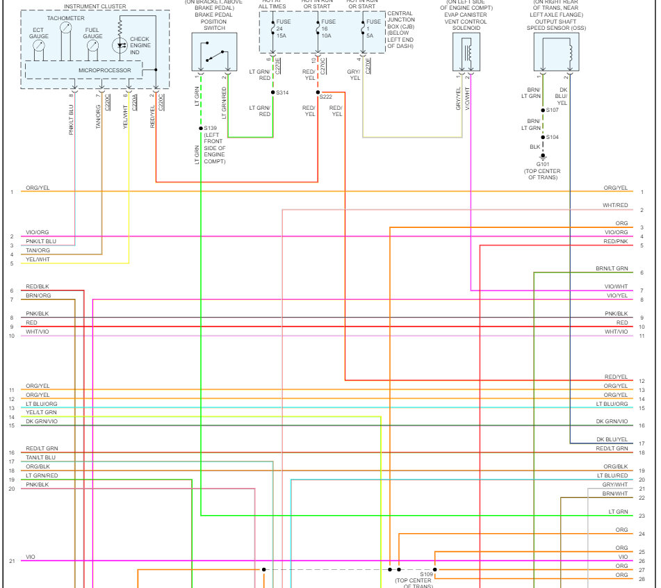

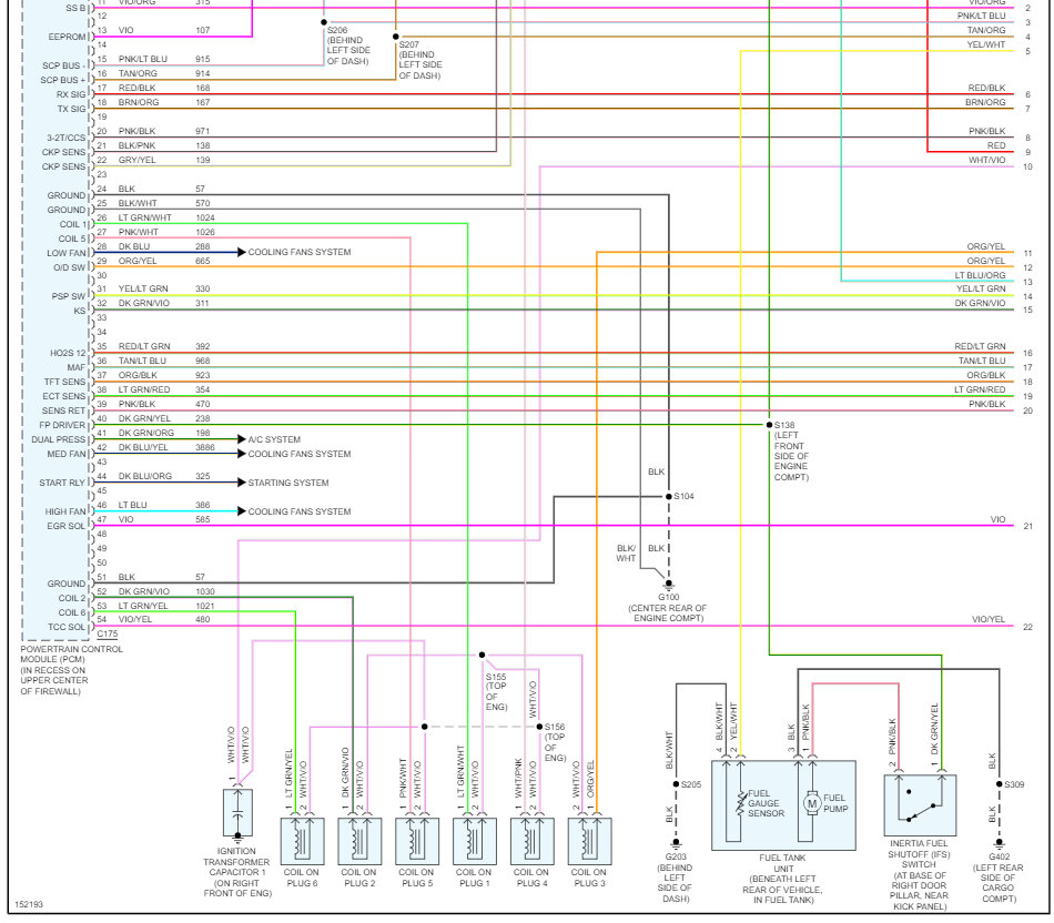

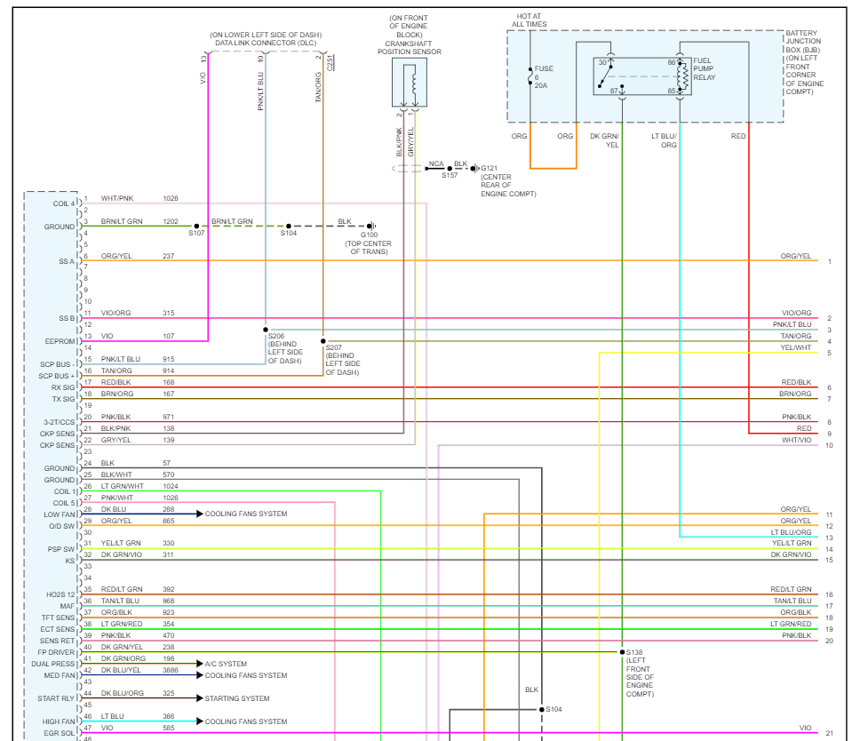

I have gotten down to my fuel pump. I’ve replaced it and it still will not come on. I put power straight to it, and it came on, so I know it works. I’ve checked the fuse and the relay, both are good. I tested the ground at the pump, and it is good. I tested voltage at pump as well. Almost 12 volts when key turns on, but quickly drops to 6 volts. I only get about 9 volts when cranking. I’ve checked the roll over switch and replaced the crankshaft position sensor as someone else suggested.
Aug 26, 2023 at 9:49 AM
  • 55,065 POSTS

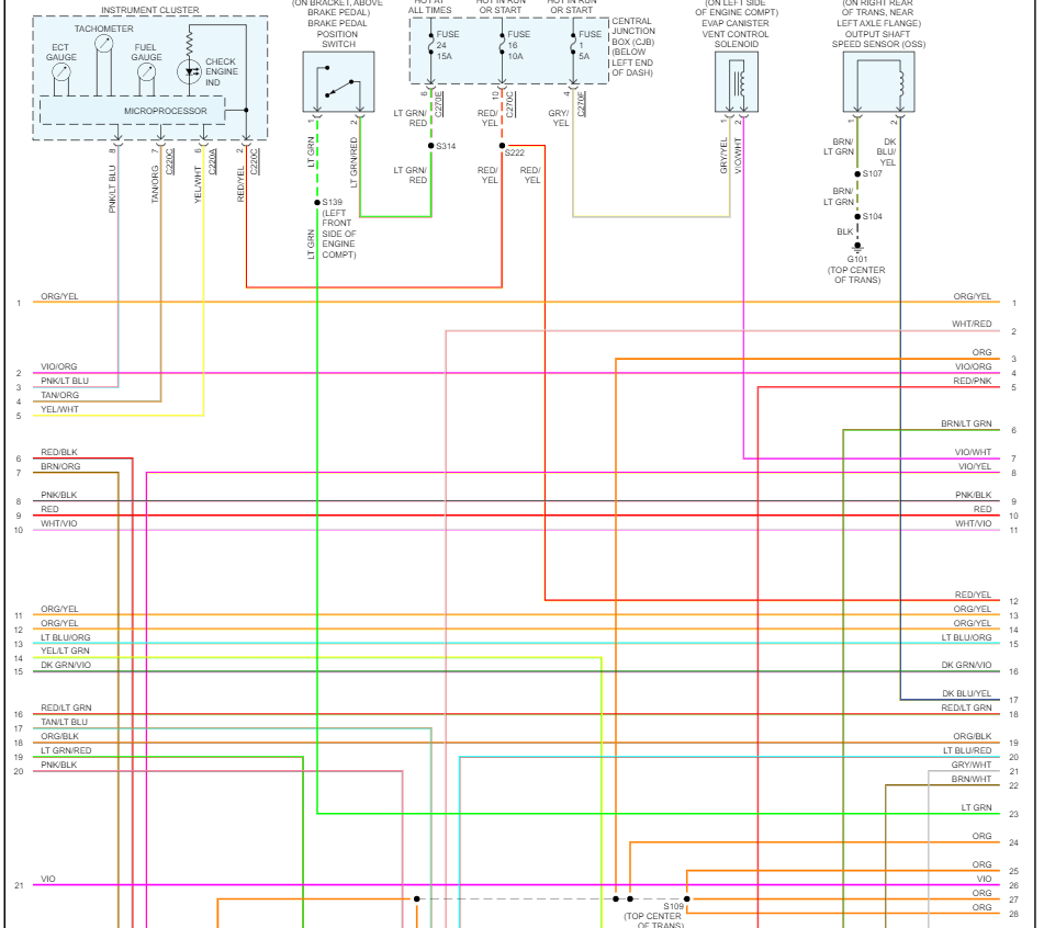

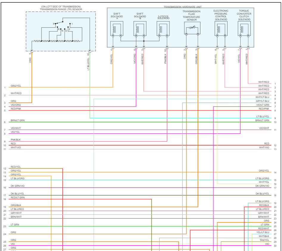

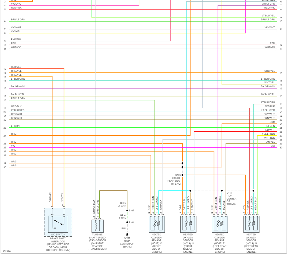

Let's check the voltage at fuse #6 which powers the pump. Please do the test with the key on. this guide can help, and I have included the fuel pump wiring diagrams so you can see how the system works:
Aug 27, 2023 at 3:54 AM
