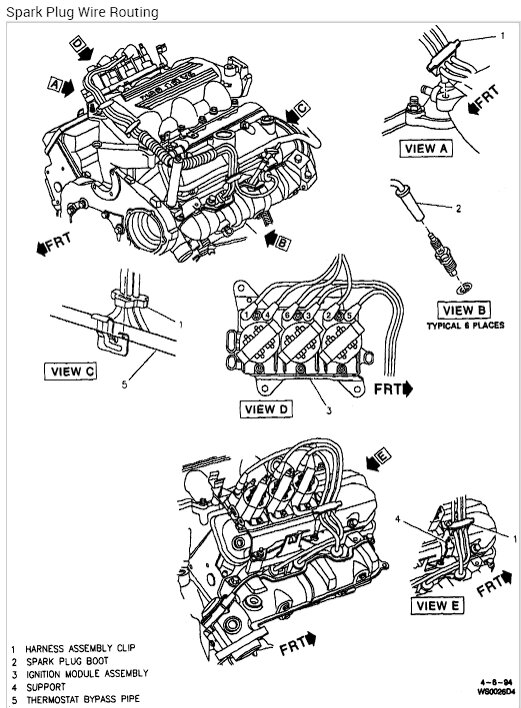

The first thing I would do here is to test for good spark at the spark plugs. You can use a spark tester, or a spark plug attached to the plug wire and properly grounded.
Here is a video that should help:
https://youtu.be/baq_aEWNQ0Y
I have also attached a diagram of the plug wire layout for your engine. Note that there are three separate coils, I would test each one to make sure they are all working properly. If you have good spark, then I would move on to testing the fuel system. Most parts houses, Napa, AutoZone, etc. have a loaner tool program where you can get a fuel system pressure tester.

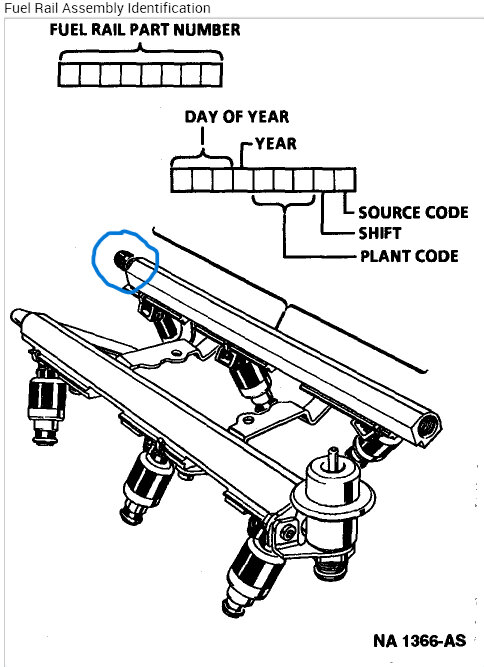

Here is a link on how to test the fuel delivery system. The blue circle on the diagram shows the location of the test port.
https://youtu.be/peh7-pFycyc
The fuel pressure for this vehicle should be 41-47psi.
Please let me know what you find and if you need further assistance and we will take it from there.
