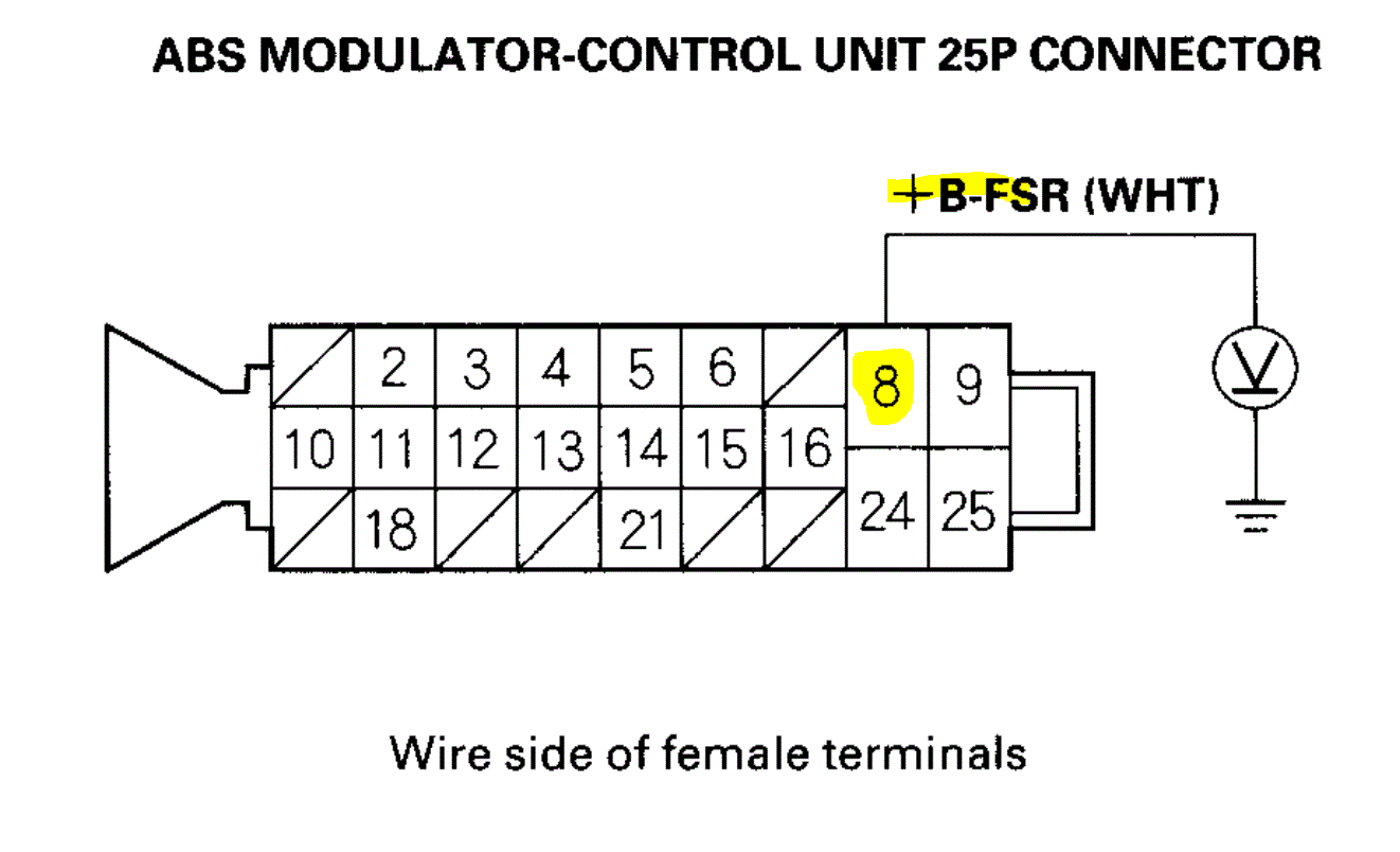

All power is lost, no power steering. Recently (within 6 months) had service done to Power Steering system. Heavy dark residue on top of Alternator, which is located under Power Steering Pump. Possibly from Power Steering system issues or repairs. 4 DTCs and 1 ABS DTCs, listed below. CEL/MIL illuminated and turned off with OBDII scanner. Vehicle key on and key off cycled three times with no CEL/MIL illuminated. Unfamiliar with the ABS DTC, replacing the MAF sensor to correct the other DTCs. Will list below and load Freeze Frame Data for DTC P0172.

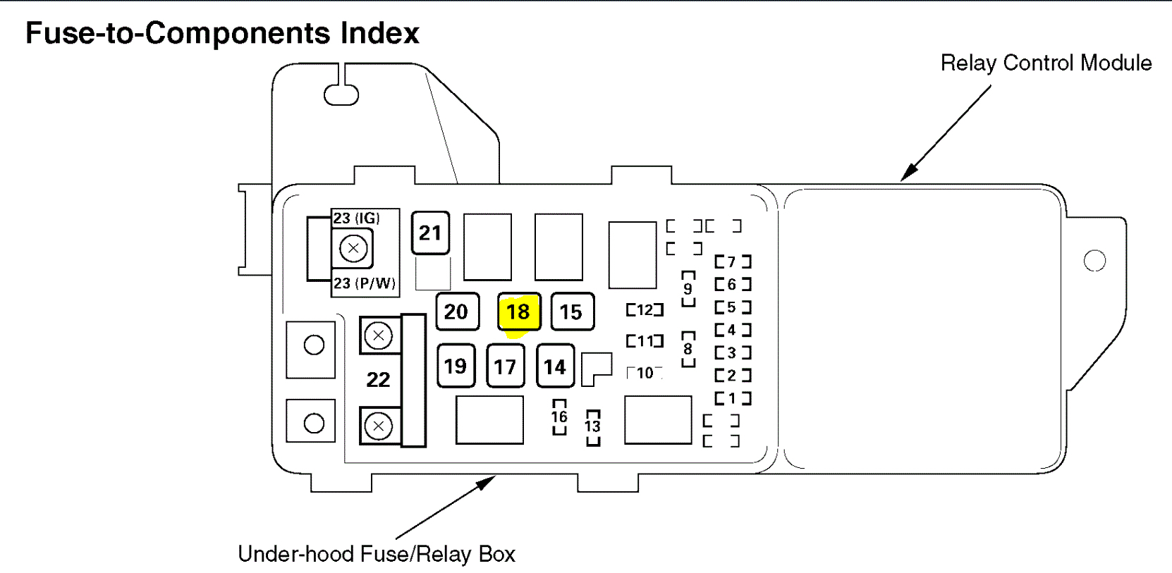

As far as the ABS, first, check fuse 18 in the under-hood fuse box. See pic 1 below.
In addition to checking the fuse, confirm there is power to and from it. Here is a link you may find helpful:
If the fuse is good and has power to and from it, next do the following:
1) Disconnect the ABS modulator-control unit 25P connector.
2) Measure the voltage between the ABS modulator-control unit 25P connector terminal No. 8 and body ground. (See pic 2 below)
3) If there is battery voltage at pin 8 (12v), Check for loose terminals in the ABS modulator-control unit 25P connector. If connections are OK, replace the ABS modulator-control unit.
4) If there is no power at pin 8, there is an open in the wire between the No. 18 (20 A) fuse in the under-hood fuse/relay box and the ABS modulator-control unit.
