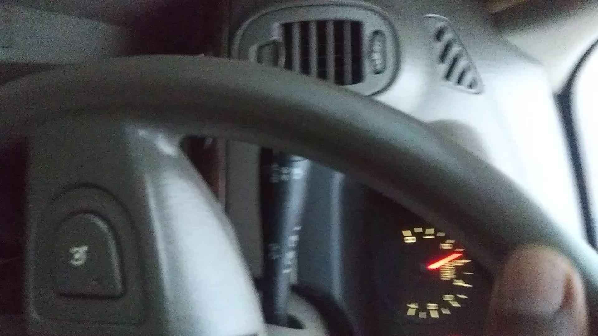

10 to 15 minutes before it starts shaking too bad. I wasn't able to get it until full speed when the incident happened because I was in a residential area, but you can hear the noise that it's making closer to the end of the video.

That video is a great help. Clearly it is a rotational noise so that means it is the axle, hub/rotor, or tire. I am putting my money on the tires. So that means the only what we are going to figure this out is start making a change. Since you stated it sounds like it is coming from the front left, either put a spare (if you have one ) on that spot or rotate the tires from the front to rear and see if the noise seems to move to the rear.

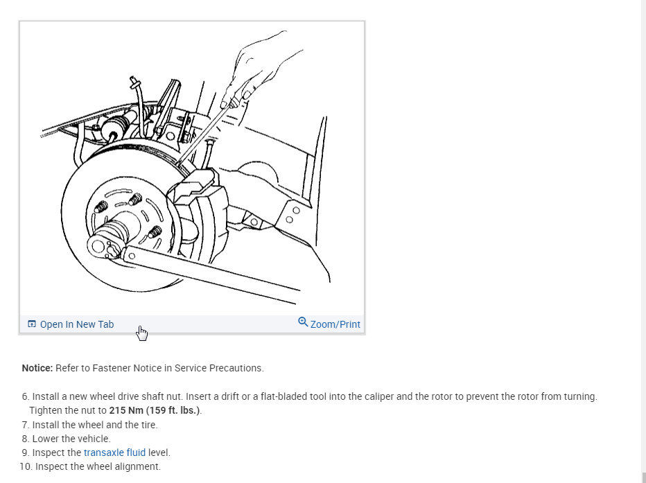

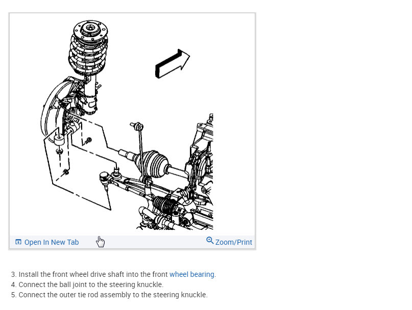

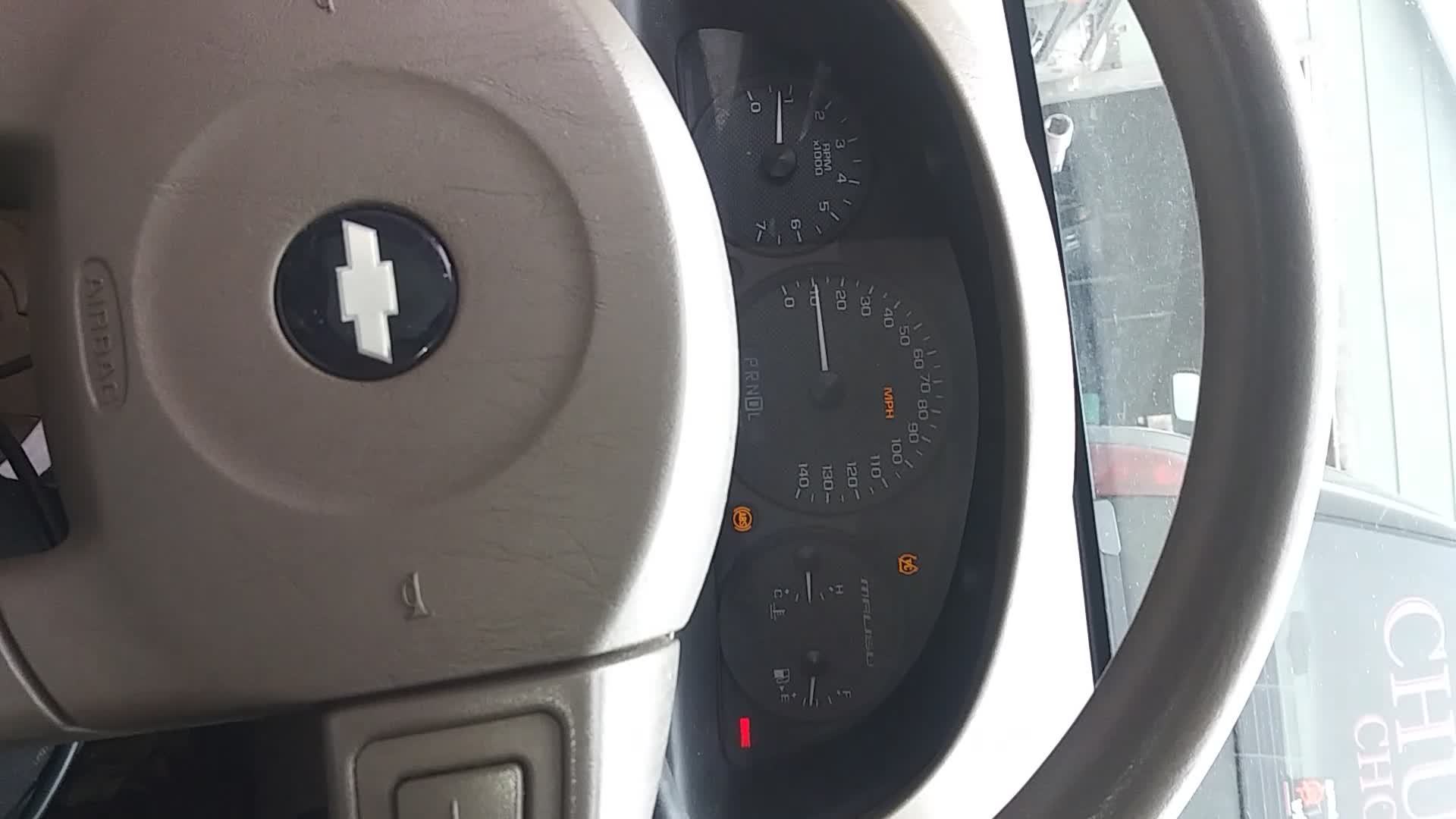

I think with the brake caliper pin stuck just added to the problems already had. breaker easy to fix I'm not worried about that I attached a video what the noises that I am hearing while the car is jacked up in the air with the tires removed.

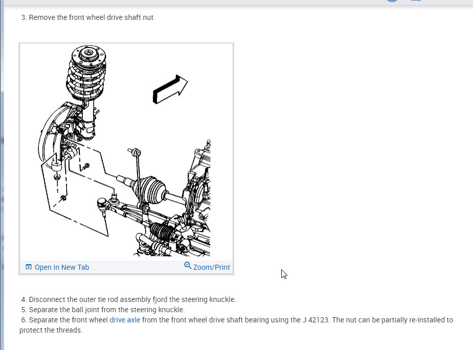

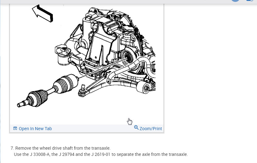

Great job narrowing that down. That is clearly clunking with the rotation of the axle shaft. If you watch the passenger axle shaft it wobbles and you can actually hear it has a double clunk. This means it is a second order vibration or noise. Second order means two anomalies in one rotation. If it were me, I would replace that axle shaft and go from there.

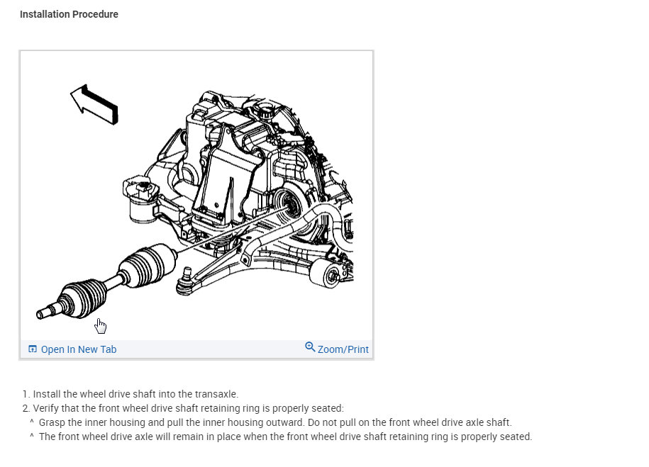

KASEKENNY1 suspected the axle the to be faulty so I bought new ones to put in after the video I uploaded earlier today. I swapped out the passenger side axle and replaced it with the new one, but the noise or the vibration did not go away.so I'm completely stumped.

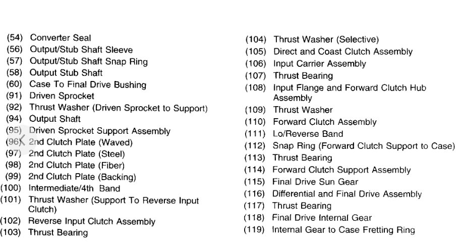

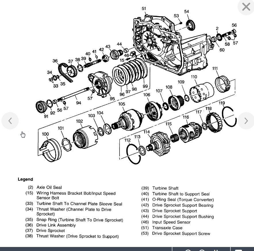

Bearings in the transmission normally make a growling noise but you must have an issue with the thrust bearing in the differential. If this is the issue it could be allowing the axle to walk like it is. I am surprised that was not the issue but if the axle is new then it is clearly inside the unit. There is no question that this axle is actually making the noise, it is just determining what is causing it to walk like it is and the only way to find that out is to remove the transmission and tear it down. This is not something you will want to do in your driveway. It can be done but is not fun at all.
