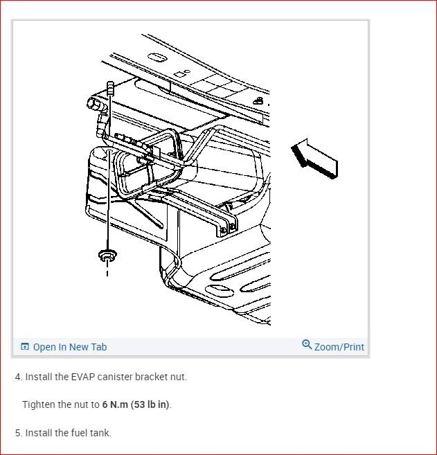

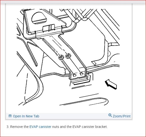

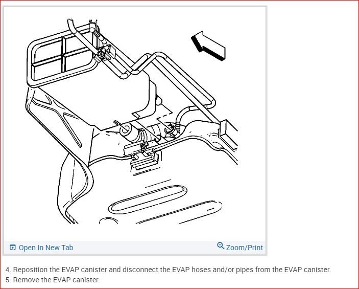

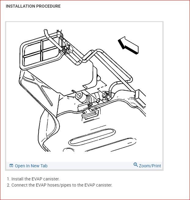

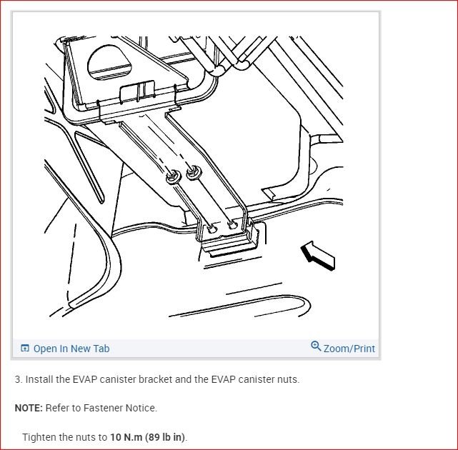

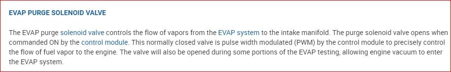

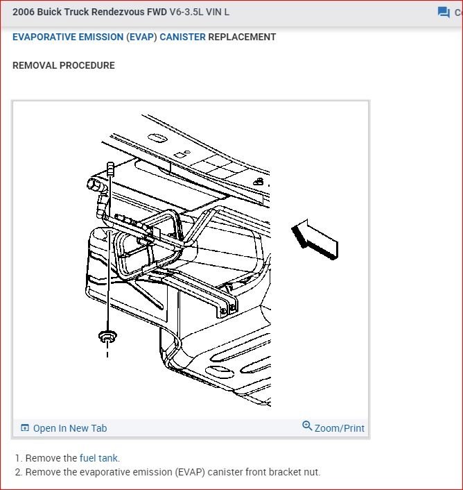

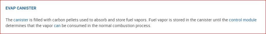

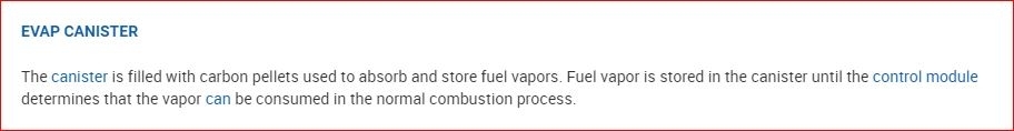

No. It seems like the pressure is okay. I would jump to the EVAP system and inspect the charcoal canister for having raw fuel in it. You could have an issue with the purge valve but any time you can smell fuel, it is normally the EVAP system.
I would start with the canister but if that does not have fuel in it, then I would inspect the purge valve for not sealing. The canister should only have fuel vapor in it so if you find any fuel then I would replace it and retest before moving onto the purge.
This issue (canister or purge) explains all of your issues so the fact that you can smell it as well, I am highly confident that this system is your issue.
