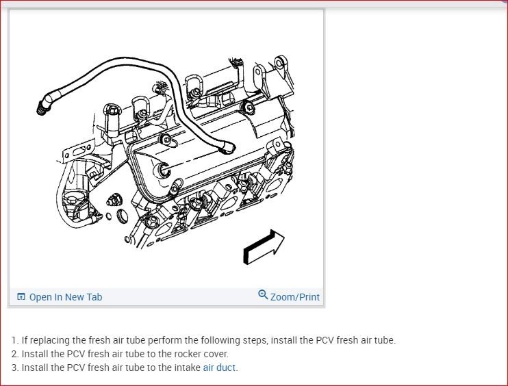

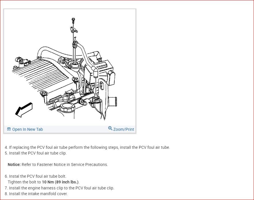

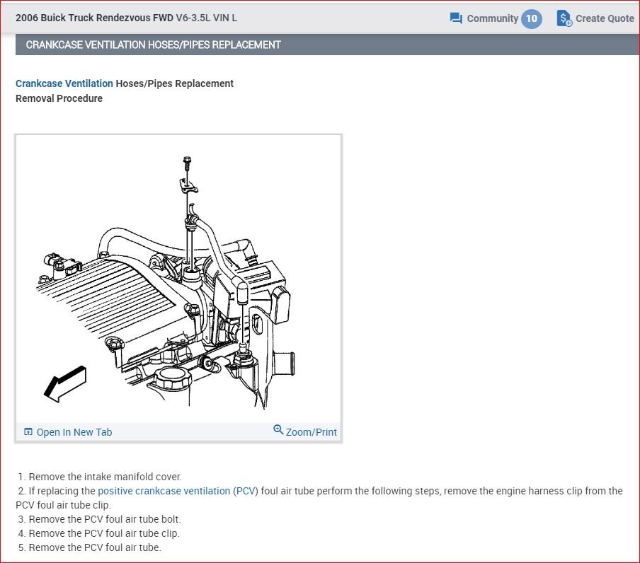

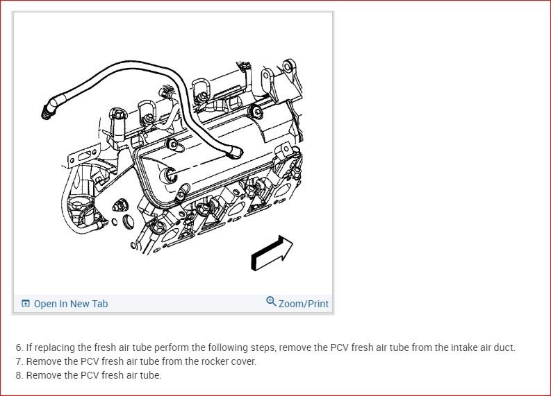

Here is what Alldata shows for the PCV valve.
It is possible that the o2s are an issue. If they are not reading properly then the PCM is adjusting the fuel off of bad info.

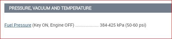

Your fuel pressure should be between 50-60PSI with the key on and engine off. What was your pressure when you measured it?
I do see on some chat pages where people with 3.5L cannot find the PCV but I am not sure what they would use in its place. Basically they should be using something to recycle blow by gasses or they may just be venting them on this engine. However, Alldata is usually pretty accurate.
It sounds like you have an issue with excess crankcase pressure because that is normally where the gunk comes from. You may need to do a combustion/intake cleaner. They have that spray foam stuff that you spray into the intake that just melts all that stuff away.

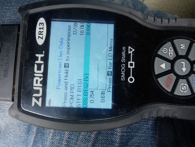

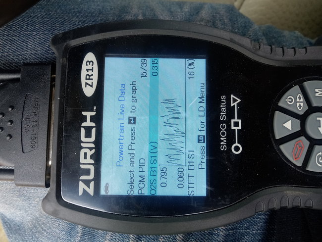

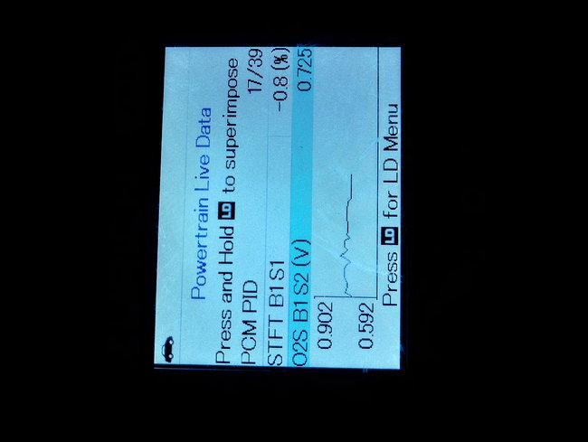

Here is the live data from my two 02 sensors while i was giving it some gas in park. My fuel pressure is at 58lbs. When i step into the throttle it drops a couple of PSI but not very much. I do have that PCV hose on my engine but there is only a small metal pipe that it attaches to on the valve cover nothing that i can take off. Thanks again for replying.
Jun 11, 2019 at 4:30 AM
Your fuel trims look okay. They are 1.6 in that screen shot and fuel pressure is good because it needs to be between 50 and 75 PSI.
Have you checked for vacuum leaks? When you turn the AC on, you are adding a load to the engine and it may be adding a little fuel due to the load.
here is a guide that shows how to check for a vacuum leak. Do you have a vacuum gauge? You should find the needle of the gauge is perfectly steady.
Jun 11, 2019 at 5:30 AM

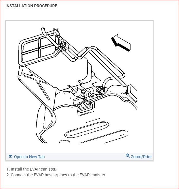

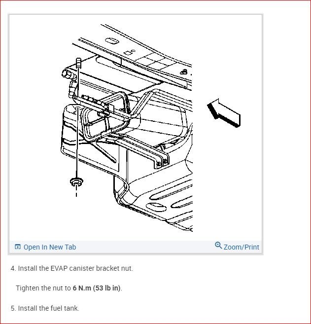

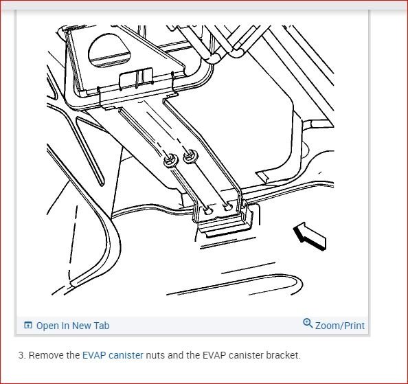

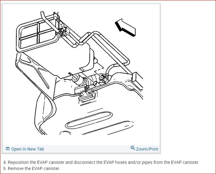

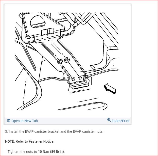

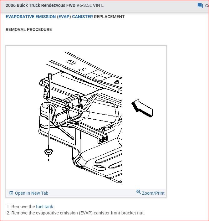

No. It seems like the pressure is okay. I would jump to the EVAP system and inspect the charcoal canister for having raw fuel in it. You could have an issue with the purge valve but any time you can smell fuel, it is normally the EVAP system.
I would start with the canister but if that does not have fuel in it, then I would inspect the purge valve for not sealing. The canister should only have fuel vapor in it so if you find any fuel then I would replace it and retest before moving onto the purge.
This issue (canister or purge) explains all of your issues so the fact that you can smell it as well, I am highly confident that this system is your issue.
