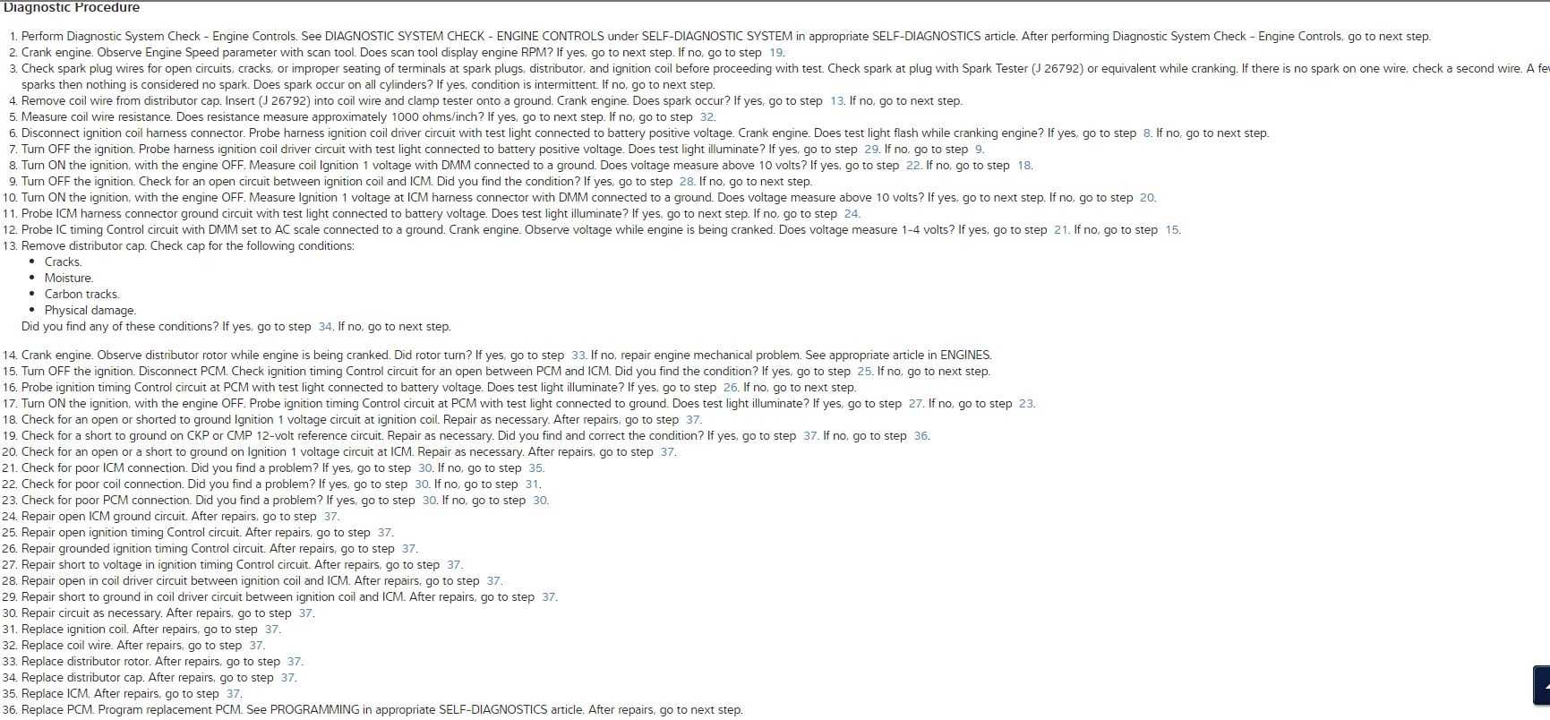

All connectors under the engine cover inside the cab have power to one or two wires. I cranked the engine with the spark plug wire disconnected to check for spark with the tester and did not get a spark. I checked the wire feeding the inside node of the distributor (I guess coming from the coil?) and there is no spark there either. I checked the wire going into the coil? and there is power. Nothing coming out of the coil though. Am I right, that is the coil?
May 3, 2018 at 3:20 AM
ROYDEANJR
  • 7 POSTS
Also, is the coil normally replaced during an engine tune up? The distributor cap was replaced, but not the coil.
May 3, 2018 at 3:23 AM
PATENTED_REPAIR_PRO
  • 1,853 POSTS
No, the coil is not usually replaced when doing a tune-up, only if it's bad. I have to ask, cause I have seen it, did you forget to install a rotor?
Did this problem happen immediately after the tune-up?
I am assuming the coil is inside the distributor cap? If it was, there would be no secondary coil wire. You may have a faulty ignition coil or maybe even a faulty ignition control module. First though confirm that the pink wire has voltage to it with the key on run/ engine off that check the coil.
Here are some tests and note the ignition control module can usually be tested at an autoparts store once you remove it and take it in.
May 3, 2018 at 4:41 AM
