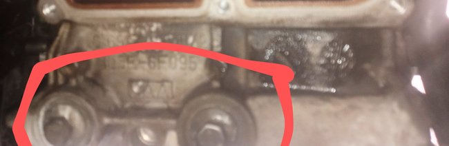

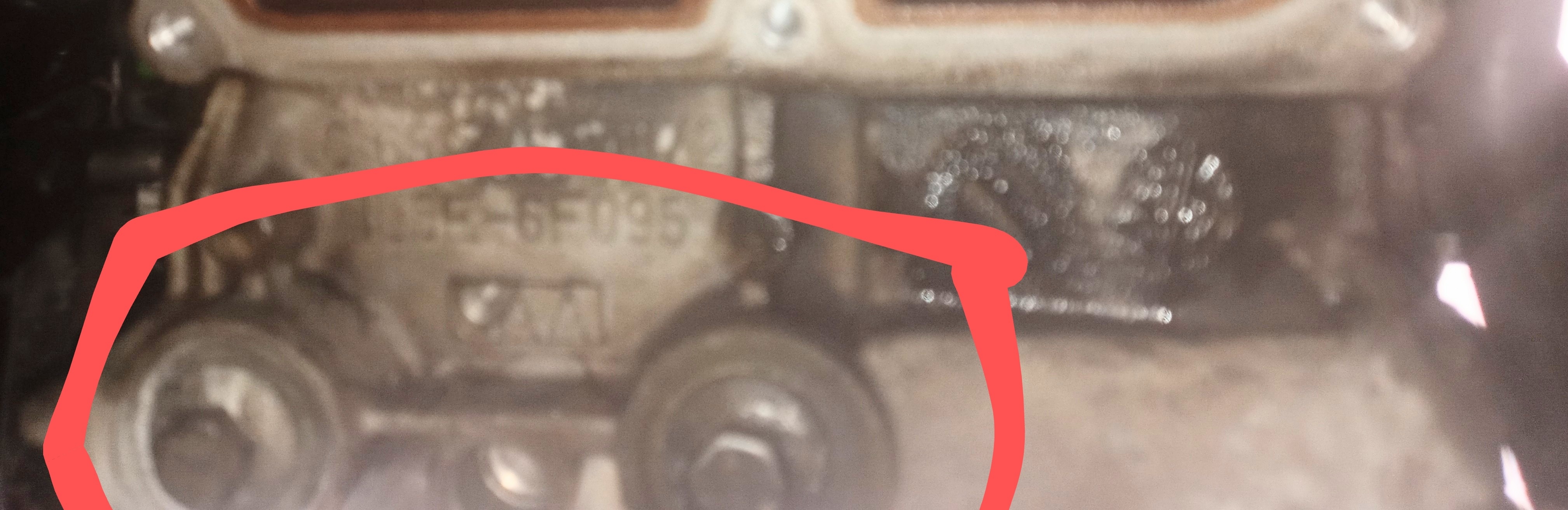

I finally got the balancer off but do I need to remove the two bolts in front of oil pan?
Saturday, April 3rd, 2021 AT 8:35 AM
  • 109,885 POSTS
It's hard to tell what I'm looking at in the pic. However, it looks like I'm seeing pan bolts removed. There shouldn't be anything else.

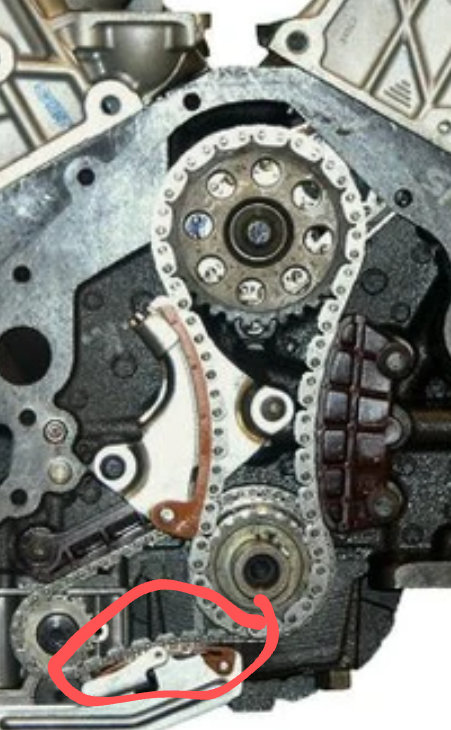

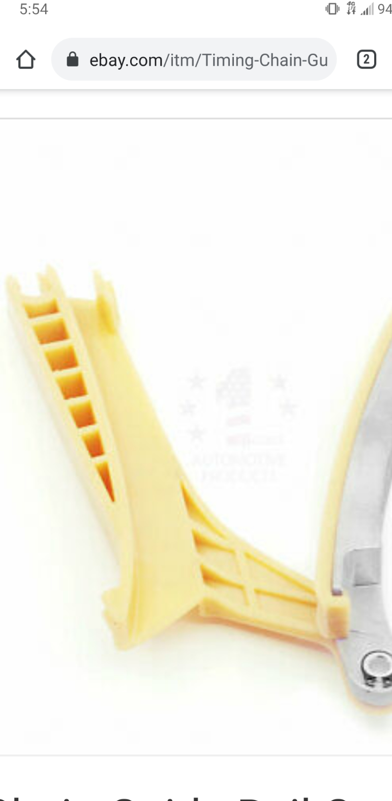

I don't see anything that the broken pieces could belong to. That's bad news, right? Doesn't it mean my engine has to be removed because it's in the back? It looks like it belongs on here.
Sunday, April 4th, 2021 AT 5:53 PM
  • 109,885 POSTS
That's odd. There is nothing that indicates a problem? As far as removing the engine, I don't see a need. I'm not sure what you mean by the back.
Sunday, April 4th, 2021 AT 8:55 PM
ARIANADANIELLE5345
  • 323 POSTS
The rear chain guides. Don't you have to remove the engine to get to those?
Monday, April 5th, 2021 AT 6:44 AM
ARIANADANIELLE5345
  • 323 POSTS
Nevermind, I think I found it. The chain is incredibly loose right here and there's another broken off piece of plastic underneath it.
Monday, April 5th, 2021 AT 12:15 PM
  • 109,885 POSTS
That is yet another guide. It's very possible that is where it came from.
