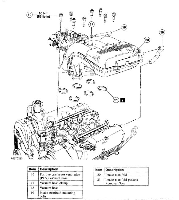

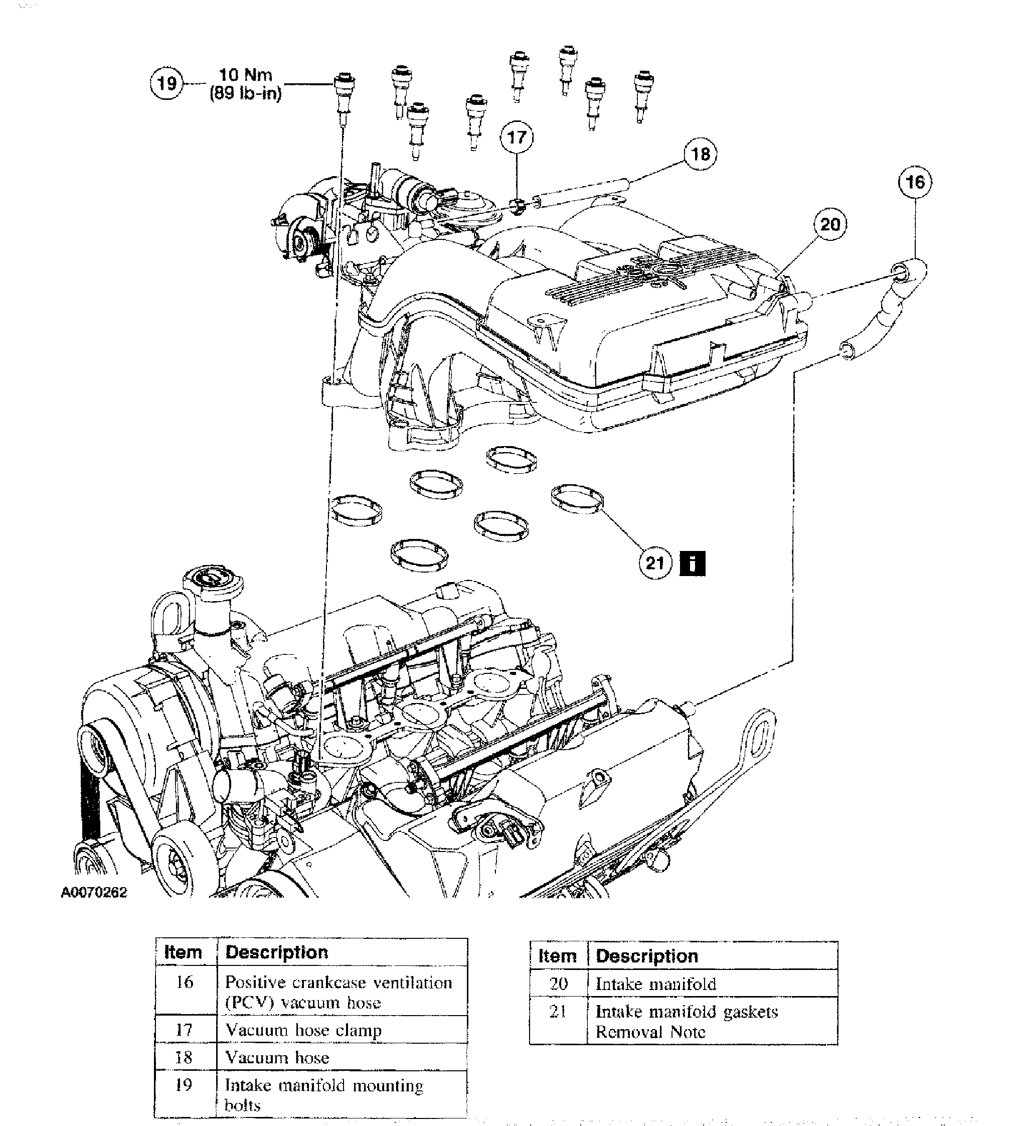

Intake Manifold
Removal and Installation

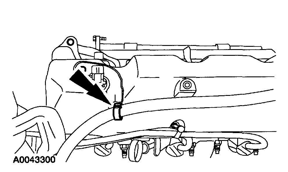

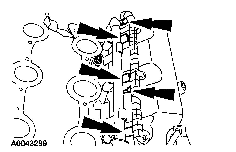

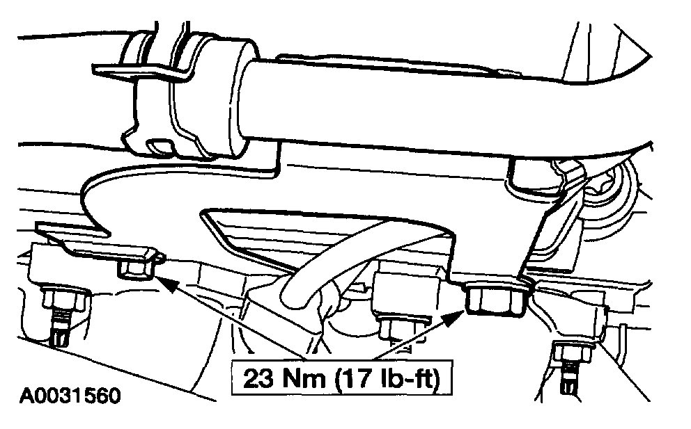

1. Disconnect the battery ground cable.
2. Remove the air cleaner outlet pipe.

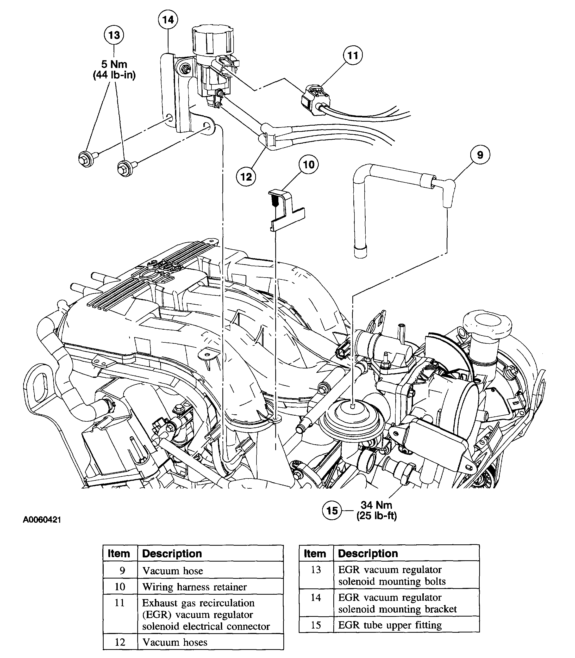

pic 1
3. Illustration 1 of 4 Remove the components in the order indicated.

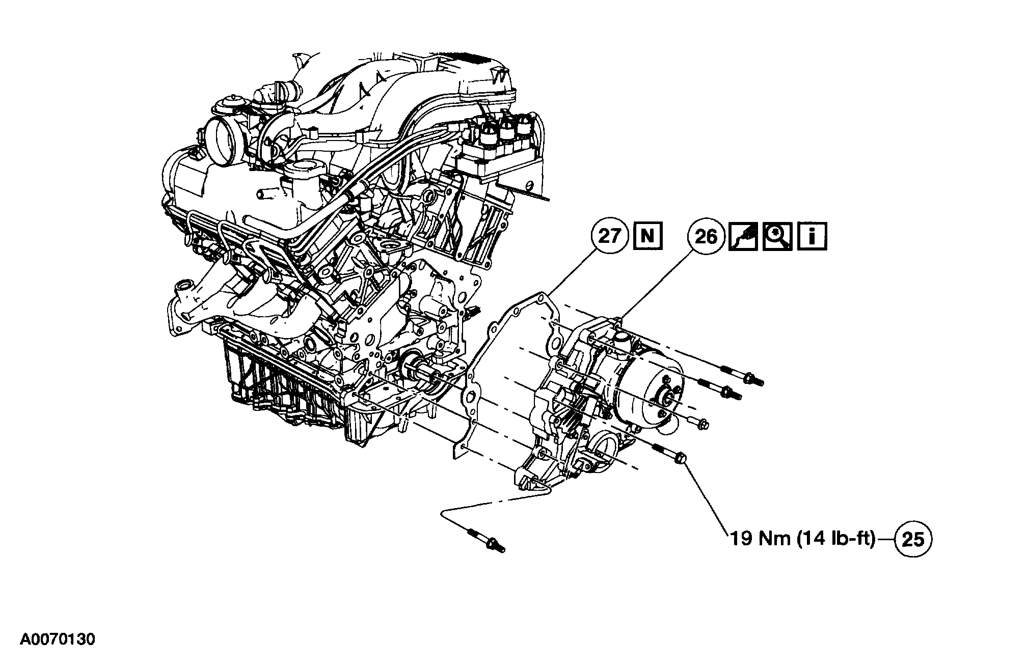

pic 2
4. Illustration 2 of 4 Remove the components in the order indicated.

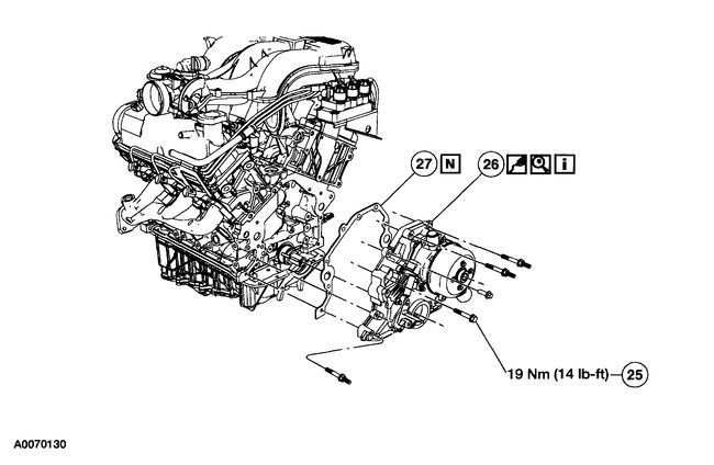

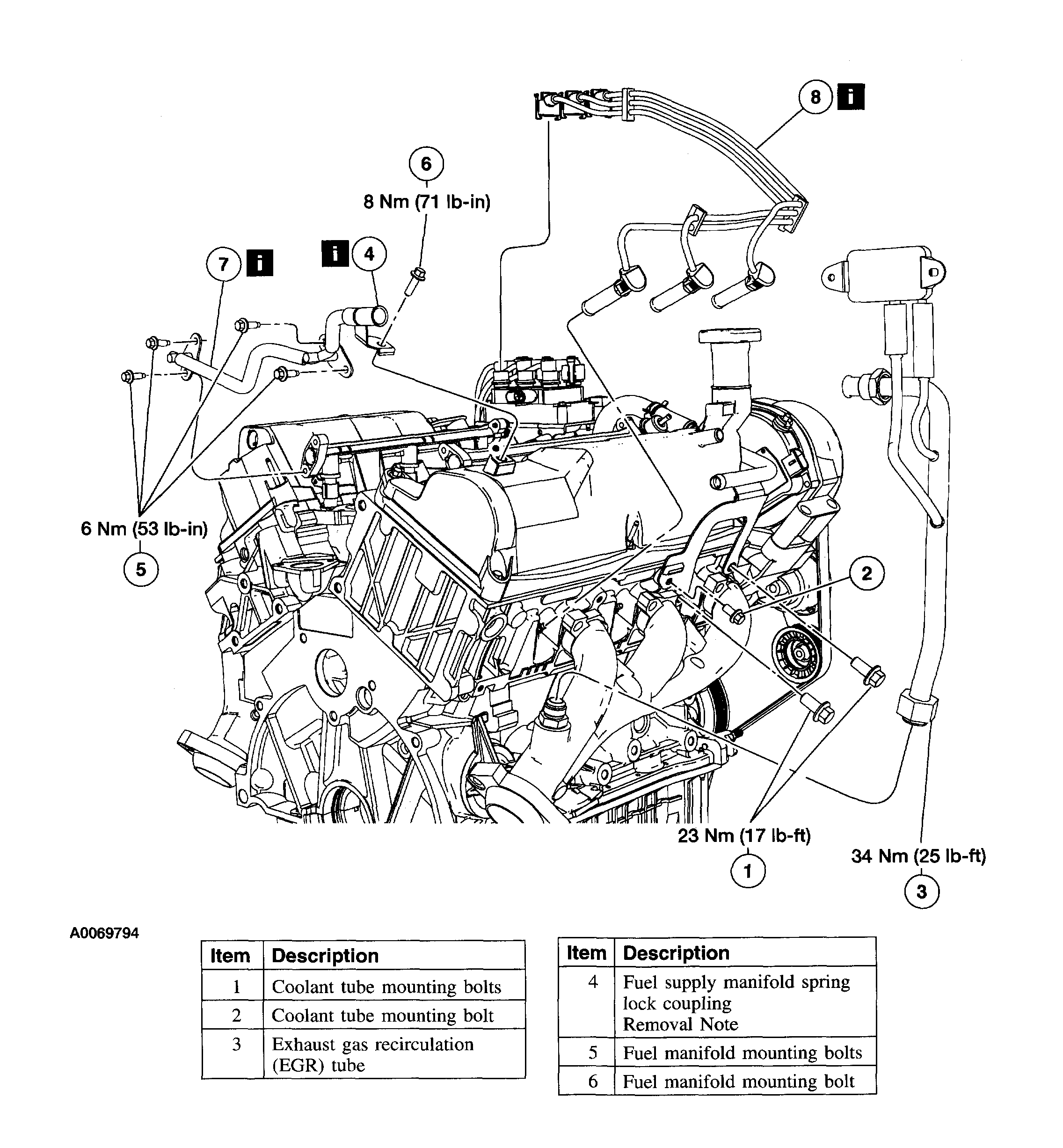

pic 3
5. Illustration 3 of 4 Remove the components in the order indicated.

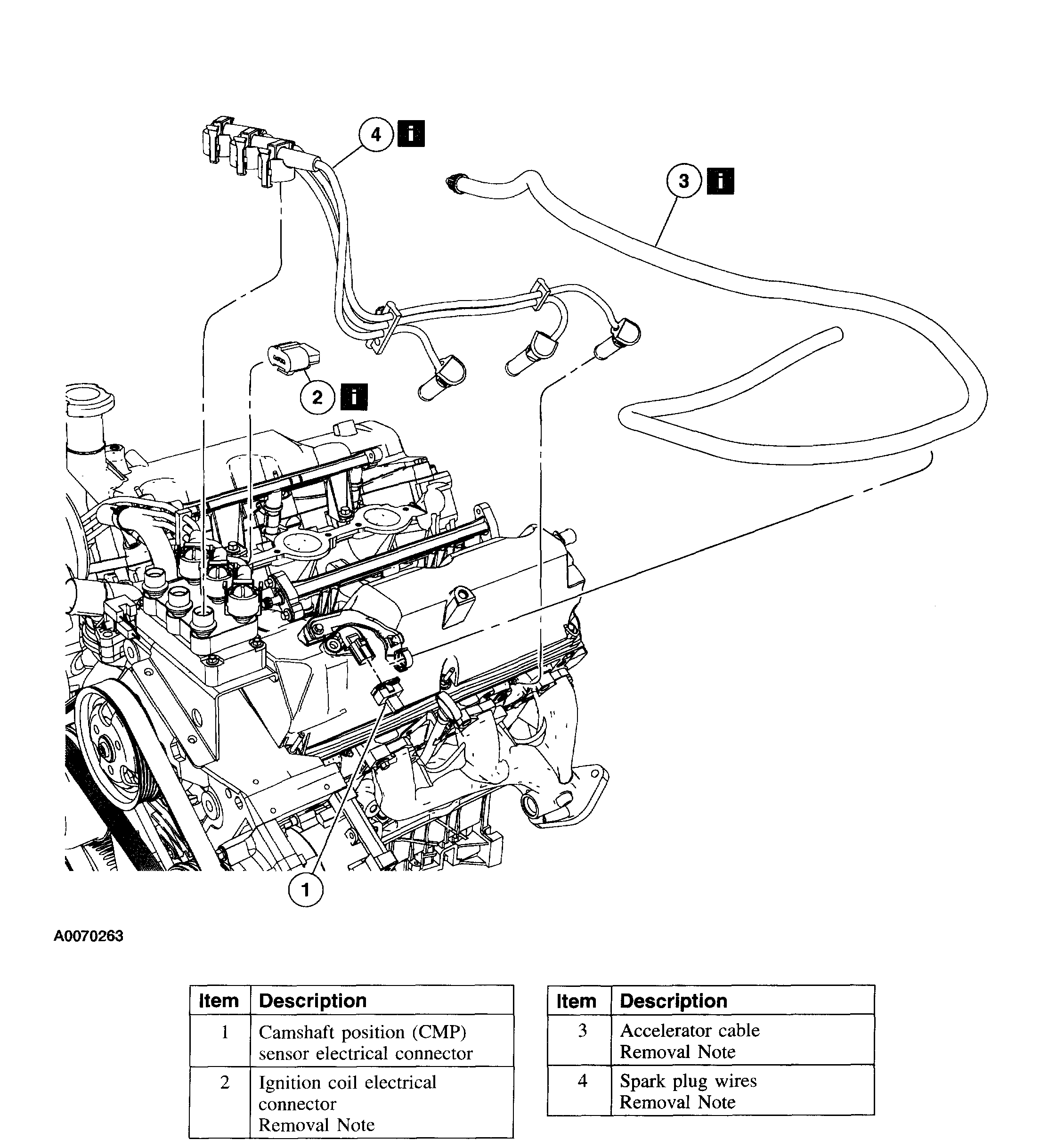

pic 4
6. Illustration 4 of 4 Remove the components in the order indicated.
7. To install, reverse the removal procedure.

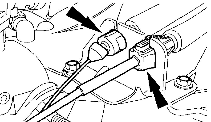

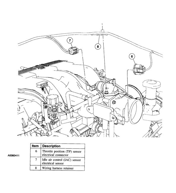

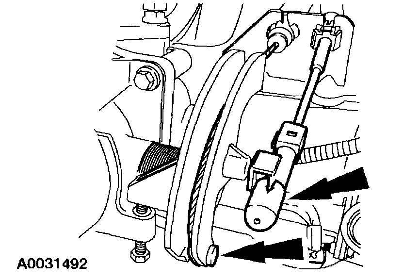

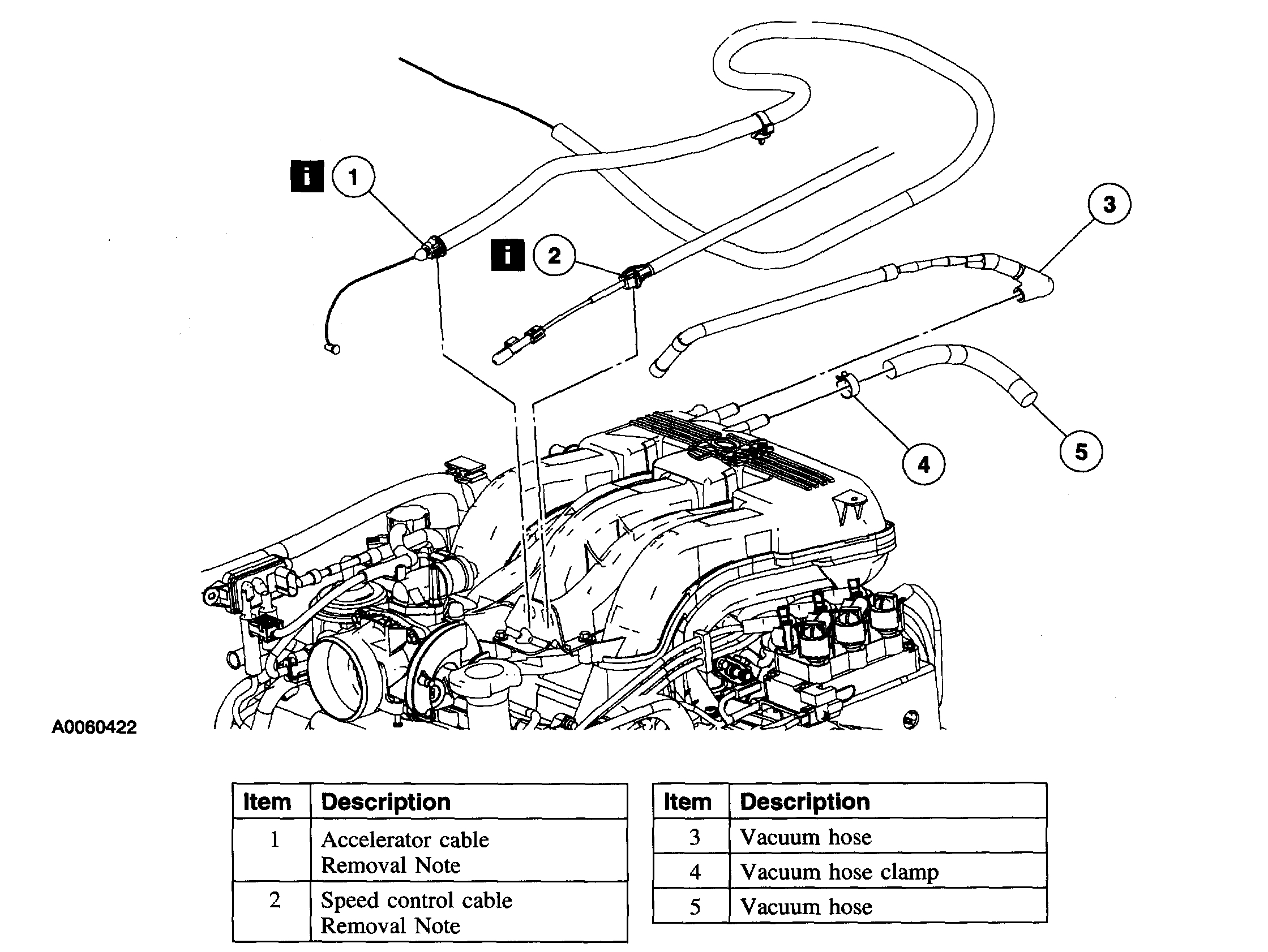

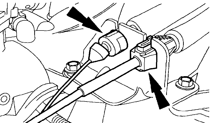

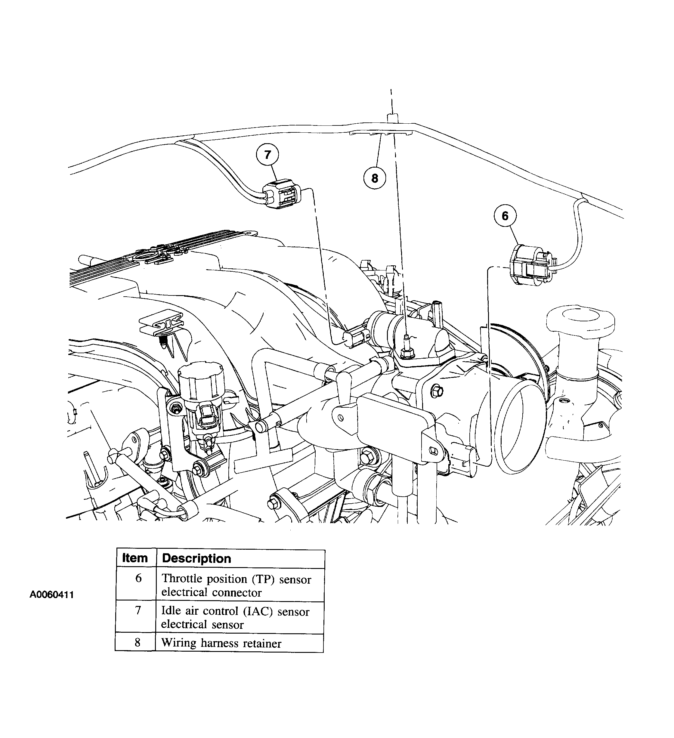

Items 1 and 2: Accelerator Cable and Speed Control Cable Removal Note
pic 5
1. Disconnect the accelerator and the speed control cables from the throttle body.
pic 6
2. Remove the accelerator cable and the speed control cable from the bracket. Position the cables away from the intake manifold.
pic 7

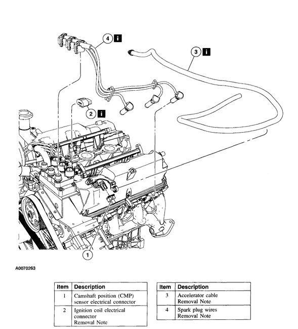

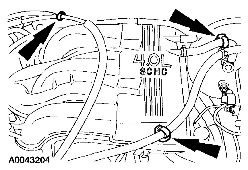

3. Disconnect the accelerator cable and the speed control cable routing clips. Disconnect the vacuum hose.
pic 8

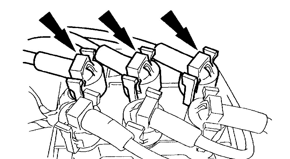

4. CAUTION: It is important to twist the spark plug wire boots while pulling upward to avoid possible damage to the spark plug wires.
NOTE: Spark plug wires must be connected to the correct ignition coil terminal. Mark spark plug wire locations before removing them.
Disconnect the spark plug wires.
pic 9
5. Disconnect the Knock Sensor (KS) electrical connector retainer.

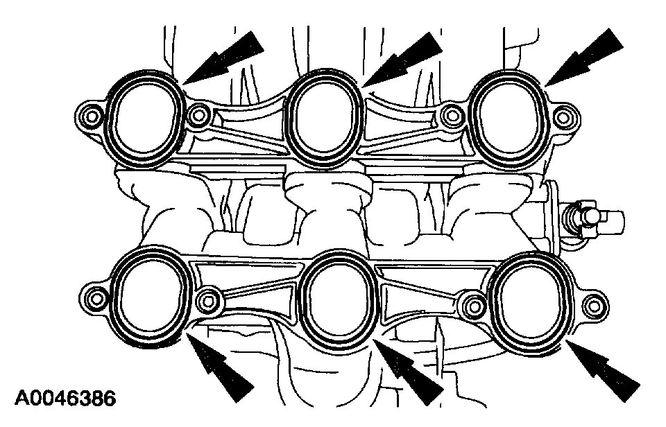

Item 21: Intake Manifold Gaskets Removal Note
pic 10

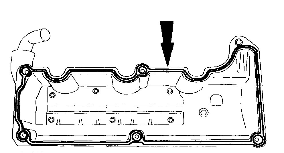

1. CAUTION: Do not use metal scrapers, wire brushes, power abrasive discs or other abrasive means to clean the sealing surfaces. These tools can cause scratches and gouges which can make leak paths.
Clean the sealing surfaces, inspect the gaskets and install new gaskets if necessary.

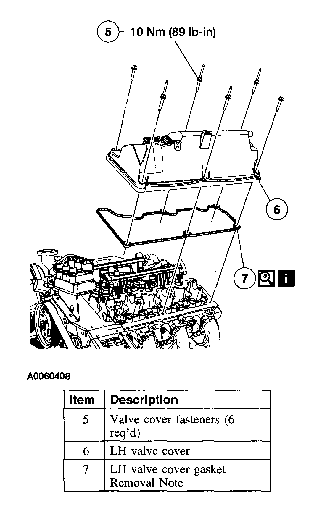

1. Remove the intake manifold.
pic 11
2. Illustration 1 of 2. Remove the components in the order indicated.

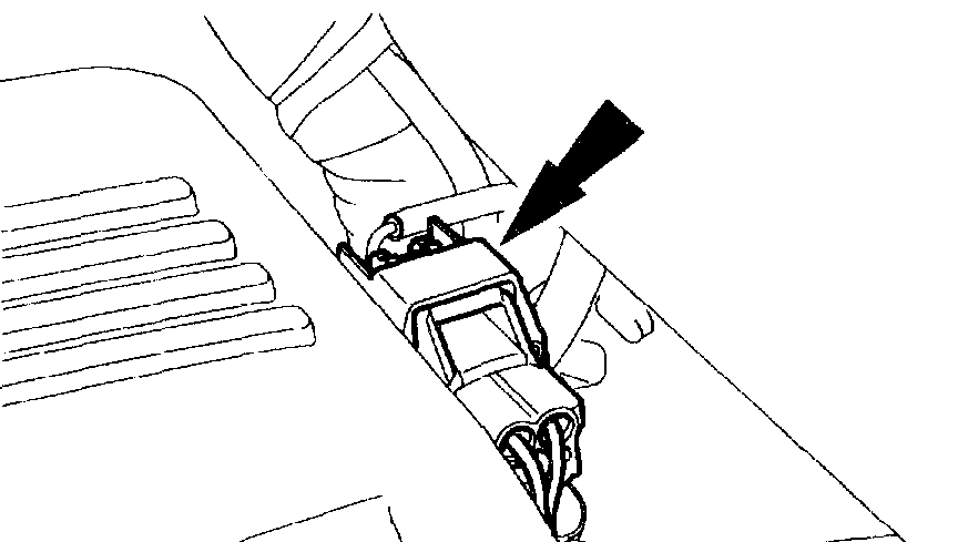

Item 2: Ignition Coil Electrical Connector Removal Note
1. Detach the pin-type retainer on the wiring harness near the ignition coil electrical connector.

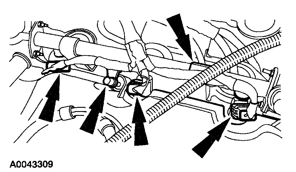

pic 13

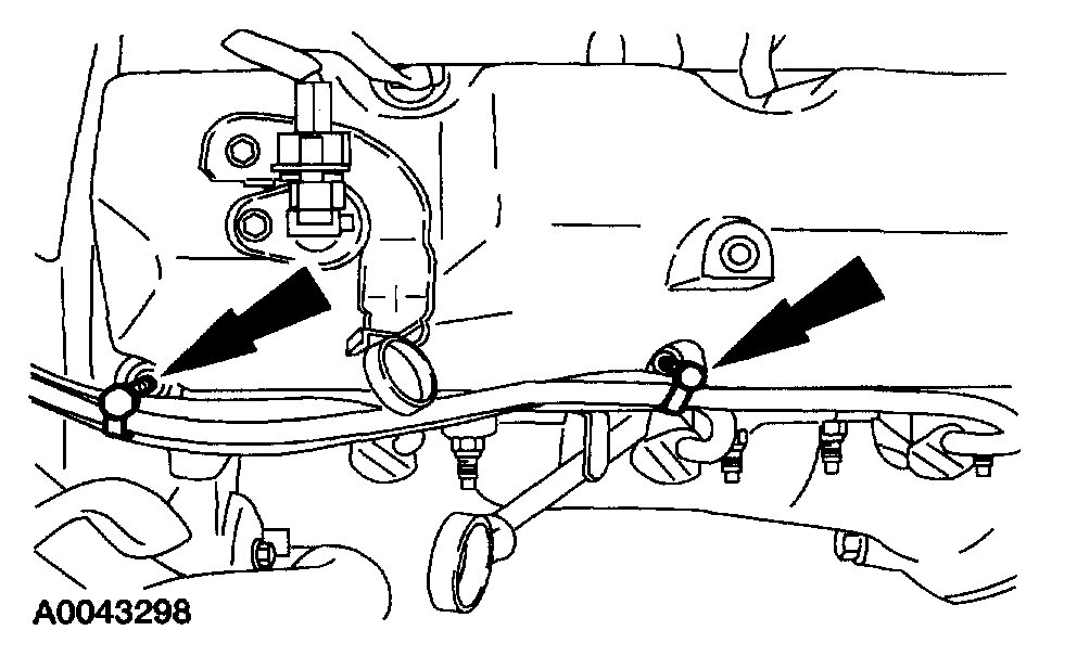

2. Disconnect the fuel injector electrical connectors and the harness standoff clips.

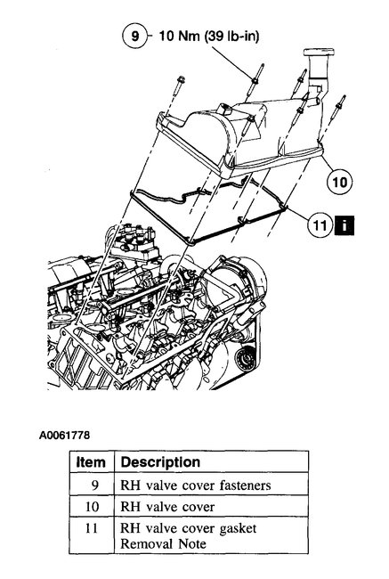

VALVE COVER RH
Valve Cover RH
1. Release the fuel system pressure.
2. Remove the intake manifold.
Part 1 Of 2
pic 17
Part 2 Of 2
pic 18
3. Illustration 1 of 2. Remove the components in the order indicated.
pic 19
4. Illustration 2 of 2. Remove the components in the order indicated.
5. To install, reverse the removal procedure.

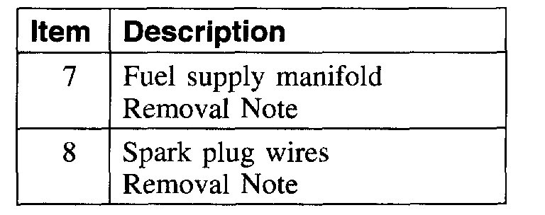

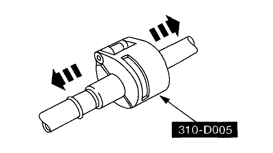

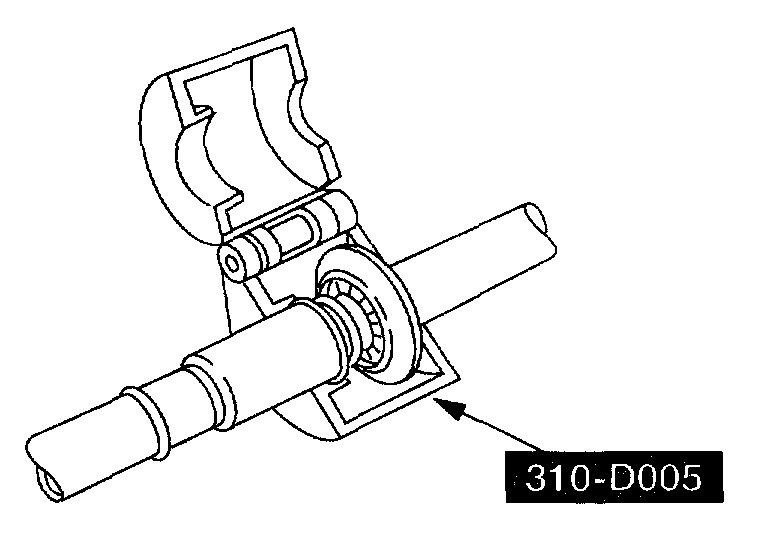

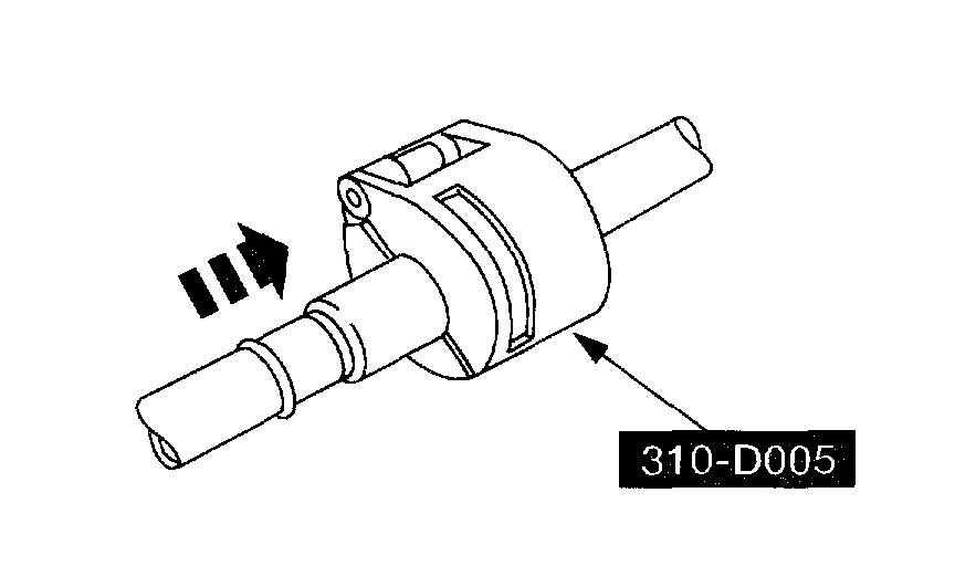

Item 4: Fuel Supply Manifold Spring Lock Coupling Removal Note
pic 20
1. Disconnect the fuel injector electrical connectors and routing clips.
pic 21
2. Install the special tool.
pic 22
3. Press the special tool into the open end of the cage.
pic 23
4. Separate the fuel line fitting.
Item 7: Fuel Supply Manifold Removal Note
1. CAUTION: Use O-ring seals that are made of special fuel-resistant material. Use of ordinary O-ring seals can cause the fuel system to leak.
Discard the fuel supply manifold O-ring and install a new O-ring.
Item 8: Spark Plug Wires Removal Note
pic 24
1. Disconnect the retaining clips and position the spark plug wires aside.

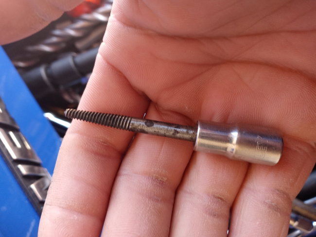

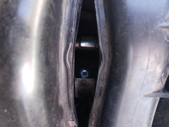

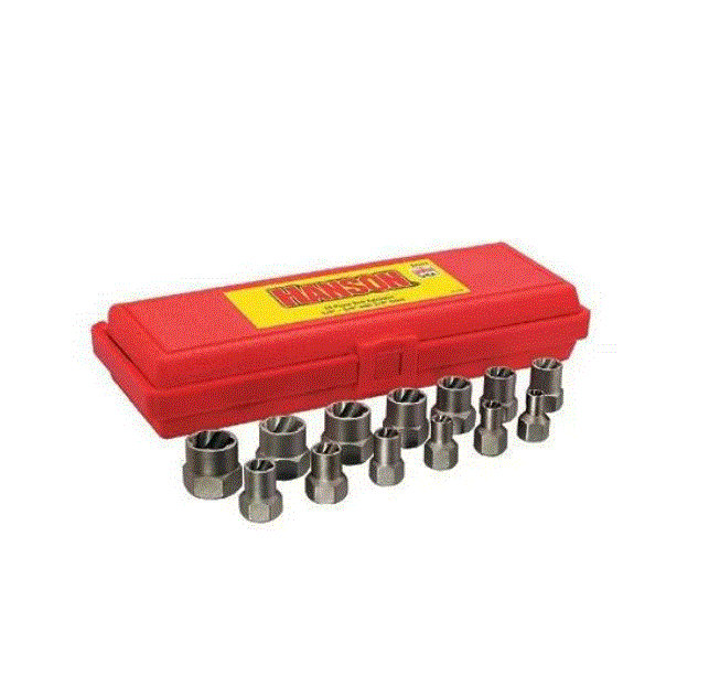

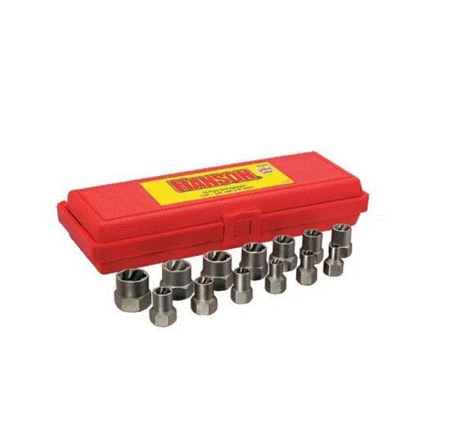

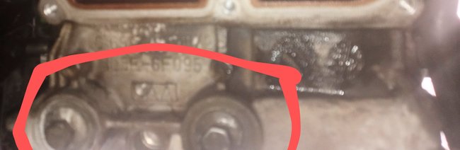

I cannot get this bolt out. It is stripped. l've tried multiple different extractors. Any advice?
Mar 17, 2021 at 4:20 PM
  • 110,190 POSTS
What kind of extractors have you used? I attached a pic below of the type I use. Did you try that style?
Mar 17, 2021 at 6:32 PM
ARIANADANIELLE5345
  • 399 POSTS
Yes I tried those. I ended up getting it by drilling through a socket to put an extractor in in it.

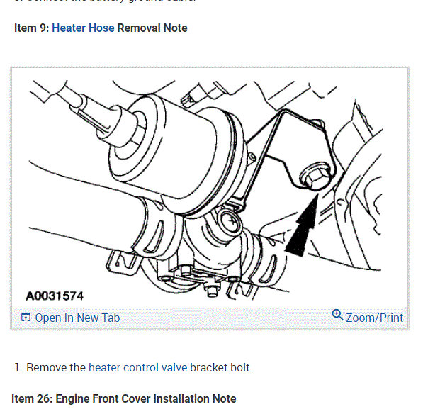

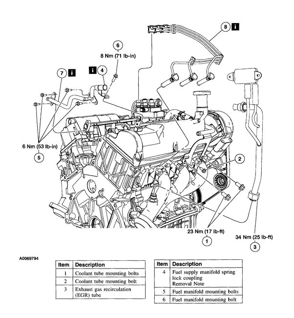

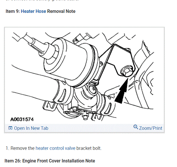

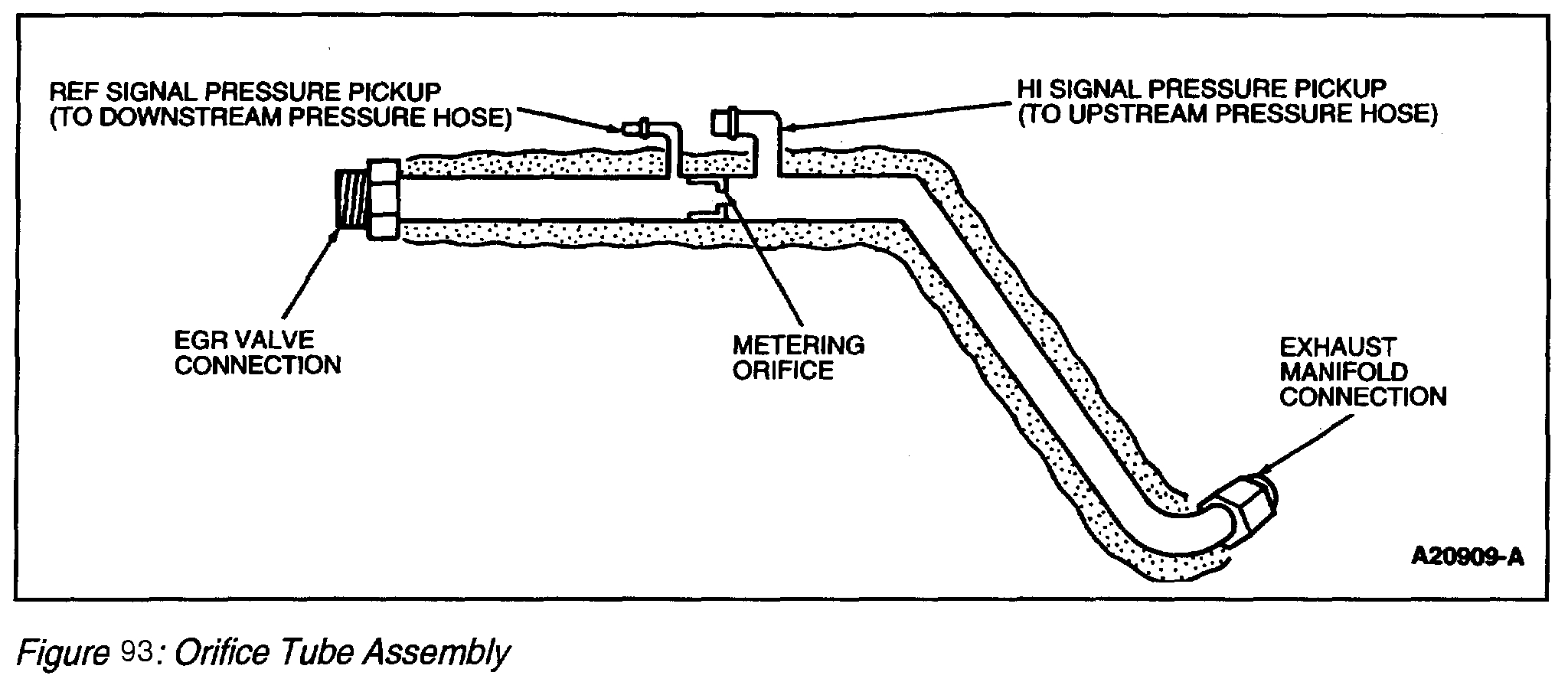

There's a curved tube from the EGR that goes into the upper intake. How do I get that out so i can take the intake off?
Mar 19, 2021 at 9:05 AM
  • 110,190 POSTS
Good job getting the bolt removed. They can be a pain. As far as the tube, I believe you are referring to the EGR tube that ties the intake and exhaust manifold. If you take a look at the pic below, you'll see it is screwed in at each end.
Take a look at the pic and let me know if it helps.

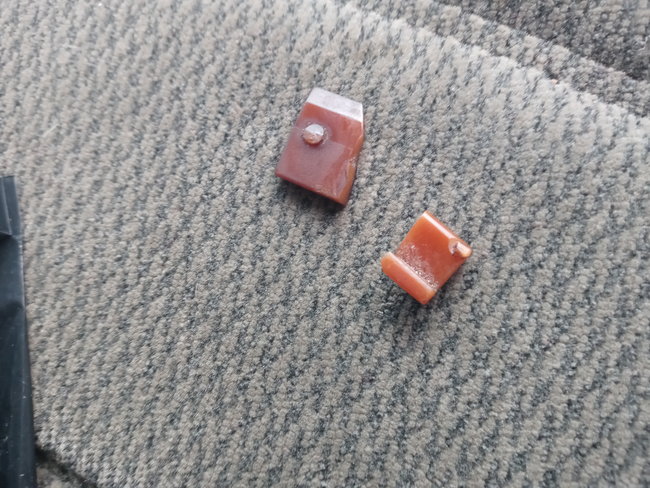

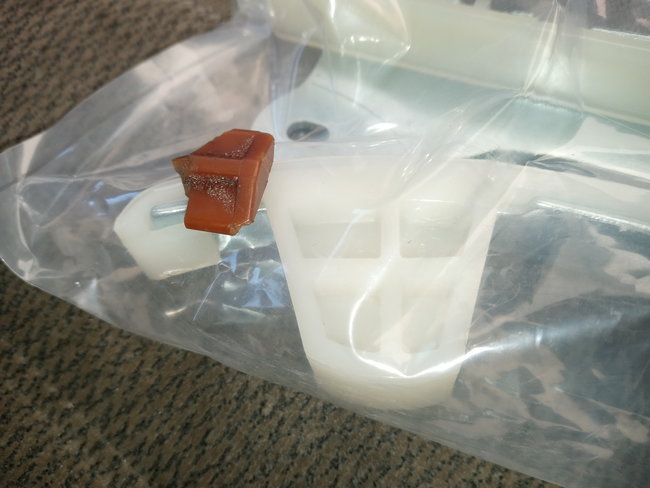

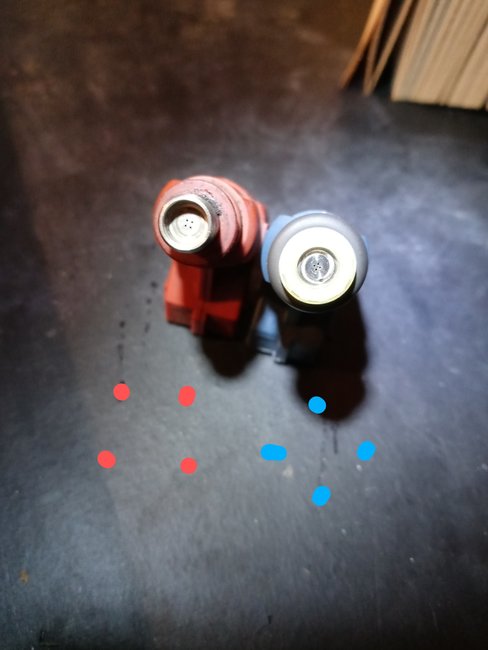

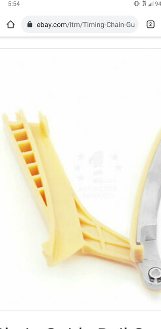

I ran into a couple more problems. The pintle cap on my injector cracked so i bought a new one but the holes are at a different angle. The part store took my old one to match it so I'm assuming its the right one. Does it matter that they're different? First one is original second is new. Also, found small pieces of what I think is my timing chain guide in my oil pan. There's no grinding noise or anything so do i have to replace he guide? If so, do i have to remove my engine?
Mar 22, 2021 at 5:40 PM
  • 110,190 POSTS
Did you save what was found in the pan? If you did, can you take a pic of it and upload it for me to see. As far as the injector, that doesn't sound right. If they used yours as a guide, didn't they notice the difference? Also, the engine doesn't need to be removed for a timing chain but send me the pic. If it is guide material, I will provide the directions. You will need to remove the radiator, but not the engine.
Mar 22, 2021 at 6:31 PM
ARIANADANIELLE5345
  • 399 POSTS
I would assume they would notice. After seeing the picture of the injectors, can you tell if I can use it or not? Here are the pieces from the oil pan:
Mar 22, 2021 at 7:56 PM
  • 110,190 POSTS
That is either from the guides or even could be from the gears. Some had a nylon covering. As far as the injector, it doesn't even appear as though it would fit. The diameter where it seats looks twice as big.
Let me know. Let me know if you want to replace the timing components as well.
Also, the OEM part number for the injector is 1L2Z9F593CA. See if the injector they provided crosses.

Yes, I am going to replace it. I bought a new one.

  • 399 POSTS
I meant the front or left for the timing chain guide. I bought a new guide.
Mar 26, 2021 at 8:16 PM
  • 110,190 POSTS
LOL, I was thinking of the fuel injector. The only thing you can do is take things apart until you see which one is bad.

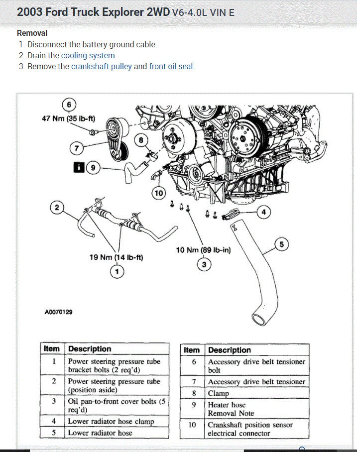

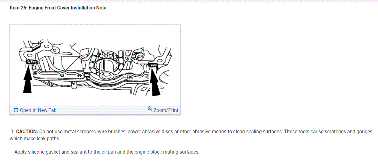

Okay, will do. I removed my radiator. What's next?
Mar 27, 2021 at 12:34 AM
ARIANADANIELLE5345
  • 399 POSTS

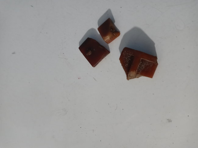

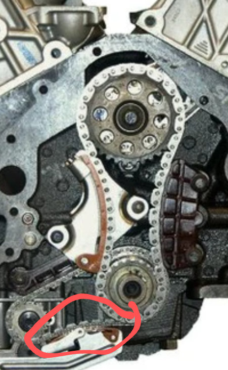

Although the more I look at the parts that I found in the pan the less clear their original placement becomes. In the new one and in all the pictures I've seen, the little square cutouts are deep. This one seems to be shallow.
Mar 27, 2021 at 11:08 AM

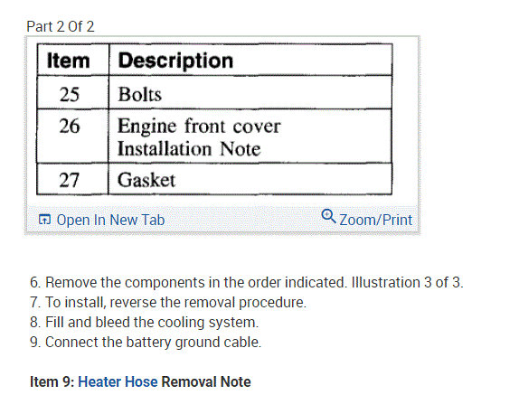

  • 110,190 POSTS

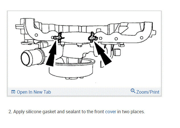

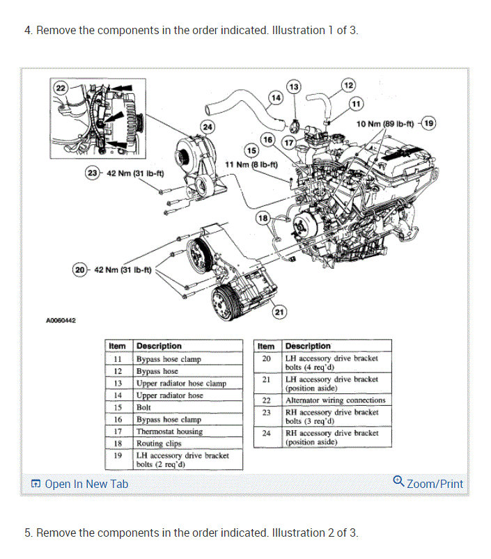

You need to remove the timing chain cover (front engine cover). If you look at the pics below, they are the directions.
Let me know if you need help.

I don't see anything that the broken pieces could belong to. That's bad news, right? Doesn't it mean my engine has to be removed because it's in the back? It looks like it belongs on here.
Apr 4, 2021 at 5:53 PM
  • 110,190 POSTS
That's odd. There is nothing that indicates a problem? As far as removing the engine, I don't see a need. I'm not sure what you mean by the back.

The rear chain guides. Don't you have to remove the engine to get to those?
Apr 5, 2021 at 6:44 AM
ARIANADANIELLE5345
  • 399 POSTS
Nevermind, i think i found it. The chain is incredibly loose right here and there's another broken off piece of plastic underneath it.
Apr 5, 2021 at 12:15 PM
  • 110,190 POSTS
That is yet another guide. It's very possible that is where it came from.
Let me know if you have questions.
