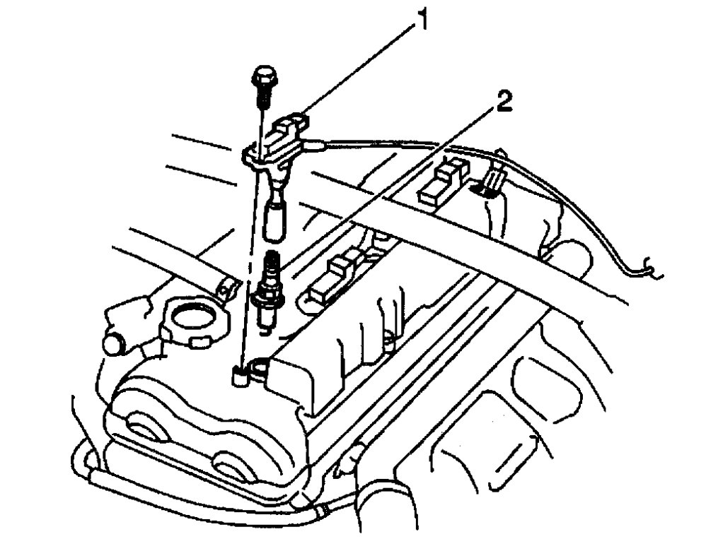

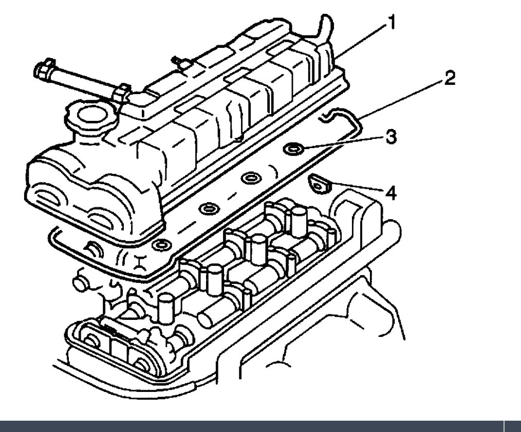

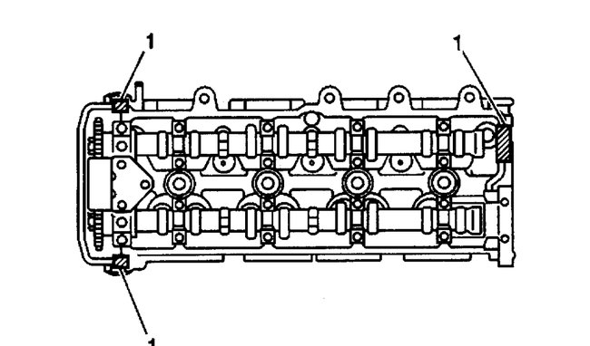

Everything has been removed holding the valve cover in place. Everything. Cover seems to be really stuck on. Tried tapping with a rubber mallet and applying a heat gun to the seal. Still stuck on real tight.

Sometimes you have to hit it pretty hard with the rubber mallet to get the seal to release. I would attempt it again.
https://www.2carpros.com/articles/replace-valve-cover-gasket
I attached the procedure for you below.
Removal Procedure
1. Disconnect the 4 ignition coils.
2. Remove the 4 ignition coils (1).
3. Remove the accelerator cable from the clip on the cylinder head cover.

8. Remove the cylinder head cover (1).
9. Remove the cylinder head cover gasket (2).
10. Remove the 4 O-rings (3).

2. Clean the sealing surfaces on the cylinder head cover and the cylinder head.
3. Apply GM P/N 12346240 or equivalent to the cylinder head at the points indicated (1).
4. Install the 4 new O-rings (3) to the cylinder head cover (1).
5. Install the new cylinder head cover gasket (2) to the cylinder head cover.
6. Install the new cylinder head side seal (4) to the cylinder head.
7. Install the cylinder head cover to the cylinder head.
