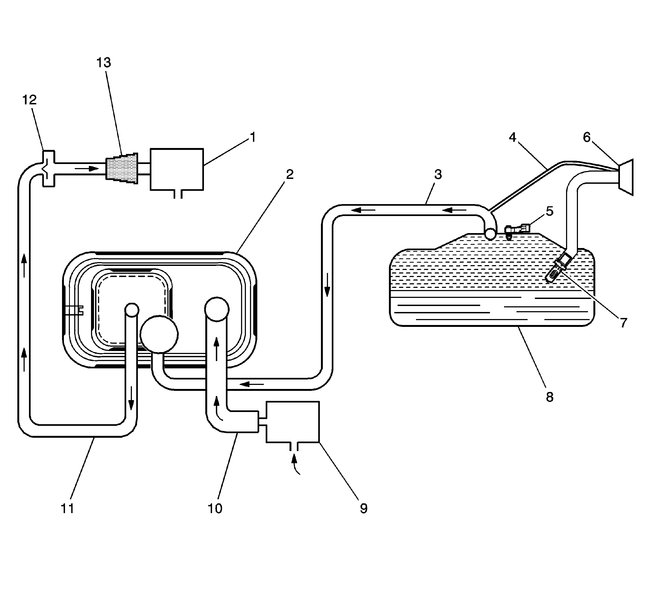

How do I get a vacuum line diagram for my truck listed above?
Thanks much.
Dec 29, 2018 at 11:35 AM
  • 110,244 POSTS
Hi Dale and thanks for using 2CarPros.
I have attached a picture of the EVAP system vacuum diagram. Also, I don't know if you are looking for a leak, but here is a link that describes how to find a vacuum leak:
Let me know if this helps.

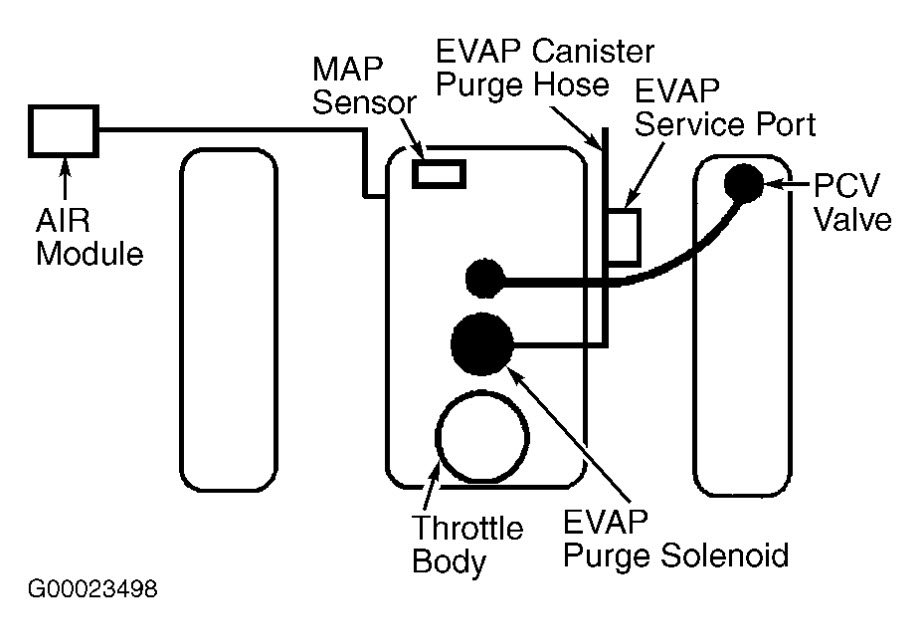

I need to know where the vacuum on front passenger side of intake goes. Any complete diagrams of the whole vacuums off the intake would be very helpful. I just changed my motor out and not sure if I have the vacuums hooked up right.
Dec 29, 2020 at 5:53 AM (Merged)
HMAC300
  • 48,601 POSTS
this is the only diagram we have and it covers from a 4.8L to 6.0L all the same. see picture.

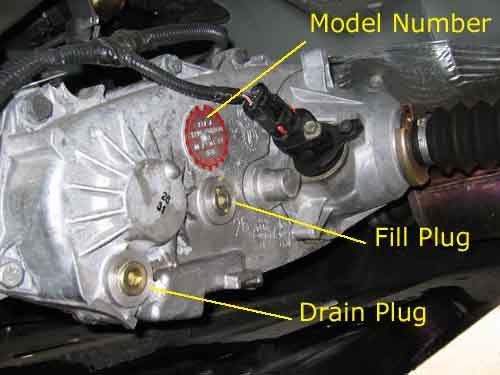

REALIST21
its a plastic elbow about a pencil eraser around and its on the transfer case
  • 110,244 POSTS
Check to see if it goes to the front axle.

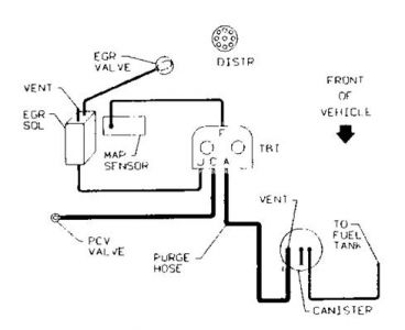

1989 Chevy Silverado V8 Two Wheel Drive Automatic
I need to find the correct assemble for the vacuum lines that conect to the fuel injected carborator. I have them hooked up but the engine is idleing to fast and when I put it into gear it stalls out.
JDL
  • 16,098 POSTS
this is for 5.0 calif automatic
https://images.2carpros.com/forum/automotive_pictures/170934_silverado_vacuum_lines_1.jpg

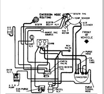

DOCFIXIT
  • 18,828 POSTS
Need the engine size here is one for Check out the diagrams (Below). Please let us know if you need anything else to get the problem fixed.5.0
https://images.2carpros.com/forum/automotive_pictures/198357_Grafic_3_26.jpg

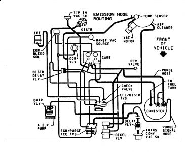

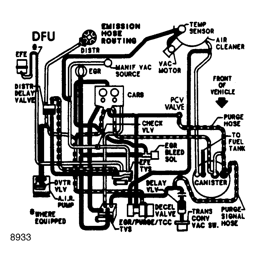

NUNOIT
Engine Performance problem
1986 Chevy Silverado V8 Four Wheel Drive Automatic
i have a 1986 suburban silverado there is no vacume digram under the hood. i want to hook the way it is supposed to go(cali or fed). 350 moter some vacum is connedted not all of it. from what i have found there is no ecm no cat(never was), 4 barrel carb egr ok engin is jasper air cleaner only has 1 hose connection for hot air moter. all vacum digrams welcome also proper air pump digram needed. thanks in advance joe
BLUELIGHTNIN6
  • 16,542 POSTS
what size engine? 5.0L, 5.7L etc.. gasoline or diesel?
JDL
  • 16,098 POSTS
https://images.2carpros.com/forum/automotive_pictures/170934_86_chevy_truck_1.jpg
Don't know if the above will work for you or not? Welcome to the forum.
NUNOIT
just a fue ? what is efe valve (heat riser), dtstr tvs (?) and is hose that connects to air cleaner (between vapor can and decel vav) just a bleed for vapor canianster, other than that i think i can make work. there is some weard valve that connects to vapor canister wonder what it is, has 4 ports 2 for vapor 2 for vac ill see if i can pix to post. also carb has bowl vent where does it connect. (pluged now) once again thanks joe
JDL
  • 16,098 POSTS
I believe tvs is thermal vacuum switch and efe is early fuel evaporation.

do you no what the rpo code for that digram
JDL
  • 16,098 POSTS
Hi, the autozone site has free diagrams. you have to register your vehicle, it's free. Then click on repair info. I believe the vav diagrams is under the emissions link. Wiring diagrams under chassis link.
