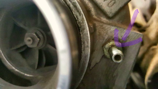

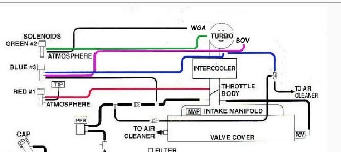

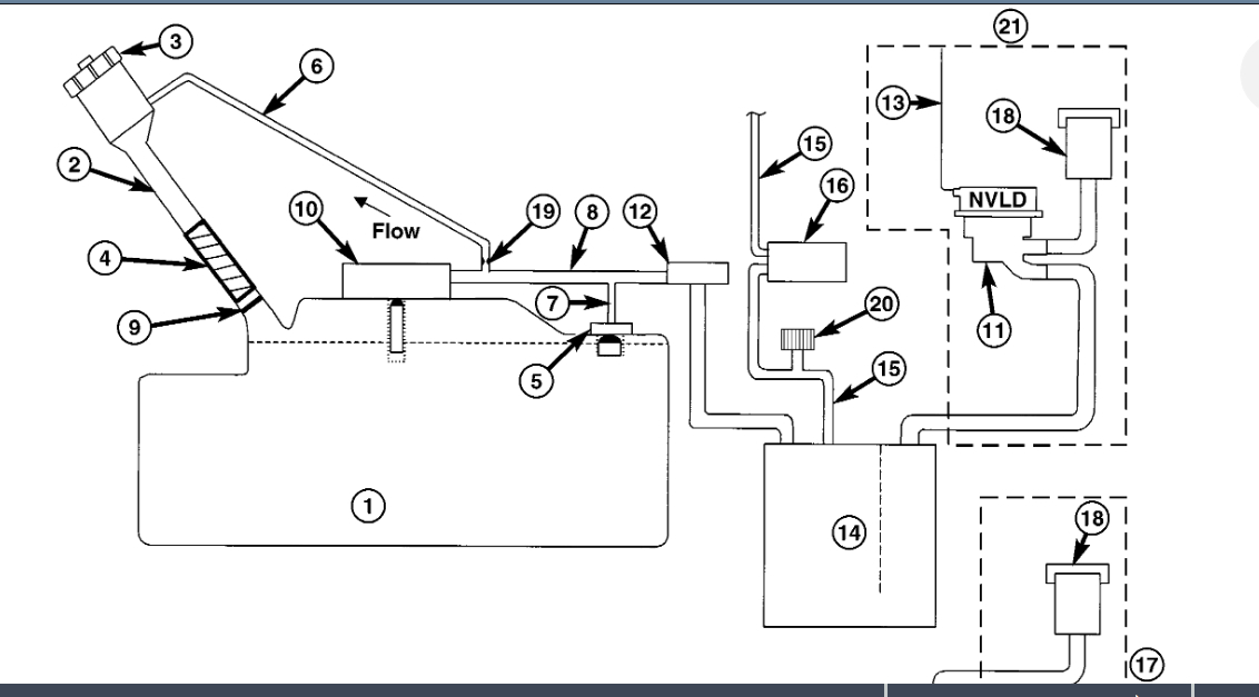

Had to change out turbo charger and forgot to label where these hoses went. can someone please help?

I have included the information that you requested in the diagrams down below. Please get back to us with what you are able to find out.

Had to replace turbocharger and friend forgot where the lines go leading off turbo and Waste-gate. can someone please provide a video and/or pictures of all vacuum lines and tubes of where they are located? please
Jan 25, 2021 at 1:36 PM (Merged)

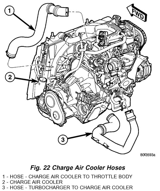

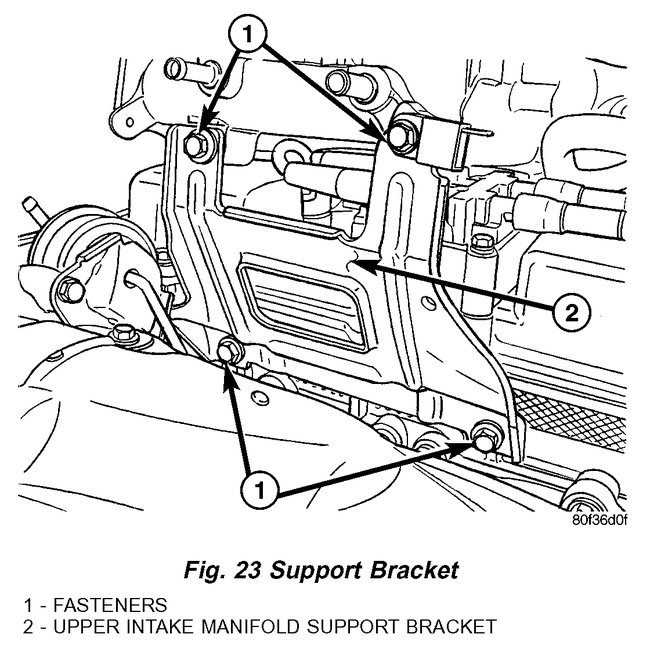

Here are the directions for removal and replacement of the turbo. I am including all pics which relate to the procedure. They show all lines and hoses.

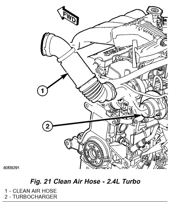

4. Disconnect clean air hose from turbocharger (Fig. 21).

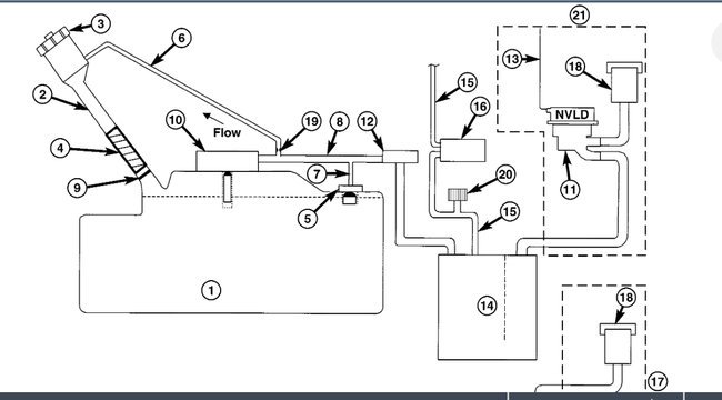

7. Disconnect air inlet hose at throttle body (Fig. 22).
8. Disconnect vacuum hoses at throttle body and upper intake manifold.
pic 3
9. Remove upper intake manifold support bracket (Fig. 23).

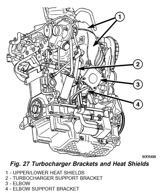

11. Remove turbocharger upper heat shield (Fig. 27).

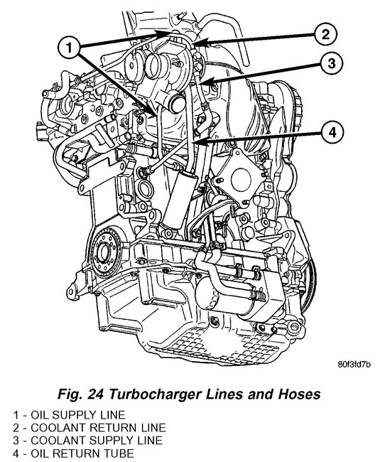

12. Disconnect oil supply line at turbocharger (Fig. 24).
13. Remove coolant return line (Fig. 24).
14. Disconnect vacuum hoses from turbocharger.

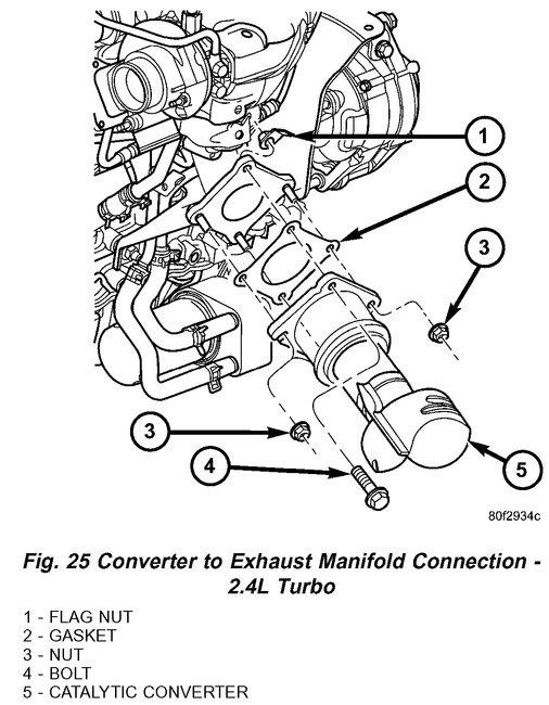

18. Remove fasteners securing catalytic converter to exhaust manifold (Fig. 25).
19. Remove catalytic converter and intermediate pipe as an assembly.

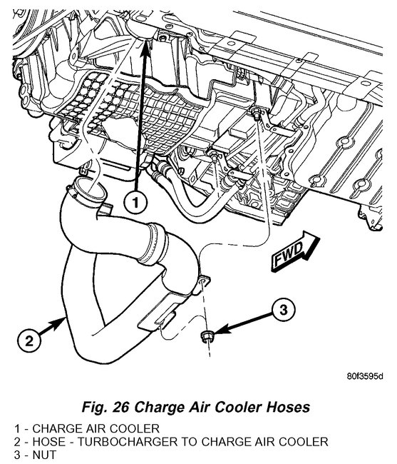

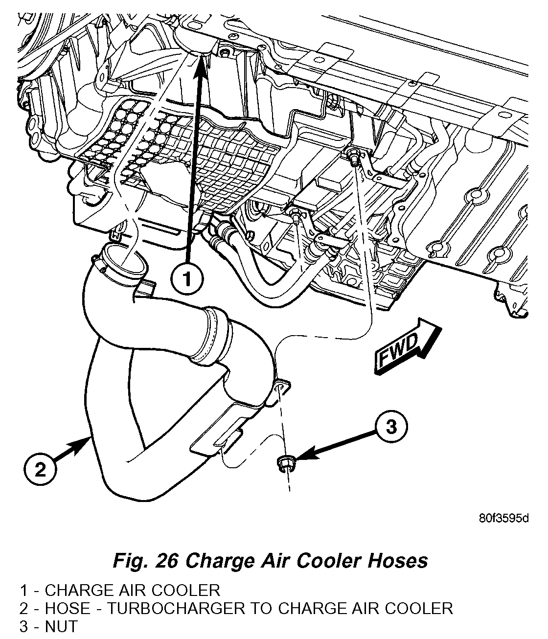

20. Remove turbocharger to charge air cooler hose assembly (Fig. 26).

23. Remove oil return tube (Fig. 24).
24. Remove turbocharger coolant supply line (Fig. 24).
25. Remove turbocharger lower heat shield (Fig. 27).
26. Remove turbocharger elbow (Fig. 27).

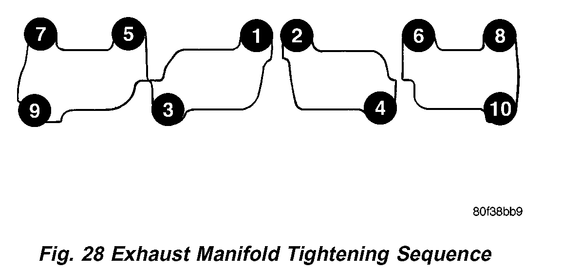

3. Position turbocharger/exhaust manifold assembly in place. Gradually tighten fasteners, starting at center and progressing outward in both directions to 28 Nm (250 in. lbs.) (Fig. 28). Raise and lower vehicle for fastener access as necessary Repeat tightening procedure until all fasteners are at specified torque.

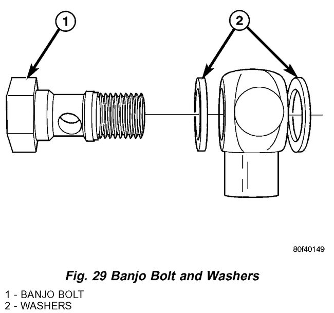

6. Install turbocharger coolant supply line. Install NEW washers (Fig. 29). Torque banjo fitting bolt to 30 Nm (22 ft. lbs.). Torque flared fitting to 31 Nm (23 ft. lbs.) (Fig. 24).
7. Replace oil return tube gasket. Install oil return tube. Torque fasteners to 12 Nm (105 in. lbs.). Make sure heat shield for oil return line is properly installed (Fig. 24).

10. Install turbocharger to charge air cooler hose assembly (Fig. 26).

12. Install fasteners securing catalytic converter to exhaust manifold (Fig. 25). Torque fasteners to 28 Nm (250 in. lbs.).

17. Install coolant return line. Install NEW washers (Fig. 29). Torque banjo fitting bolt to 30 Nm (22 ft. lbs.) (Fig. 24).
18. Connect oil supply line at turbocharger. Torque flared fitting to 31 Nm (23 ft. lbs.) (Fig. 24).

26. Connect clean air hose to turbocharger (Fig. 21).

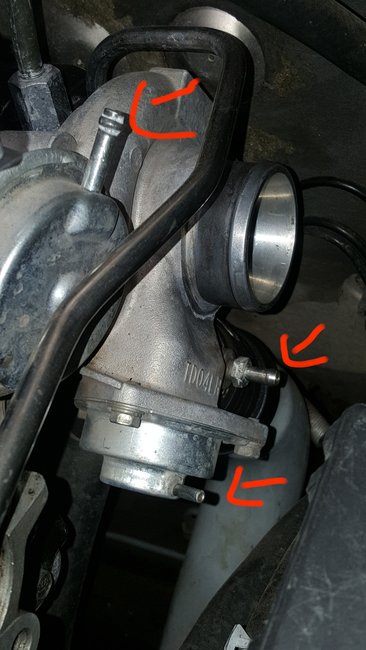

ANGEL DAVIS2

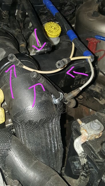

I am including some pictures can you please tell me where they are supposed to go.
  • 110,194 POSTS
Welcome back:
Honestly, without being there that is a tough one. Can you identify the ports in the pictures I attached?
ANGEL DAVIS2
The ports are coming off the turbo charger.
  • 110,194 POSTS
Welcome back:

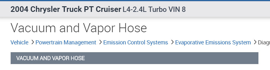

Please understand, I don't know where those vacuum hoses are running. Take a look at the attached picture and let me know if it helps.

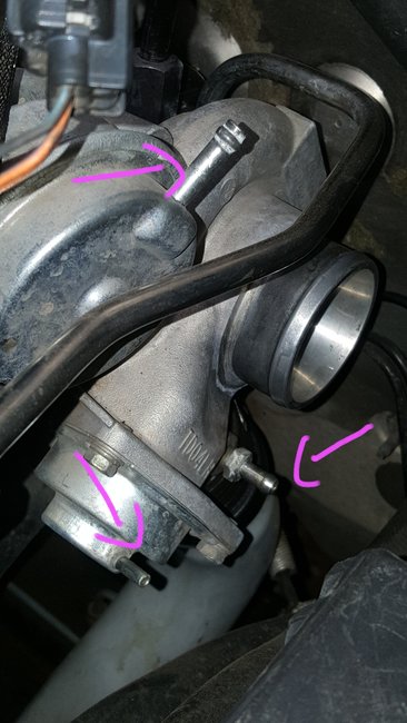

JAMES SAVOIE
  • 9 POSTS

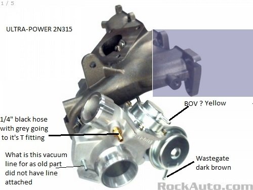

Hello Joe, can you match up the lines to the ports on this picture to which relay they go to, and their tubing colors, I used Paint app to markup picture.
I installed it turned over engine with spark plug wires out until I achieved oil pressure to ensure turbo bearings had sufficient oil before starting engine. The turbo has high pitch noise while driving. I put a vacuum cap on unknown port seemed to increase performance 90KM driven since installing, no tech support from Rock Auto and no Contact info for Ultra-Power Tech support.

How have things turned out with your plan?
Interested in knowing.
