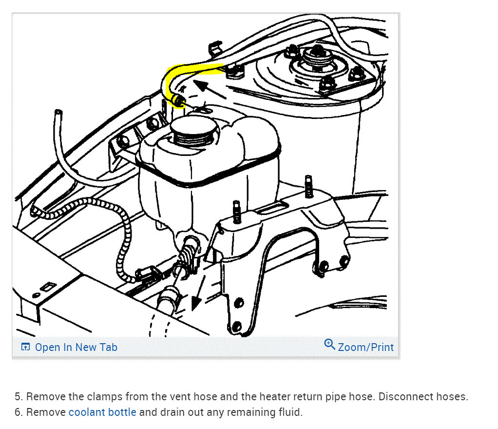

The upper radiator hose is collapsing as the car cools
1999 SATURN SL2
120,000 MILES • 1.9L • 4 CYL • 2WD • AUTOMATIC
DAVIDKRISS
  • 17 POSTS
I’ve replaced the radiator cap with the exact factory replacement, completed a coolant flush and there doesn’t appear to be any blockages, replaced the overflow hose, done a block test that came back negative… I’m at a loss. What could be causing the collapse?
Jul 6, 2022 at 1:17 PM
  • 110,194 POSTS
When the engine cools, the radiator cap is what allows excess coolant from the overflow reservoir to return to the radiator. If the cap is new, check the heater return/vent hose to the reservoir to see if something is blocking it or if it is pinched closed. See pic below It's the top hose. That is where I would think there could be a restriction, but again, the cap is what should allow the negative pressure to be released.

Hi Joe,
Thank you so much for your response. I’m on cap #3. The second one I got was only rated at 16 PSI and the required PSI for this Saturn is 18… the radiator hose collapsed with both of those new caps.
I replaced the top hose you called out in the diagram, and it didn’t remedy the radiator hose collapse issue.
