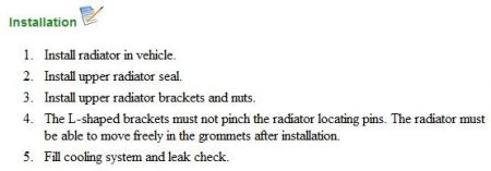

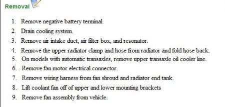

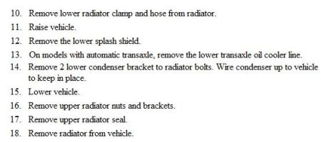

How do I change the radiator in my SL2 Saturn 2000? How much time will it take? and about how much will it cost for a new or used radiator?
Jun 3, 2010 at 5:15 AM
BLUELIGHTNIN6
Experienced Mechanic
16,542 POSTS
brand new radiator with limited lifetime warranty costs around $100. will take approx. 1 1/2 labor hours to replace at an experienced shop.
