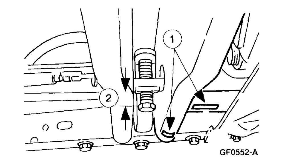

Got another question. How do you go about replacing the lower control arms? I noticed my torsion bars run into them. Seems more complicated than the uppers. Anyone have a repair guide for this? Thanks.

Procedure below for you.
Removal
1. Remove the wheel hub.
2. Make preliminary adjustment references.

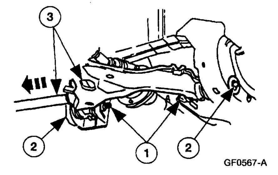

1. Make an alignment mark on the torsion bar and the torsion bar crossmember support.
2. Measure and record the length.

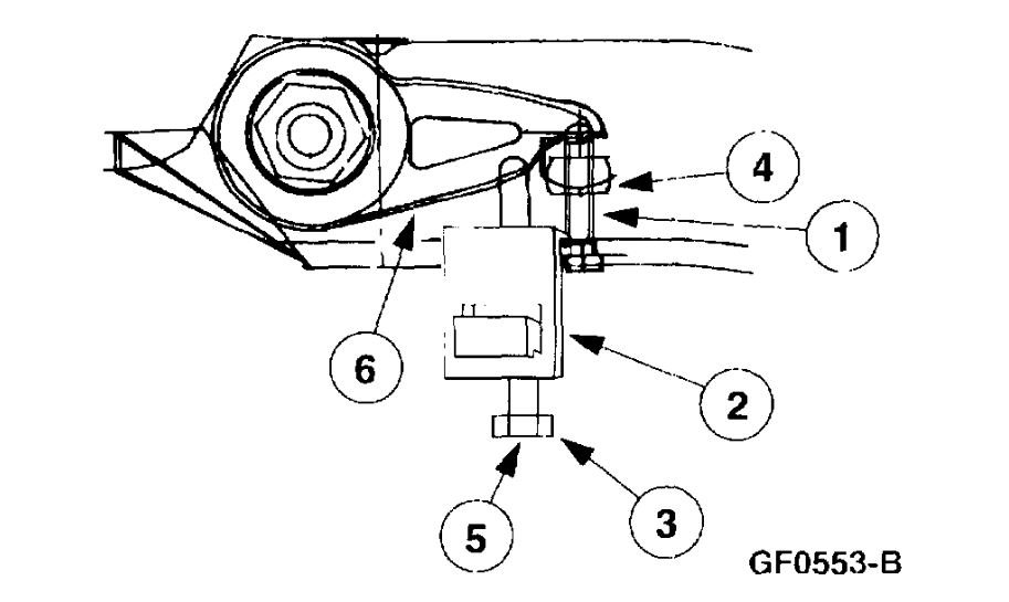

3. Relieve the torsion bar tension.
1. Remove the torsion bar adjuster bolt.
2. Install the Torsion Bar Tool with the Torsion Bar Tool Adapters in the B slots on the Torsion Bar Tool.
3. Tighten the Torsion Bar Tool until the torsion bar adjuster lifts off of the adjuster nut.
4. Remove the torsion bar adjuster nut.
5. Remove the Torsion Bar Tool.
6. Remove the torsion bar adjuster.

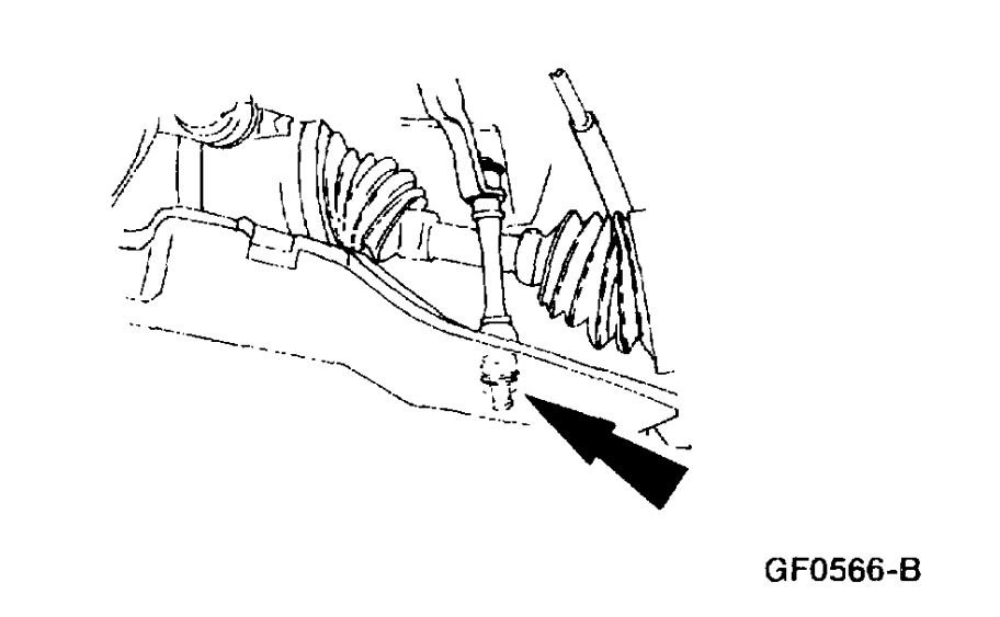

4. Remove the stabilizer bar link nut from the front suspension lower arm.

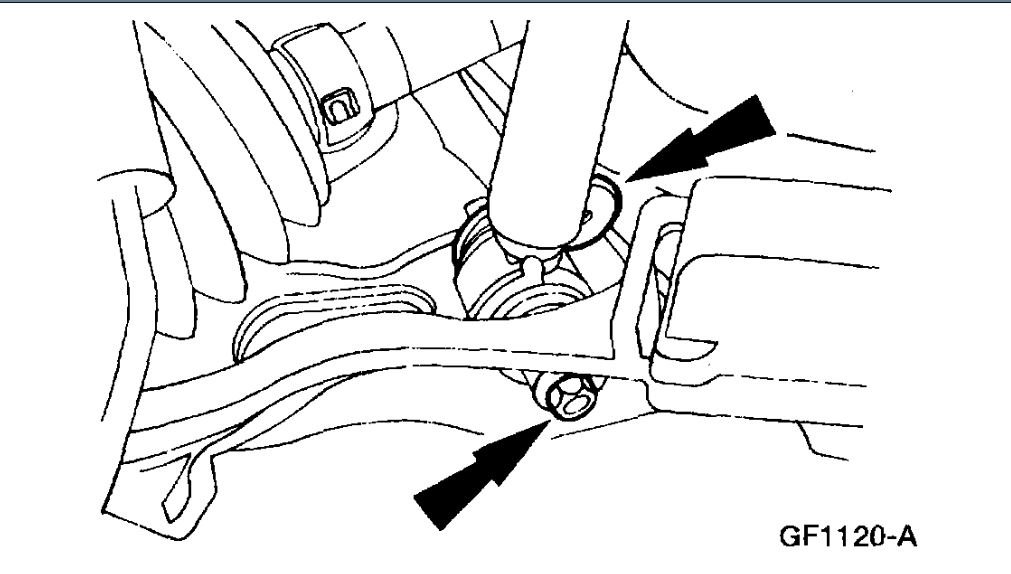

5. Remove the front shock absorber lower bolt and nut from the front suspension lower arm.

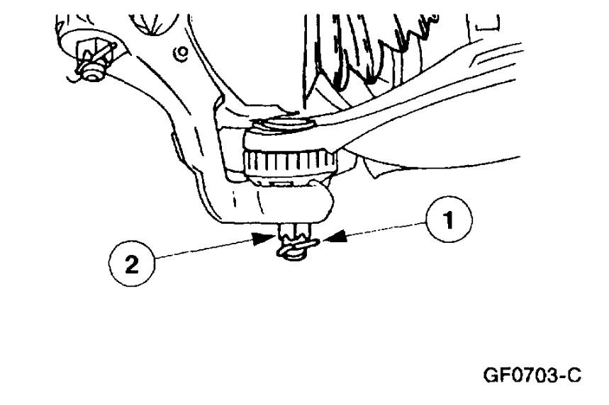

6. Remove the lower ball joint castle nut.
1. Remove and discard the cotter pin.
2. Remove the lower ball joint castle nut.

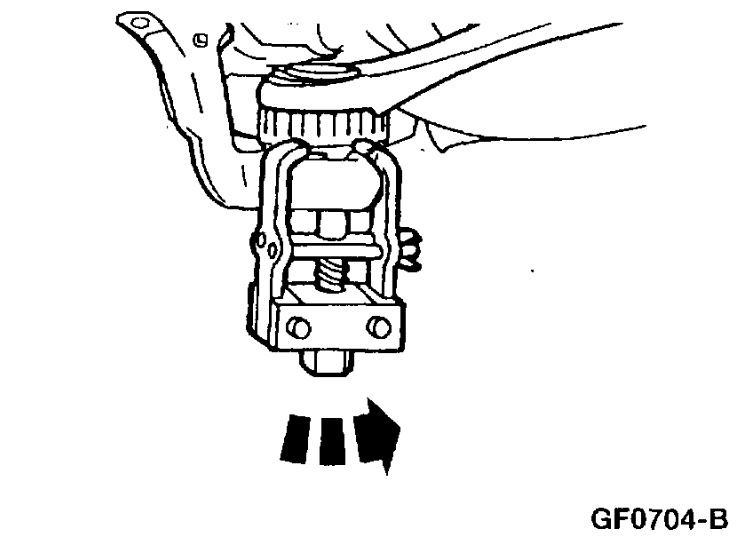

7. Using the Pitman Arm Puller, separate the front suspension lower arm from the front wheel knuckle.
- Separate the front suspension lower arm from the front wheel knuckle.
8. Remove the front suspension lower arm.
1. Remove the two front suspension lower arm nuts.
2. Remove the two front suspension lower arm bolts.
3. Remove the front suspension lower arm and torsion bar as an assembly.
9. Separate the front suspension lower arm from the torsion bar.
Jul 11, 2019 at 7:10 PM

So I have to go buy a torsion bar tool and The adapters before I can even change the lowers?
Jul 12, 2019 at 12:56 PM
You can do it without the tools but it will be much harder. You will need a tuning fork to release the ball joint. The torsion bar will be difficult to remove once you release all the tension without the tool. It pulls straight back buts gets stuck from age.
