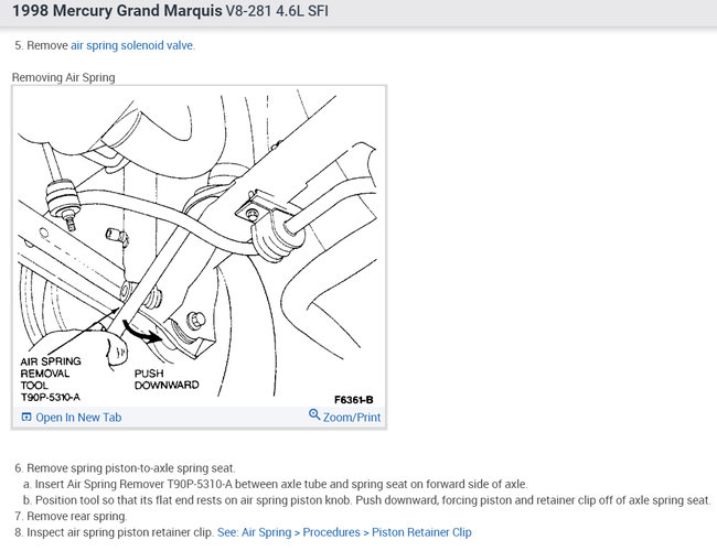

So I am having the pretty typical rear air suspension on my car. The air suspension light came on the dash, and within days it began losing air. I was told of a quick fix that supposedly works all the time where I would disconnect the hose from the compressor, and then use my shop air compressor to temporarily fill the rear air bags before cutting off the switch as a temporary solution. Except the rear end never inflated. Maybe the solenoids are not opening due to some other reason? I am so very lost now.

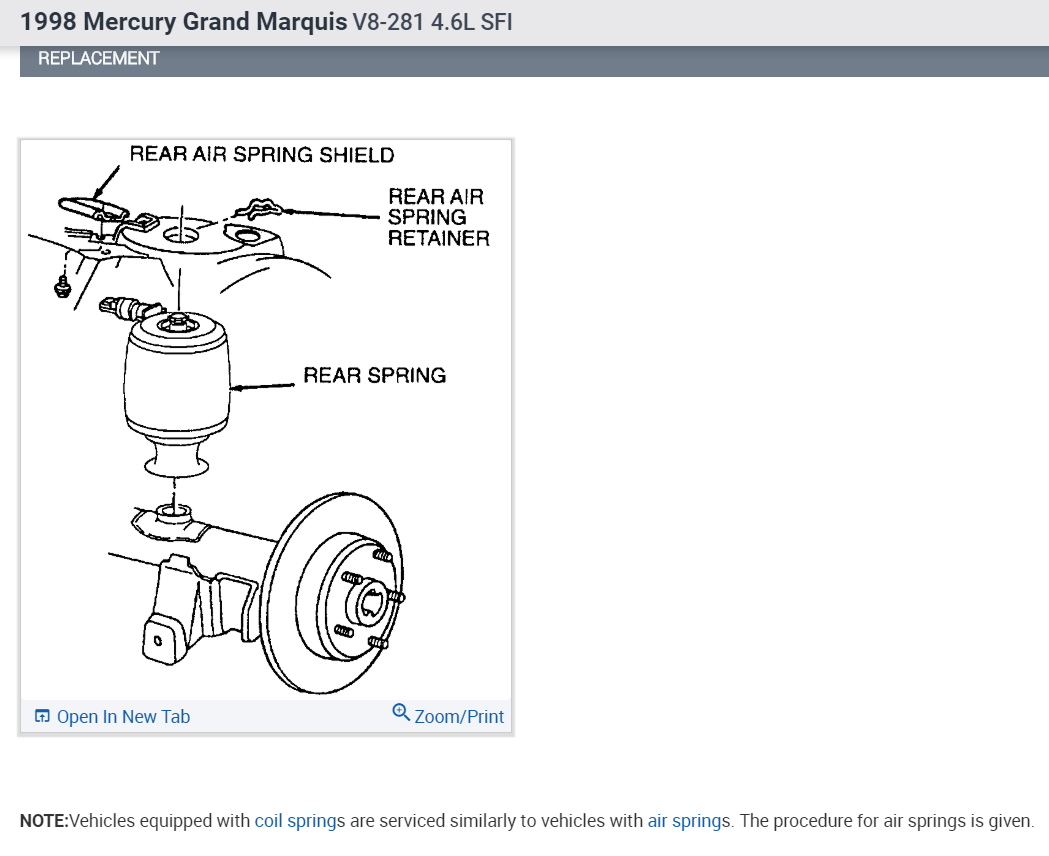

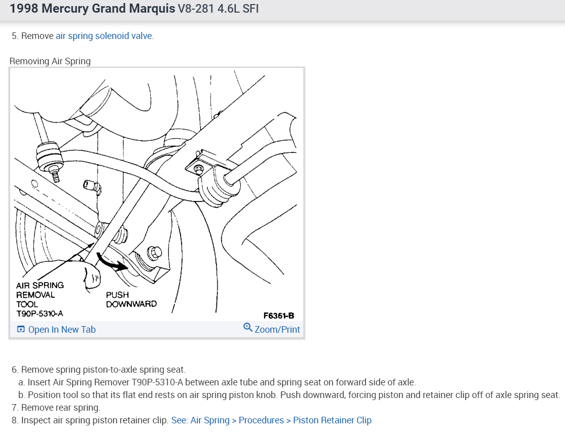

9 times out of 10 the air shocks are leaking causing the issue here is how you replace them. Check out the diagrams (Below). Please let us know if you need anything else to get the problem fixed.
