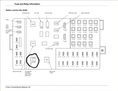

I just had my rear tires changed at a local dealer.
Before starting the work, he turned off the air suspension switch located in the trunk of the car.
Everything was operating correctly going home.
The next morning I drove my car. While driving, it felt like I was in the old U.S. army jeep. The suspension was locked. So, I stopped to see if the suspension switch was turned back on, it was. My question is, how do I release my suspension to make it operate normally?
Jan 27, 2010 at 4:31 AM
MATHIASO
  • 1,209 POSTS
Hello mlewis3498 Welcome to 2carpros.com locate the air suspension relay in the battery junction box and replace,it may take care of the problem. (check your email for this diagram)
