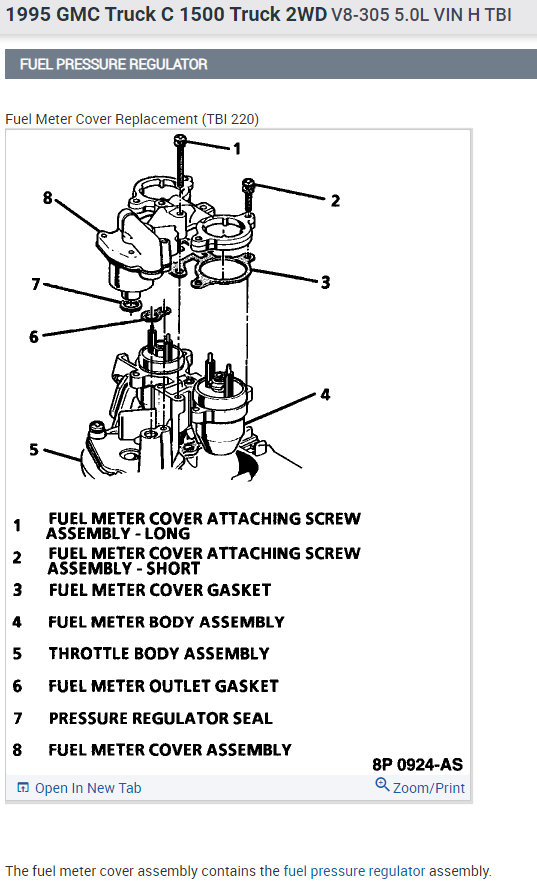

I can turn the engine over but want start . It has spark , fuel pump is working and new inline fuel filter . Also put new fuses in . Also new distributor cap and rotary button. Spark plugs and wires . I had friend turn it over and I see no gas in carburetor. I can pour gas in carburetor and it cranks and runs as long as gas is being poured in slowly. As soon as I stop pouring it in it shuts off. What do I do now?

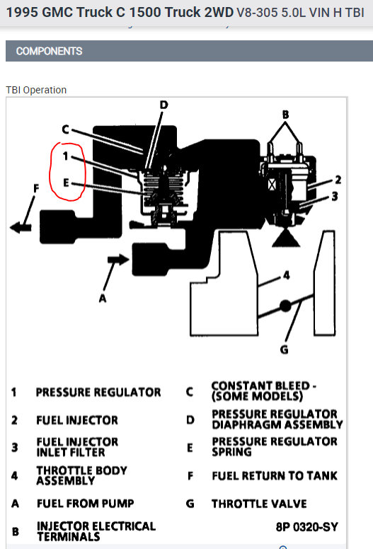

It sounds like the engine is not getting fuel.
As you mentioned the pump is good, it could be the cause of a faulty fuel pressure regulator or a clog in the fuel line.
Check to see if you are getting adequate fuel pressure.
Another possibility, this pump has a pulsator, the pulsator is a flexible connector between the pump and the metal fuel line in the tank. If there is a rupture in that line you will have no fuel pressure. You will hear the pump come on but it will not produce any pressure.
The pulsator tends to rupture is there are excessive amount of ethanol in the gasoline.
First step would be get the pressure checked.
https://youtu.be/aITQclp7zIE
If you have low to no pressure check the regulator. If the regulator is good then it could be the pulsator.
