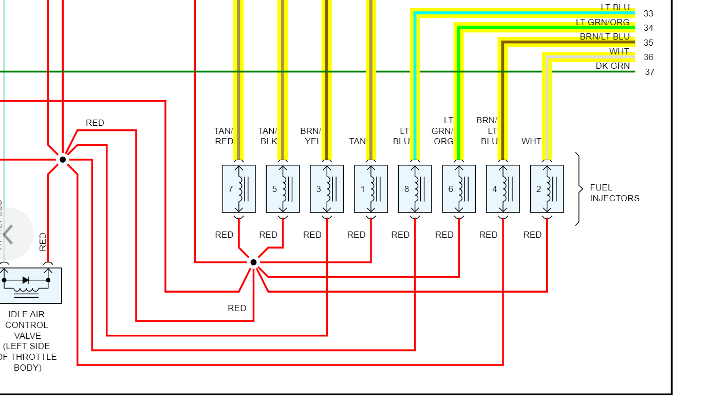

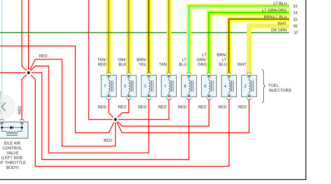

If you have an automotive 12volt test light, you can also check the Fuel injector control from the engine computer. You'll notice that the fuel injectors all have a red wire (power feed) and a different colored wire on each one. If you hook a test light to battery positive and back probe the fuel injector connector on the odd colored wire (not the red wire) and crank the vehicle you should see the test light flashing, sometimes it's not an extreme flash but it will flash and that's the computer controlling the fuel injector. These are Ground side switched fuel injectors.

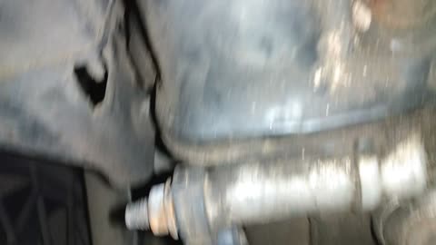

Here is the video and injectors are good. i have tried using starting fluid, but no spark means no start.

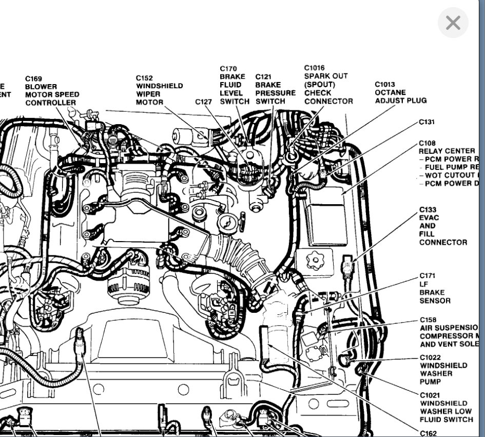

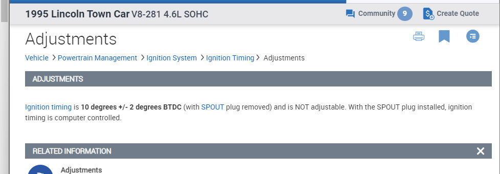

Just to jump in on this part. The timing on this engine is not adjustable. This is PCM controlled and set to 10 BTDC. I attached the info from the manual that states this.
Basically, you can unplug the SPOUT connector and check the timing, but you can't adjust it if it is wrong. I attached a location of this below if you would like to do this.
