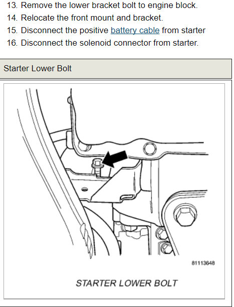

Turned key twice car had power and would not start. Third time it turns over. I drive for it a week and it is running normally. Today I start it, drive to station, and the same thing but not turning or clicking at all.
Feb 3, 2018 at 2:16 AM
  • 55,802 POSTS

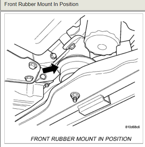

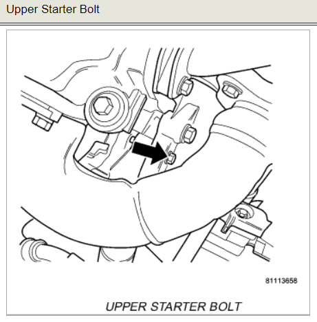

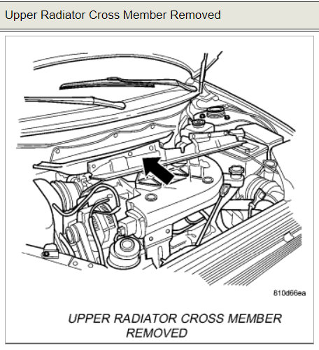

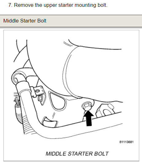

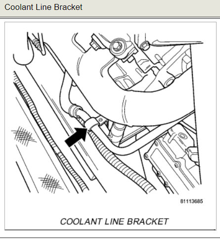

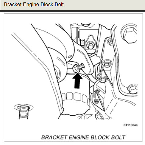

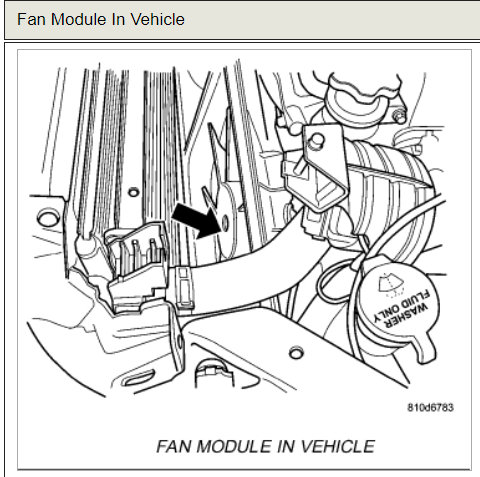

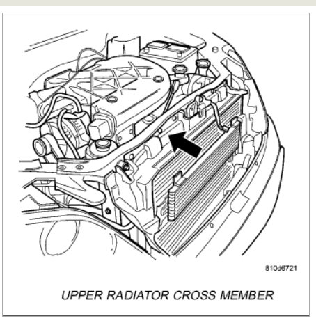

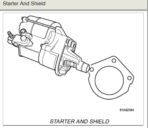

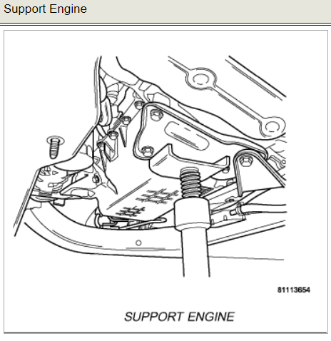

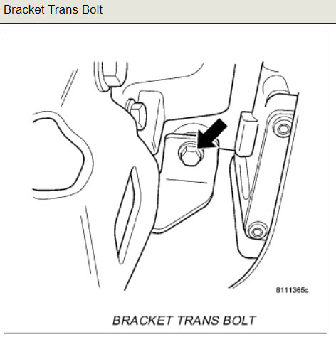

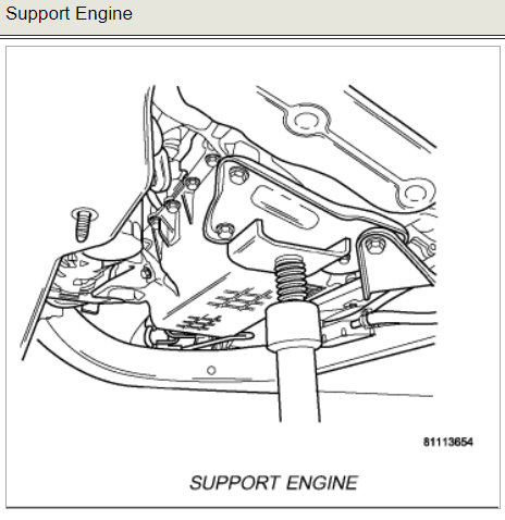

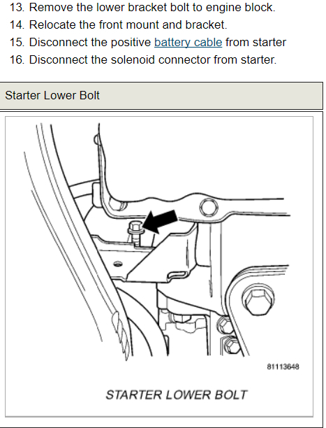

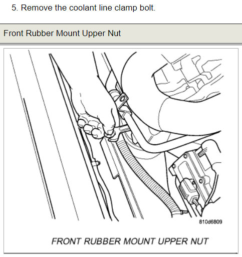

It sounds like you have a bad starter motor or a bad connection at the battery. Here is a guide to help you see what you are in for when fixing the problem:
and
Below is how it will be to replace the starter in your car.
