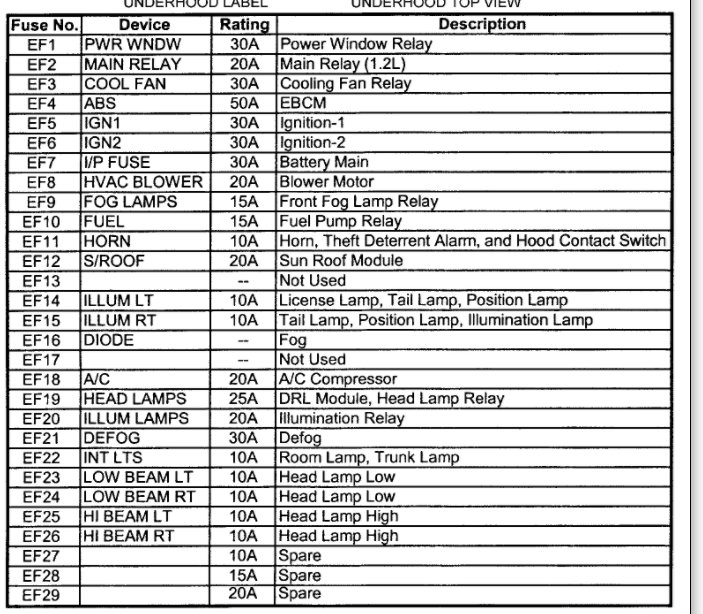

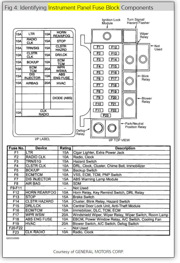

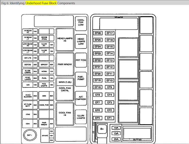

Hello and welcome.
Let start by checking for power at fuse #17 20 amp this should tell us which way to go. I know you checked the fuse but I need to know if there is power there.
Here is a guide:
Check out the fuse panel diagrams (below).
