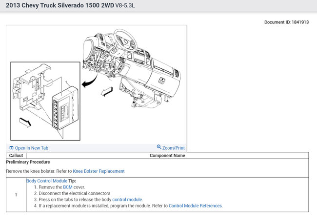

The left turn signal stays on until you switch it to the right side, it doesn't work either. I changed out the turn signal switch it lasted a couple of days and went back to doing the same thing.

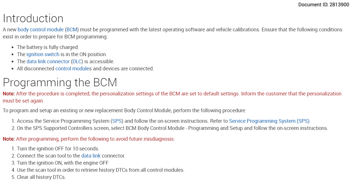

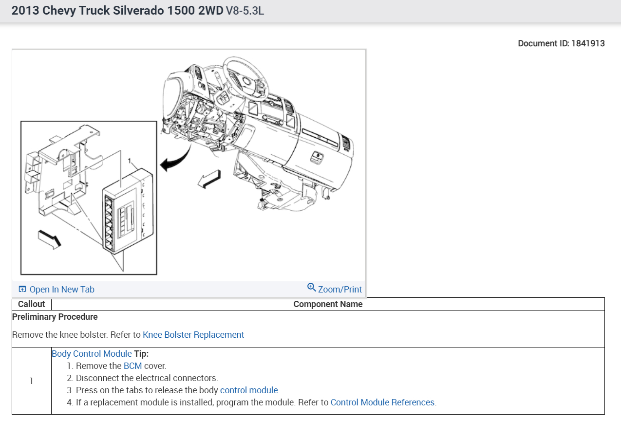

The turn signals are controlled by the BCM which sounds like it is going out. Here is a guide to help you do a CAN scan to confirm the problem and I have included how to change the BCM out, you can get a preprogrammed unit by searching Google or Ebay.
You can get a CAN scanner (Controller Area Network) which will work on most cars from Amazon.
https://youtu.be/u-4syLc-ifQ
And this can help as well:
https://www.2carpros.com/articles/how-to-replace-a-bcm-body-control-module
Check out the images (below). Please upload pictures or videos of the problem so we can see what's going on.
