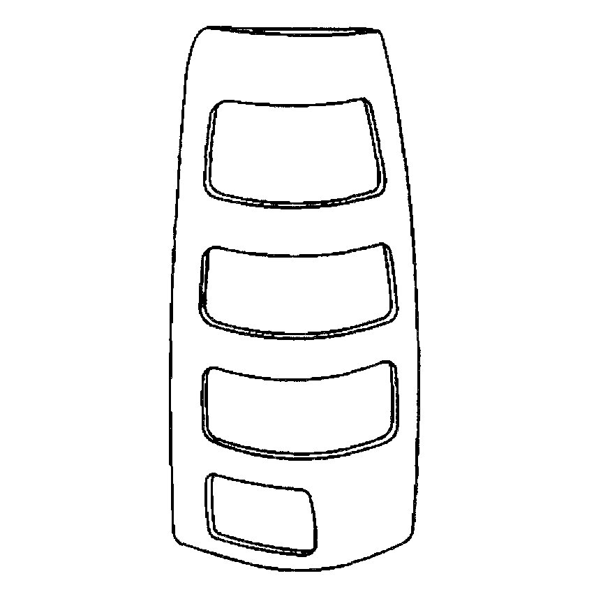

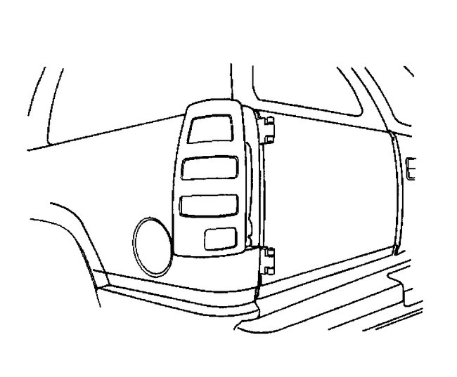

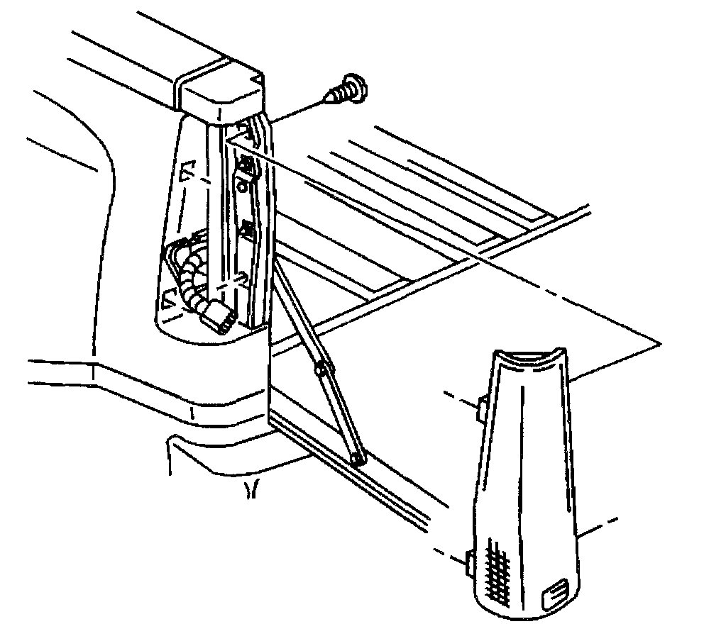

Here are the directions for replacement on your vehicle. The attached pictures correlate with these directions.
________________________________________________________
TAIL/TURN SIGNAL LAMP REPLACEMENT
REMOVAL PROCEDURE
1. Make sure the headlamp switch is in the OFF position.
2. Lower the endgate or open the cargo doors.
IMPORTANT: Z-71 Tahoes have a rear tail lamp cover. Once the cover is installed removal will result in breakage of the cover.
3. Remove the 2 screws retaining the tail/turn signal lamp assembly to the body.
4. Rotate the tail/turn signal lamp assembly from the vehicle.
5. Disconnect the electrical connector from the assembly.
6. Identify the bulb in need of replacement.
- The top bulb is a parking lamp.
- The center bulb is a parking, brake, and turn indicator lamp.
- The lower bulb is a backup lamp.
7. Pull the bulb straight out by the tabs on the base of the bulb in order to remove the bulb.
INSTALLATION PROCEDURE
1. Push the bulb straight into the lamp assembly in order to install the bulb.
2. Install the lamp base to the lens assembly with the 2 screws.
3. Connect the electrical connector.
4. Install the tail/turn signal lamp assembly to the vehicle with the 2 screws.

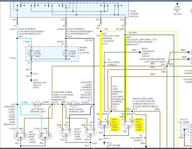

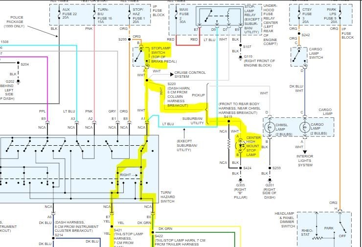

Since the third brake light has always worked, that is a good indicator that there is power to the switch and the switch is good. Now, I attached two pics below. When you look at the first one, I highlighted the power flow direction from the fuse, through the switch, and then to the third brake light (which works) and you'll note the same white wire goes into the hazard/ signal switch. I continued highlighting through the switch and you will see at the bottom, two wires come out which are highlighted. Those go to the rear brake lights.
Based on what you are experiencing, my first suspect is the signal / hazard switch has failed. Power to the third brake light doesn't travel through the switch, but for the two rear tail lights (brake lights) it does. That would explain why one works and not the other.
Since all other lights work, most likely it isn't a ground issue because they all have a common ground. So, what I need you to do is this. First, simply check for power going into the switch (the white wire). Do this when you actuate the brake light switch. If power is present, then you need to check for power out (one wire is dark green and the other is yellow). If there is no power out, replace the switch. If there is power out, then you have an open circuit between the switch and the lights, which is not possible because the flashers and signals work.
With all that, there is most likely only one of two things. Either power isn't making it to the hazard / signal switch via the brake light switch or the signal switch is bad.
If you look at the second pic, you will see where the power comes out of the signal switch and directly to the rear bulbs.
Let me know if this helps or if you have questions. Also, sorry for the sloppy highlighting job.
