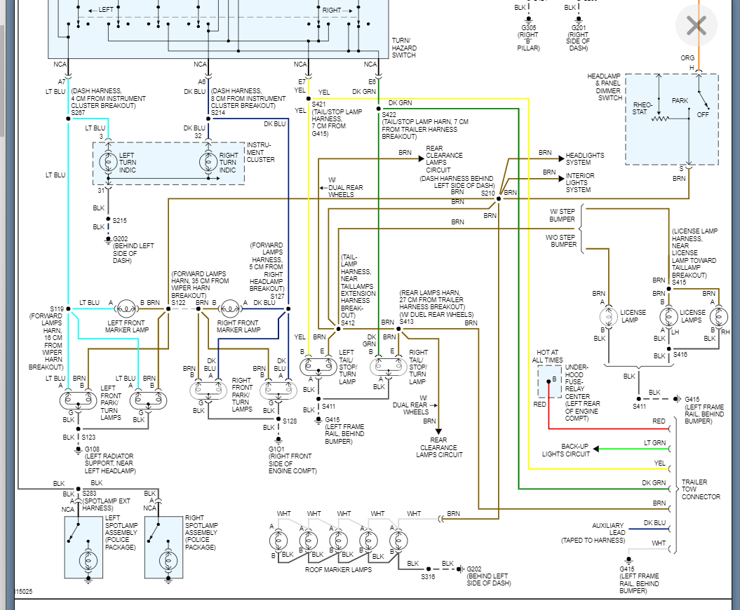

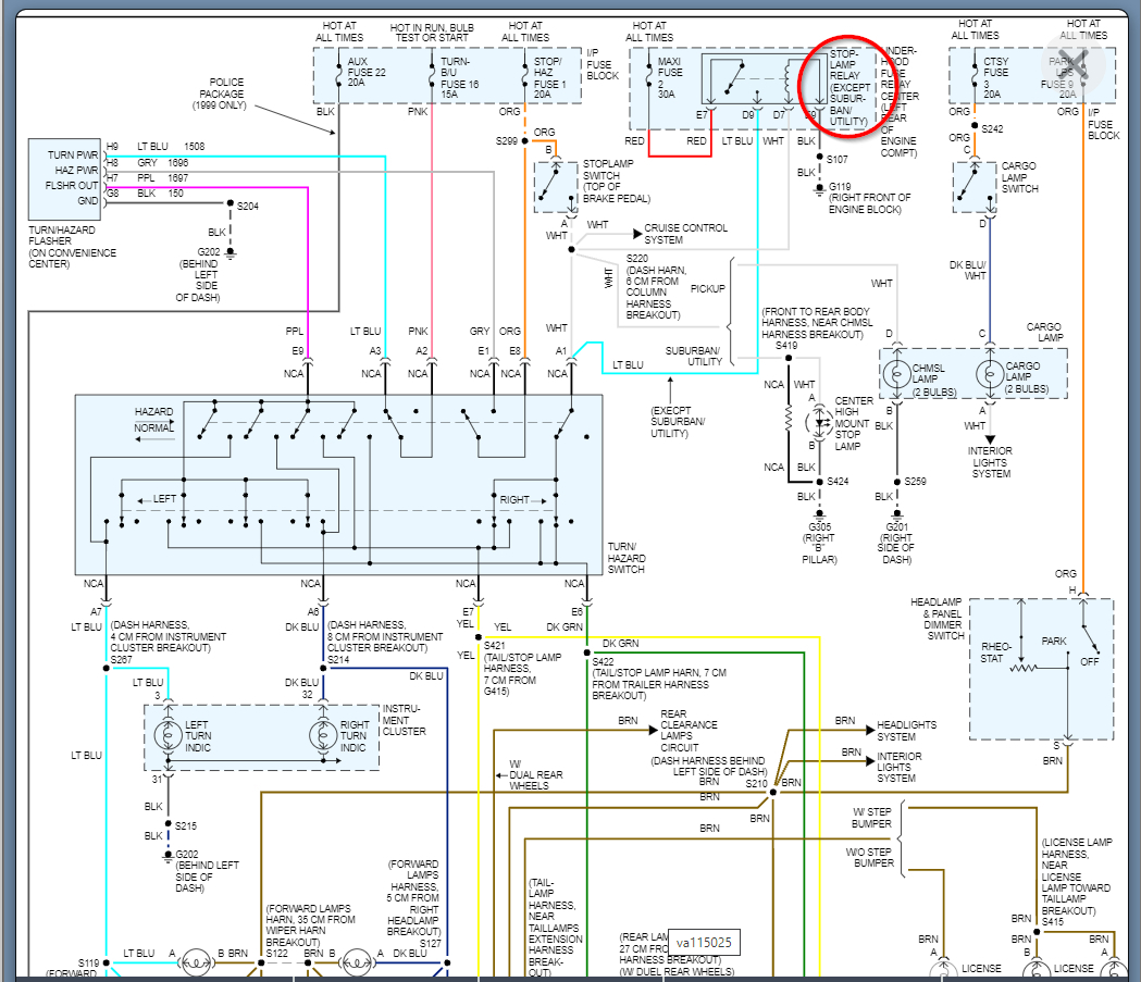

the brake relay is not in relay box under hood, where is it located
Mar 23, 2010 at 12:40 PM
The SUV does not have a relay for the brake lights, only the pickup trucks.
https://www.2carpros.com/articles/brake-lights-not-working
I am assuming you have an issue with the brake lights so I am attaching the wiring diagram plus here is a guide that will help with testing for voltage:
If the lights are not working, then check the stop lamp switch.
See the diagrams below and let us know what other info you need. Thanks
