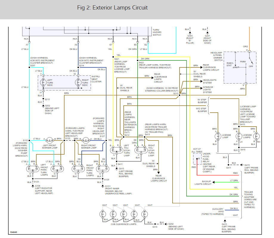

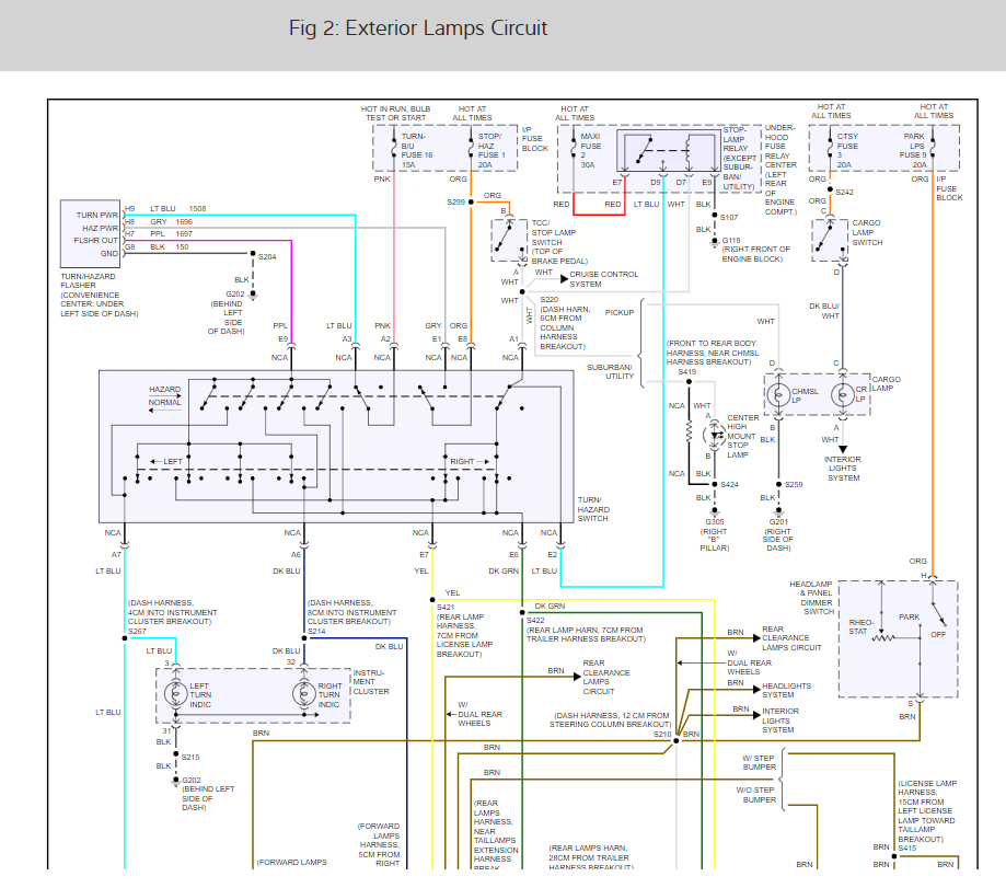

Welcome to the forum, I'd check the feed to and from the brake switch. Orange wire is hot all the time. White wire goes hot when you activate the brake switch. The high-mount lite is wired differently than the others. Here is the wiring diagrams so you can see how it works with a guide to help you check for power.
Check out the diagrams (Below). Please let us know what you find. We are interested to see what it is.

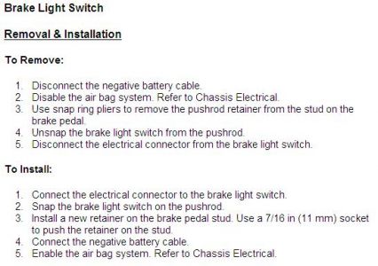

thanks. Are there any helpful hints or advice on replacing the brake switch. I have tried to wedge myself under there a month or two ago and it seems impossible to get that thing off or even get to it. Do i need to find a 10 year old to do the work?
My hands seem too big. haha
Dec 15, 2009 at 7:56 AM
JDL
  • 16,098 POSTS
I found this, don't know if it will help? I don't like to work under dashes.
https://images.2carpros.com/forum/automotive_pictures/170934_brake_light_swich_1.jpg

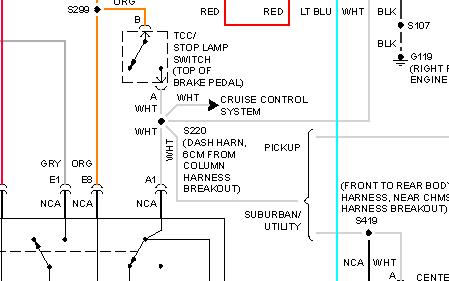

Yeah, you can look for power at the trailer connection. I'm going to track the splices on the brake circuit.
Dec 29, 2009 at 7:35 AM
JDL
  • 16,098 POSTS
You see splice S220 in the picture, I'd have to track the white wire and check for voltage.

Check the white wire going to the connector for voltage with the brake switch activated. If there is more than one white wire, I don't know which one?
If no voltage on the proper white wire, brake activated, you'll have to backtrack the white wire. You could take the connector loose at both ends, make sure it is the correct circuit, do an ohms test, check for continuity, no continuity, there is an open circuit. All repair info says to disarm airbag, where applicable, when working under the dash.

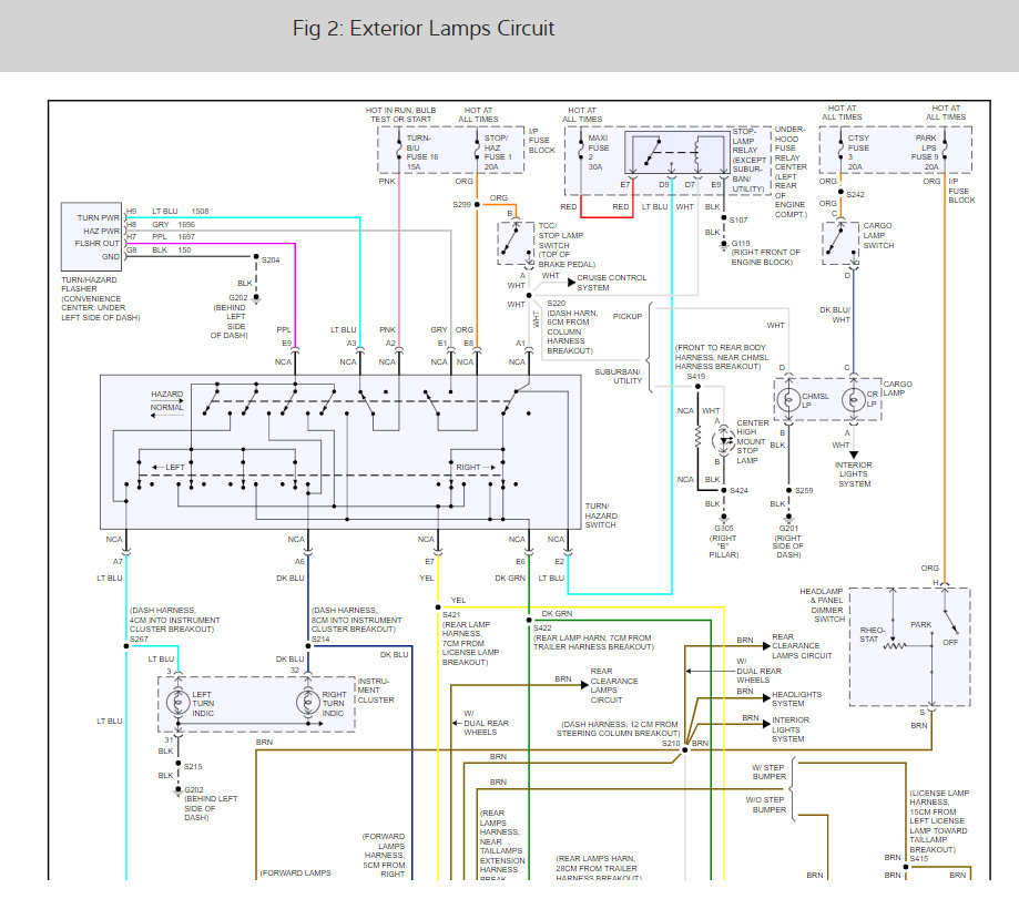

Hi there ive got a problem ive replaced the brake switch 3 times thinking they might of been bad,allso replaced the brake fuse, but still dont have any brake lights,they have allways worked till now what could i check or do to fix this problem. thanks Jeff
Dec 23, 2020 at 5:34 AM (Merged)
RACEFAN966
  • 5,029 POSTS
Ok you have one of two problems here. Either the turn signal switch is bad or you have bad circuit boards in your tail lights. As long as there is not wiring problems or no one added a trailer light connector and did it wrong or something. Here is the taillight connector plate. If I was going to replace them to find out I would do one first as most parts stores will not take back electrical parts once pluged in.
https://images.2carpros.com/forum/automotive_pictures/249564_228062_1.jpg
