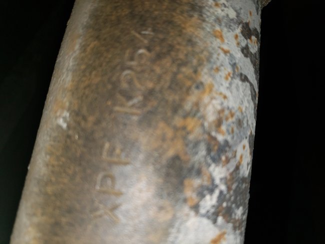

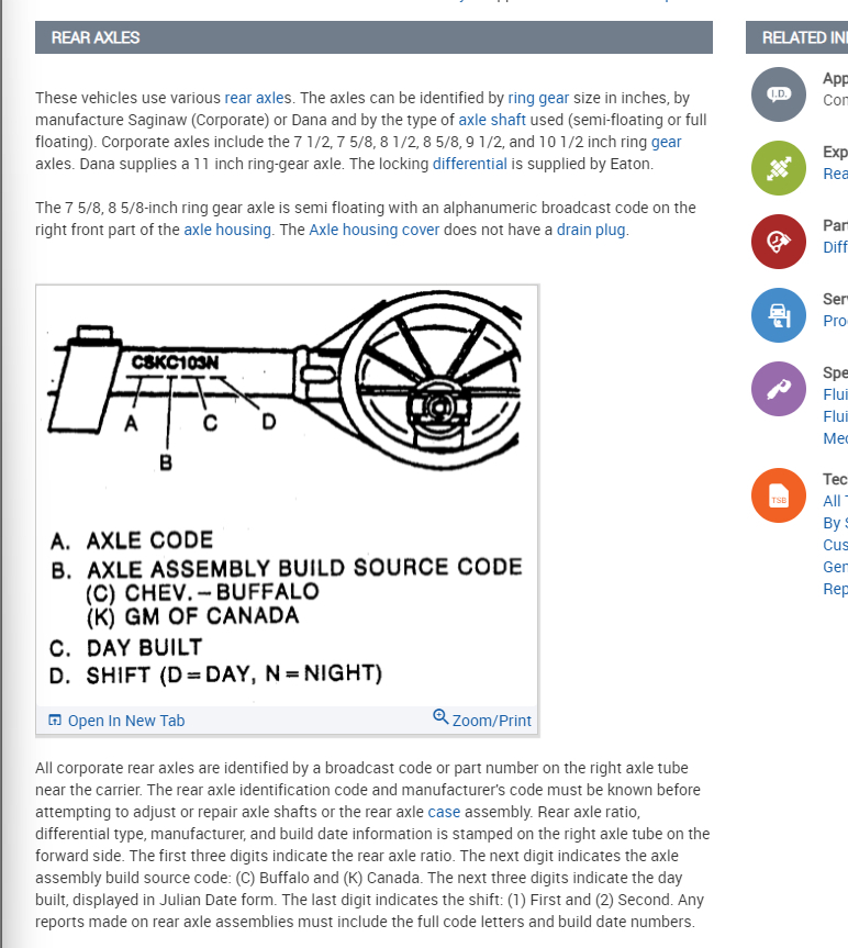

What does XPF K254 stamped on the right axle tube mean? It's an open unit and was thinking of installing a lsd. But want to get the right one.
Nov 1, 2021 at 8:03 AM

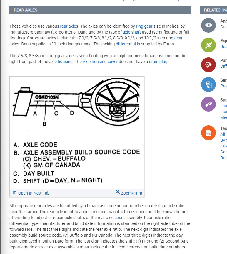

I am attaching the decoding chart that you will need to figure this out.
I am not finding the axle code of XPF at all as this was a Canadian vehicle, so I don't have any records of their codes.
If you are able to find what XPF stands for then that will solve it for you.
The K254 means it was a Canadian axle made on the 254th day of that year, most likely 1992.
However, you are able to get a pretty good idea what the axle ratio is by doing the following.
Since you have an open rear differential, you need to lift only one wheel off the ground so that the drive shaft will spin.
Then mark the tire at 12 o'clock. Then put a tape mark on the bottom of the drive shaft. Then turn the tire two full revolutions and count the number of turns the driver shaft makes.
This will give you your ratio. If the drive shaft spins 8 and a half times, then you have the 8.50 rear axle.

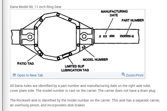

You have the corporate axle and not the dana so you will find your options below, but it appears it is any of them except the 11-inch rear which was the dana.
Otherwise, you are going to have to remove the cover and count the teeth of the ring and pinion gear to find the ratio.
Please let us know if you have other questions. Thanks

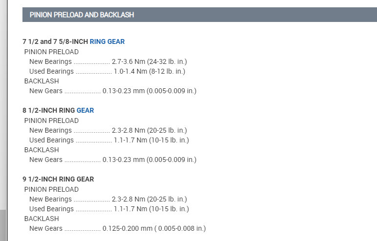

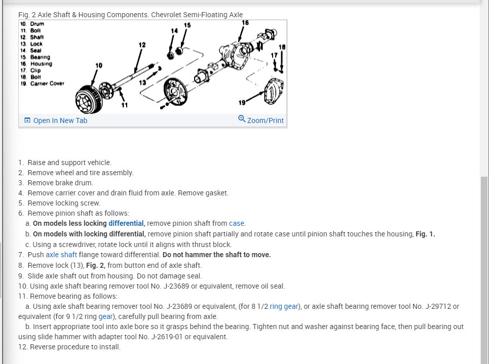

So, I have a few options on LSD units now. Just finished cleaning brake hardware and backing plate and removed the leaking seals. Decided to reinstall the axles and check bearing play. Both sides have "Up and Down" play with the left side being worse, roughly .007/.009. Both axles look good with no pitting or grooves from the bearings. How much play is excessive? Also checked lash which was .013.
Nov 6, 2021 at 5:35 AM

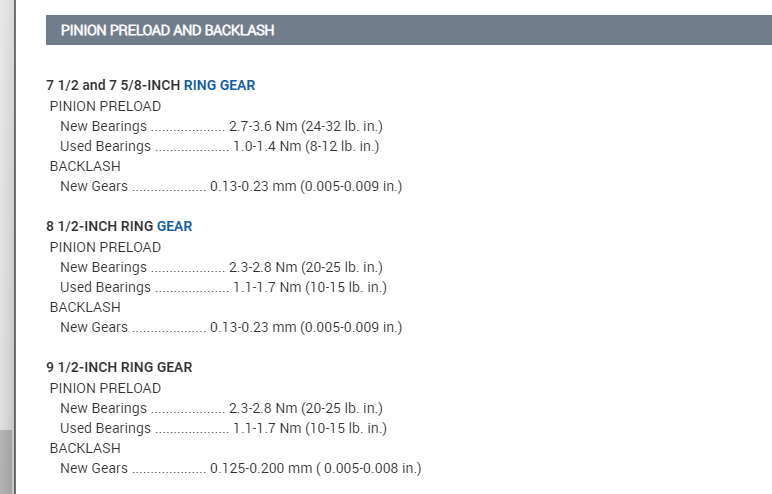

Great job. I am attaching the spec for backlash which you are higher than the spec for new gears which is what I would follow. Even if you didn't have any noise, I would suggest dropping it just to avoid any clunking.

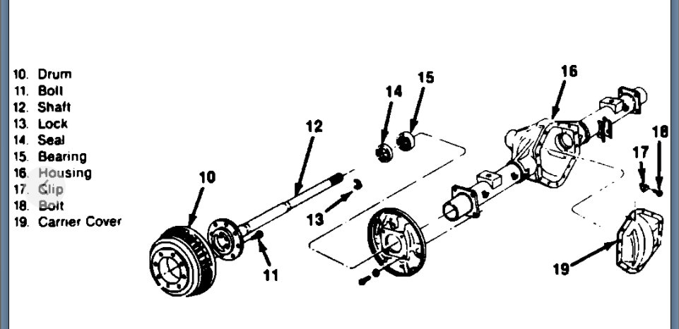

As for the axles, you are talking about movement that you are finding at the outer axle bearings which are number 15 in the attached below? If so, then you should not have any up and downplay so they need to be replaced.
