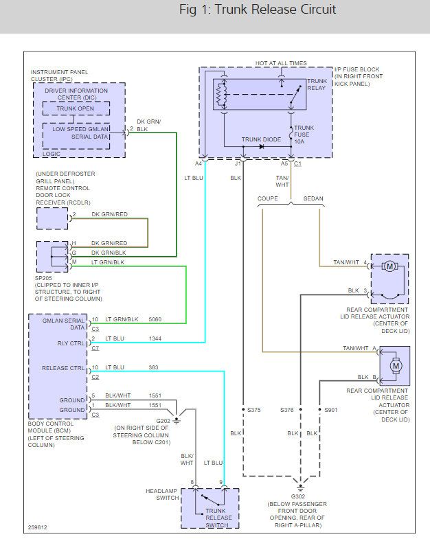

My car's trunk will not open. I replaced the fuse and trunk relay and still will not open. Now what?
Sep 21, 2018 at 1:40 PM
  • 55,414 POSTS
Can you hear the truck latch tring to operate? If so push down on the trunk lid while a helper hits the release button. Here is a guide to help you see where you are losing power and the trunk wiring diagrams so you can see how the system works. Does the fuse have power?
