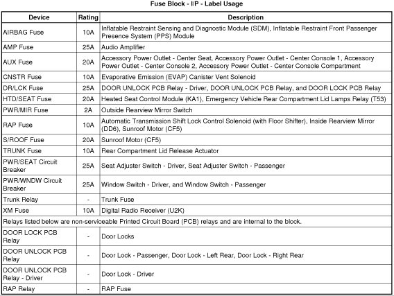

There is a fuse and relay for the trunk. They are located in the I/P fuse box on the passenger side in the carpet molding. I have attached two pictures of the box. The first picture is of the box and its components. The second is a legend of what each part is for.
Let me know if this helps.
