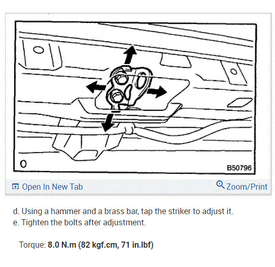

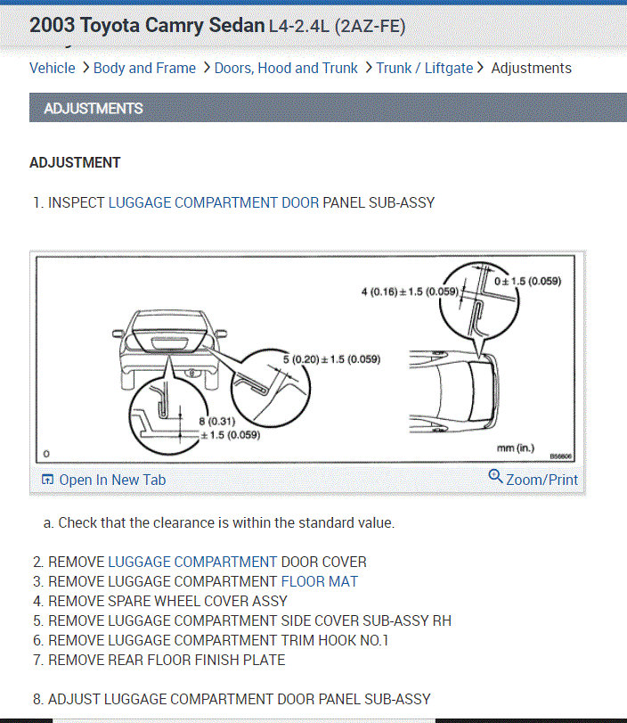

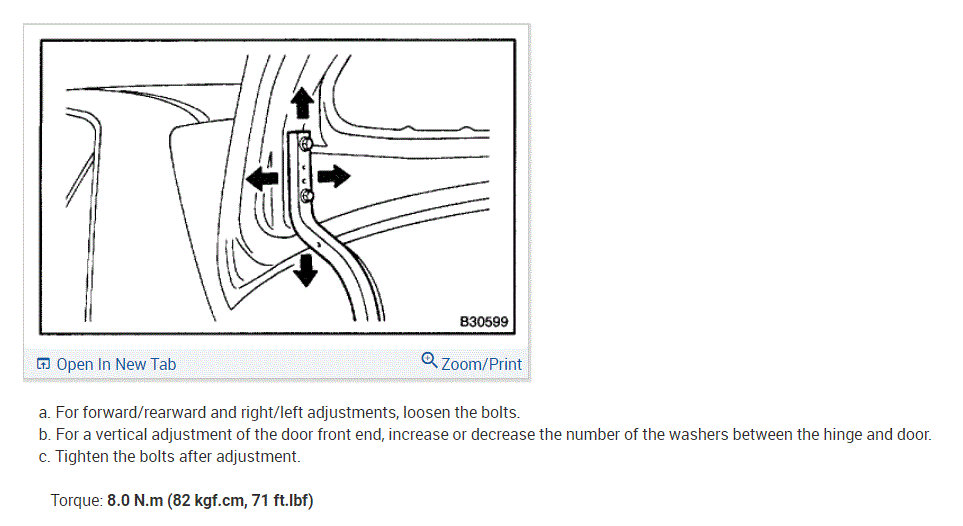

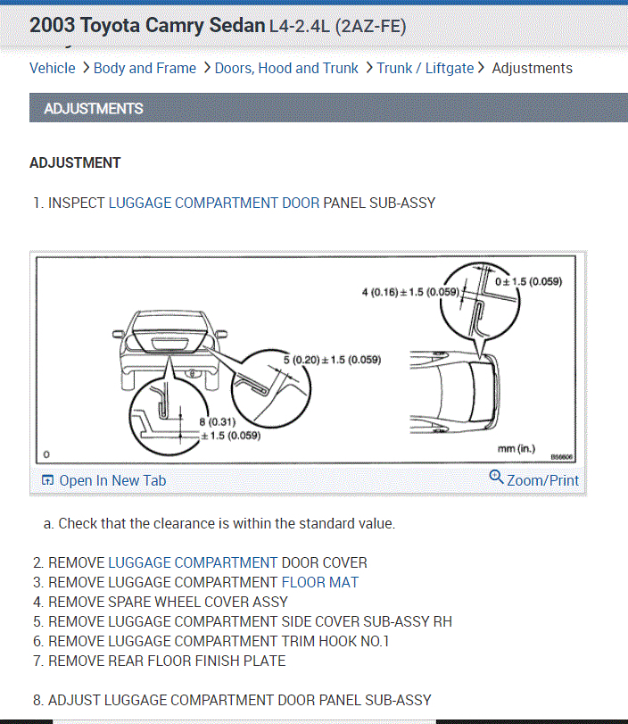

Chances are it needs adjusting. If you hear a click, it sounds like it is releasing. However, something is likely binding and preventing it from opening.
Take a look at the pics below. They explain how to make adjustments.
Aug 3, 2021 at 2:47 PM

You are very welcome. As far as possibilities, if you hear it click, my first suspect is the adjustment. However, if it isn't an adjustment issue, then suspect the lock actuator. What to do is simply actuate it with the release visible to see if it is actually moving.

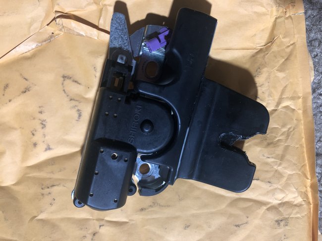

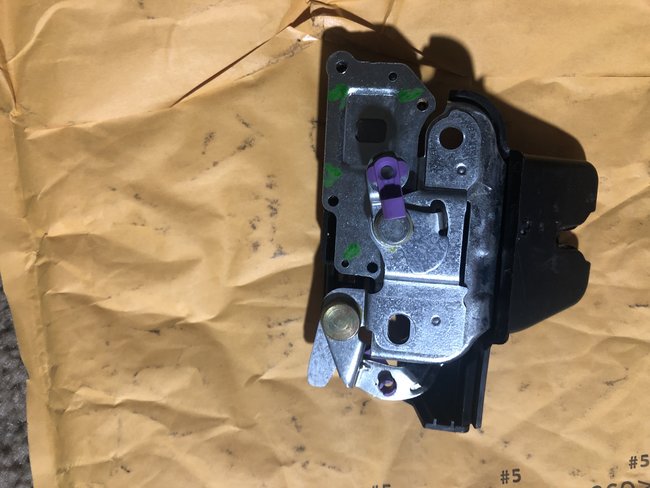

Hi there. yes, it’s a four door sedan and yes it’s a 2003 Toyota Camry. That’s weird because mine is electric actuator. Here is the old part that I replaced.

I don’t think mine is the cable actuator. Since I know it’s the cable release for the trunk and the key lock and this motor that I use for the remote fob.
Aug 3, 2021 at 3:54 PM
  • 110,240 POSTS
Thanks for the info. I have no idea why it isn't listed. However, what you have is certainly electric. LOL

Okay, sounds good. so I just follow the pictures you sent me to adjust it so it can latch on to the actuator? What software you use from the pictures you sent me so I can go step by step?

As far as the diagrams, we use two automotive websites, Alldata and Prodemand. They will charge you for the service, so let me know what you need and I'll get it for you.
As far as the noise, does it seem to be coming from the trunk area? Also, the adjustment I suggested is because if there is too much load on the latch, there is a chance the actuator just isn't strong enough to release it. That is a theory at this point. It will require trying to see if that helps.

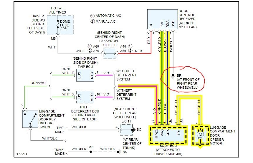

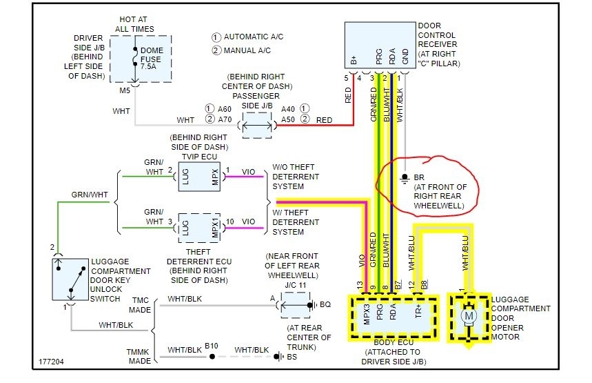

Good afternoon,
I found the diagram for you to view. The motor works off the body control module. A signal is sent when your remote commands the module to open the trunk.
You will need an advanced scan tool to monitor the activities of the remote and the signal to the trunk motor.
The controller is located at the C pillar which is the pillar behind the back door.
Aug 6, 2021 at 6:38 AM

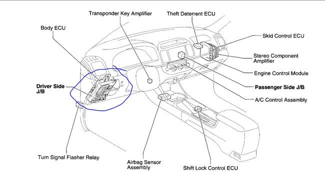

One more thing Roy. Can you send me a diagram of the front of the right rear wheel well? I just got myself a multimeter and I’m having a hard time finding the location of the controller to test it. Thank you.
Aug 7, 2021 at 1:44 AM
Okay, that controller is for the doors and locks. The trunk works off the body control module.
https://www.2carpros.com/articles/how-to-replace-a-bcm-body-control-module
I attached the location for you. Left side in the front under the dash.
Aug 7, 2021 at 6:49 AM

All right thank you Roy. Now that I have a multi meter should I check to see it gives 12 volts or not? So that way I can replace the BCM?
Aug 7, 2021 at 10:05 AM
Correct.

Thank you once again. I noticed that the BCM has many fuses connected to it. Which one specifically I should take out to find to test the trunk voltage?
Aug 7, 2021 at 10:13 AM
Not a fuse, the wire to the trunk release.
Aug 7, 2021 at 10:15 AM
VLADSC50
  • 42 POSTS
Nevermind I found the one I need to test. It’s from the diagram you previously gave me.
