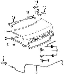

How do I disable the trunk release inside?
1994 TOYOTA CAMRY
125 MILES • 6 CYL • FWD • AUTOMATIC
MELHARVEY
I'd like to disable the trunk release lever in this car, so that the trunk is only able to be unlocked with a key. Is this possible, and how do you do it? (I'd just prefer the trunk be inaccessible in case the car is broken into.)
Thanks!
Nov 6, 2008 at 12:56 AM
DSPLC
  • 220 POSTS
When you lift the trunk lid /luggage door, you will see cables on the left side . One is a wire cable and the other is a release cable (like a bicycle brake cable). Follow that release cable that is connected to the trunk door lock assembly. Unscrew the trunk door lock assembly and unhook the cable. The cable that you will follow is like the brake cable of a bicycle. Just unhook the end of it which is connected to the trunk door lock assembly. Photo: 4 is the lock assembly 8 is the release cable 9 is the trunk release lever beside the driver's seat
