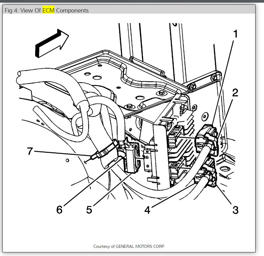

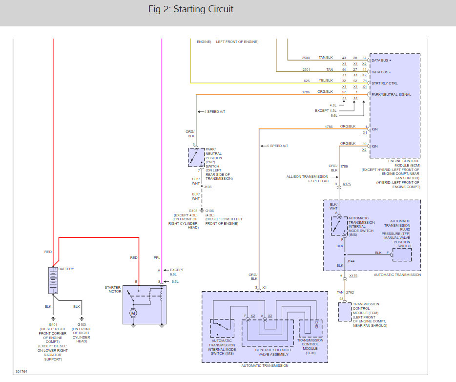

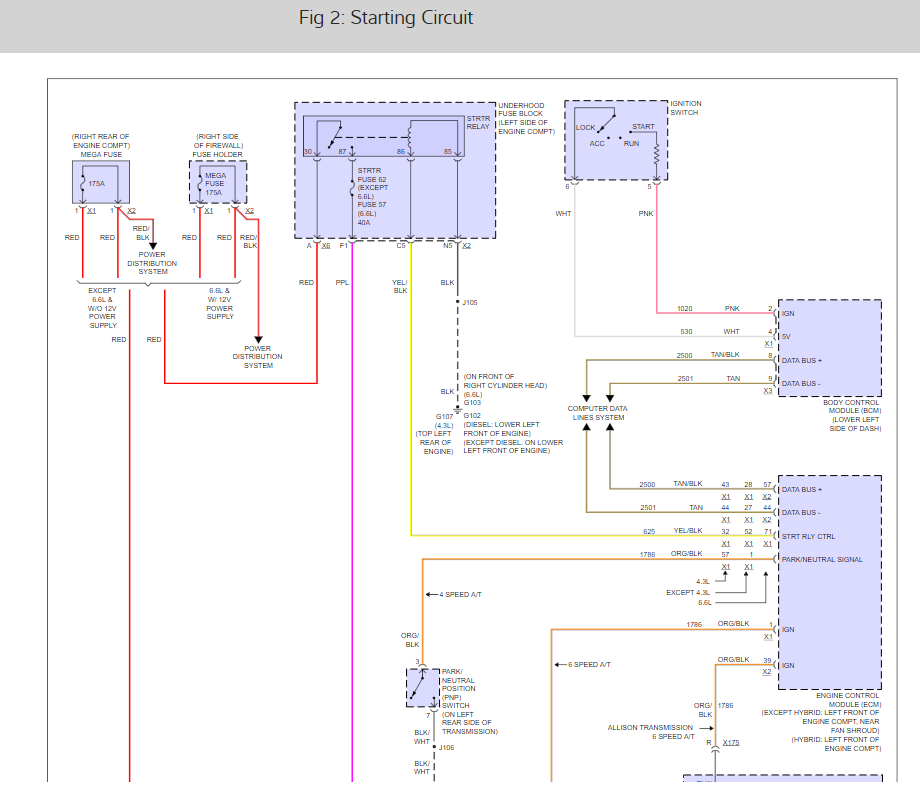

When I turn the key to the crank position the starter cranks the engine over, but it will not fire or start. When I move the key to the on position, the starter continues to crank the engine over until I move the key to the off position. I have replaced the battery, the starter, and the ignition switch. If I spray starting fluid in the intake, the engine still does not fire.
Oct 10, 2018 at 1:11 AM
  • 55,423 POSTS

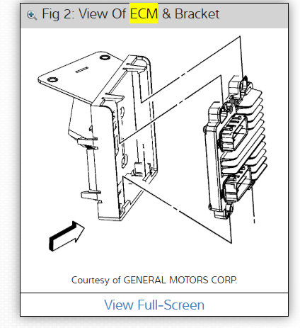

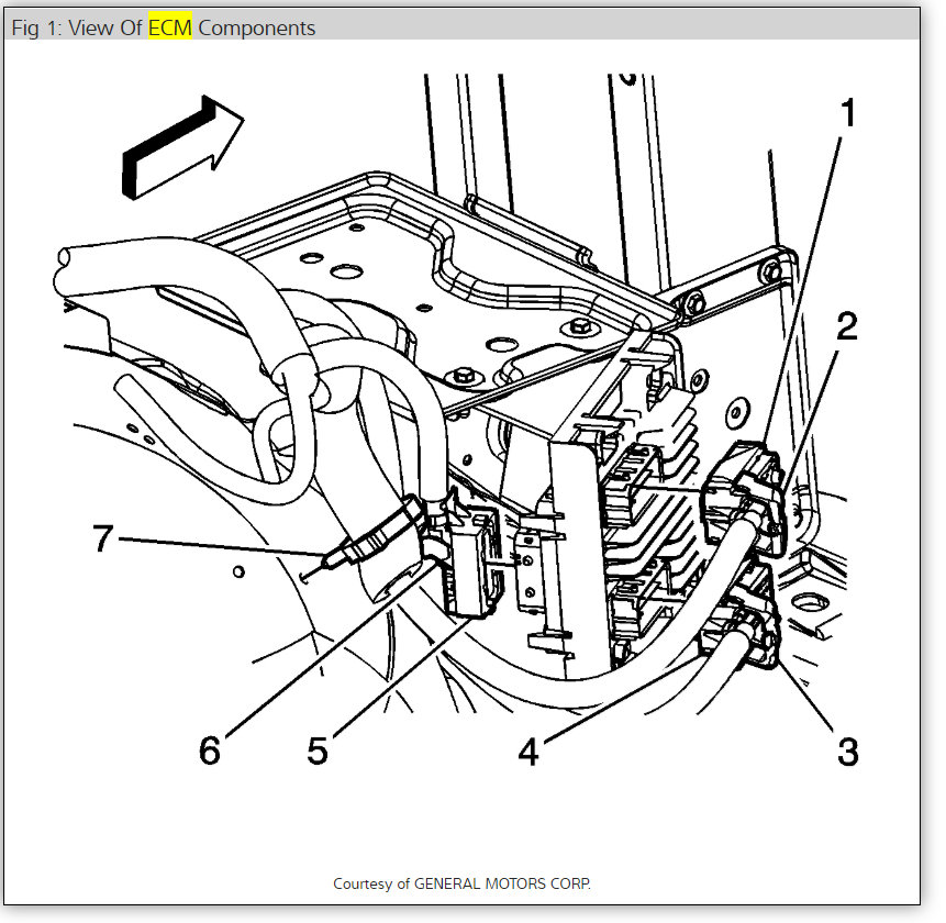

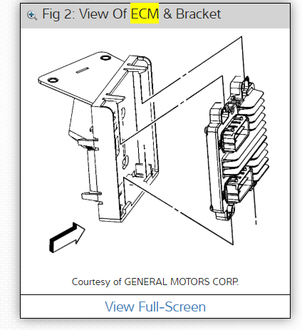

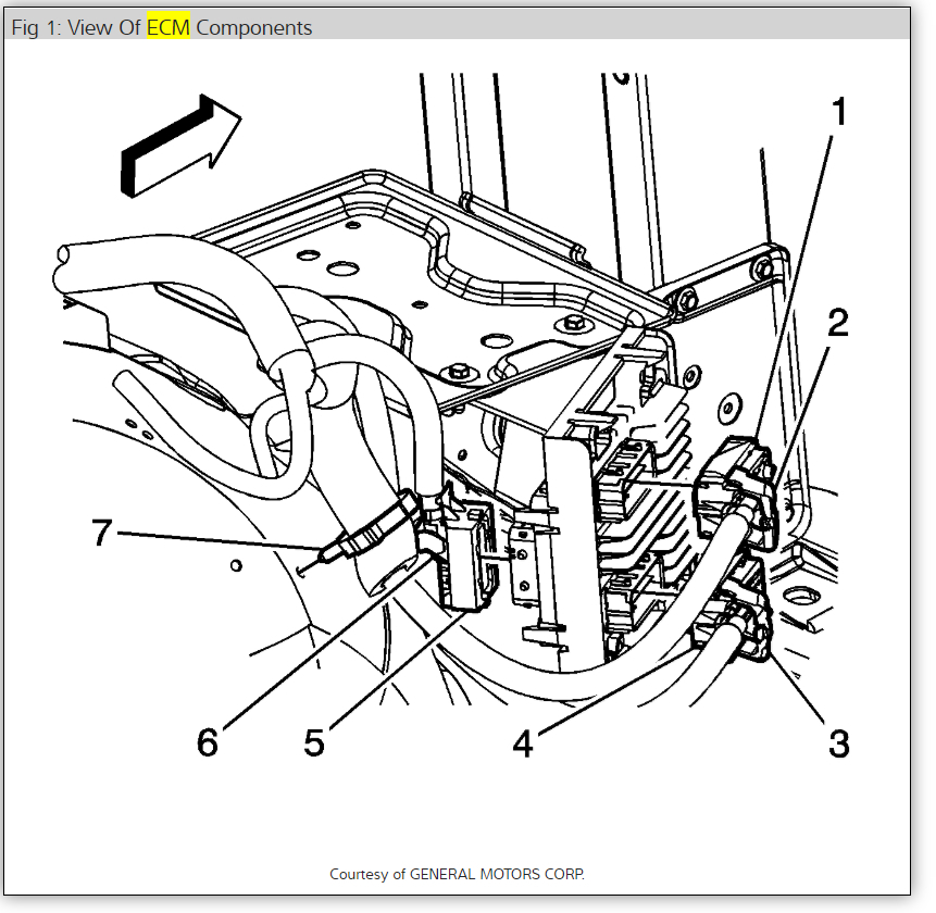

It sounds like the PCM has gone bad. Lets run the codes to confirm the issue. Here is a guide and the location of the PCM. You will need to get it programmed which you can have that done from where you order the new one from have your VIN number ready.

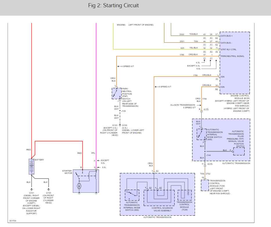

Here are the starter wiring diagrams so you can see how the system works.
