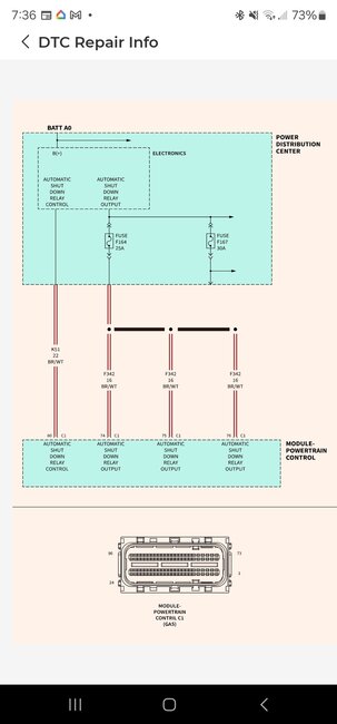

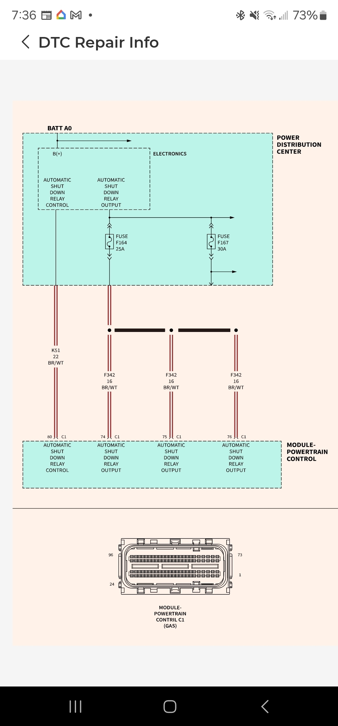

I have the truck listed above that will stall out when I hit a bump. It will crank but not turn over. I had talked with someone on here before and thought I we had figured it out. Before I wasn't getting any codes. Now I am getting a P0688. I have blown 3 fuses to the fuel injectors. With my diagnostic scanner it will give me a wiring diagram to follow, but I'm a little stumped on what F342 is or K51. Any help will be appreciated. I'm about to lose my mind with this.
