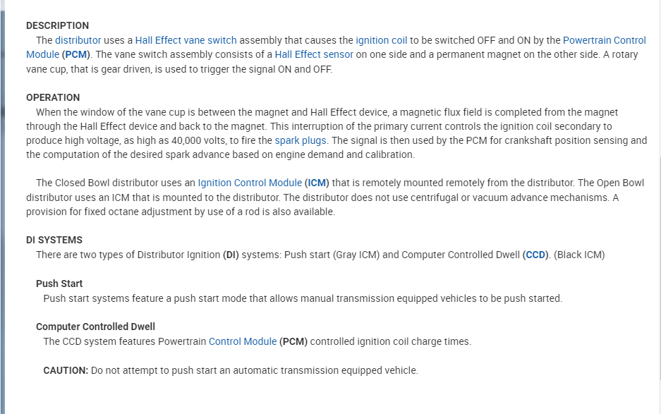

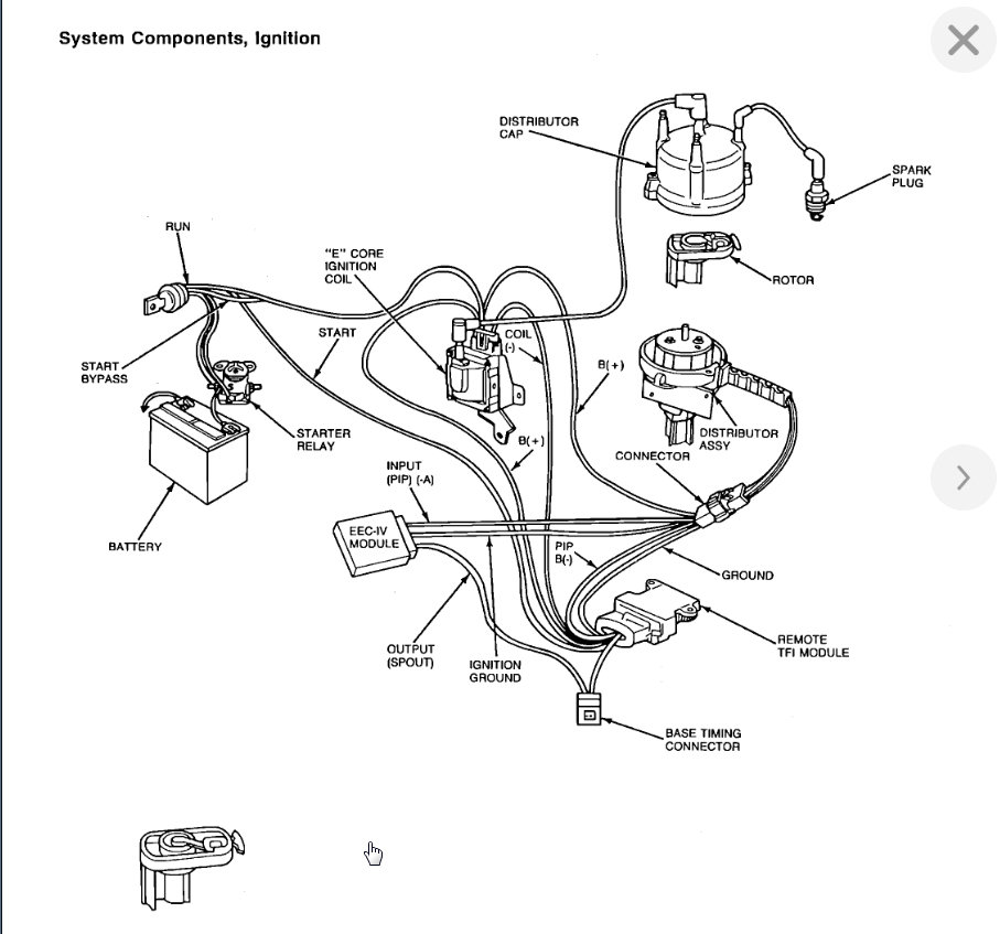

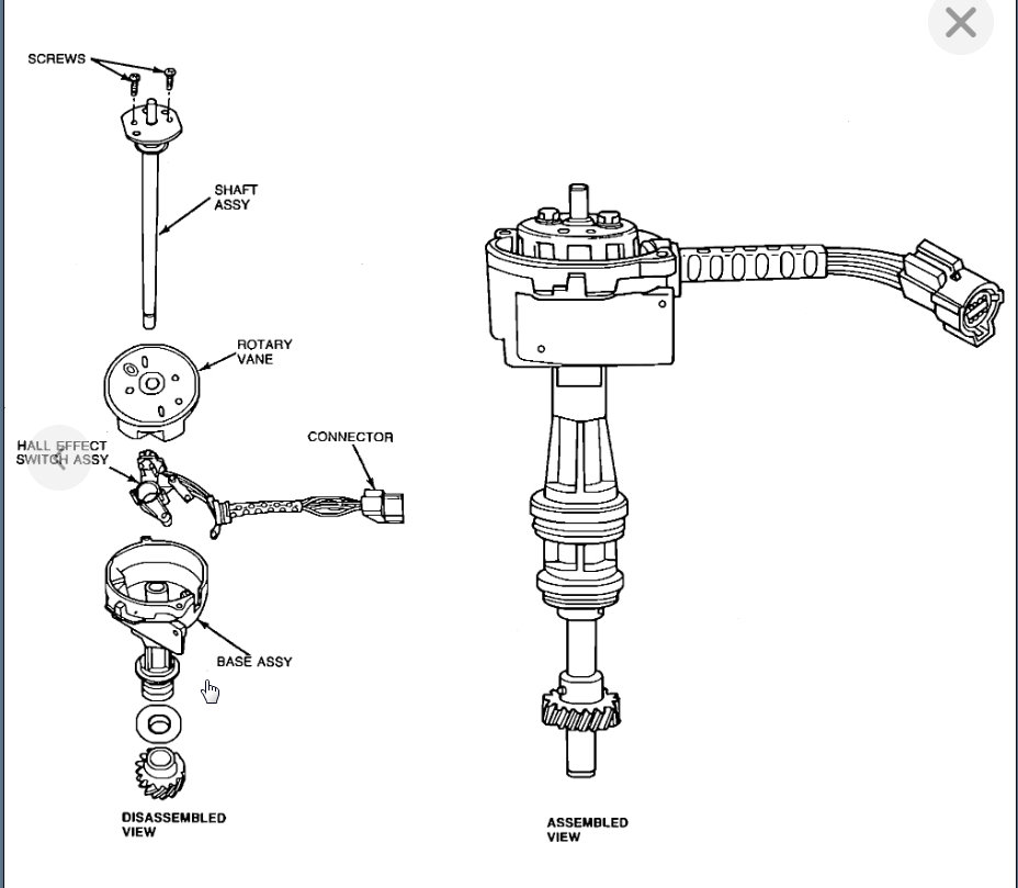

If you take a look at the attached documents, it will explain how this system works. If we can confirm that there is no spark then we know we are on the right path. Please pay particular attention to the statement where it says the distributor has a Hall Effect switch that controls the coil. These hall effect sensors and switches have a propensity to fail when they get hot. Normally this is found with crank sensors as they are hall effect as well but your truck does not have a crank sensor but it does have this switch.
Let me know if you have no spark and then we can test the coil. If the coil tests okay then you need to rebuild or replace the distributor. Check out the diagrams (Below). Let us know what happens and please upload pictures or videos of the problem.
