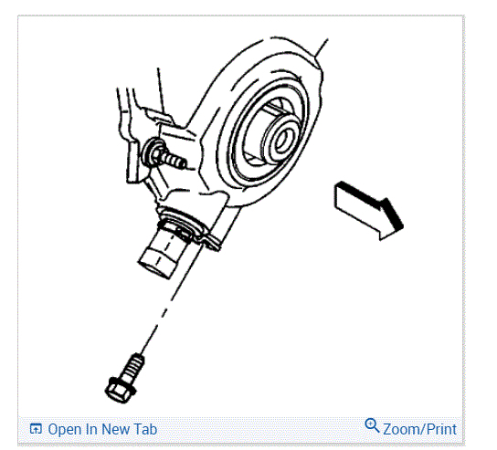

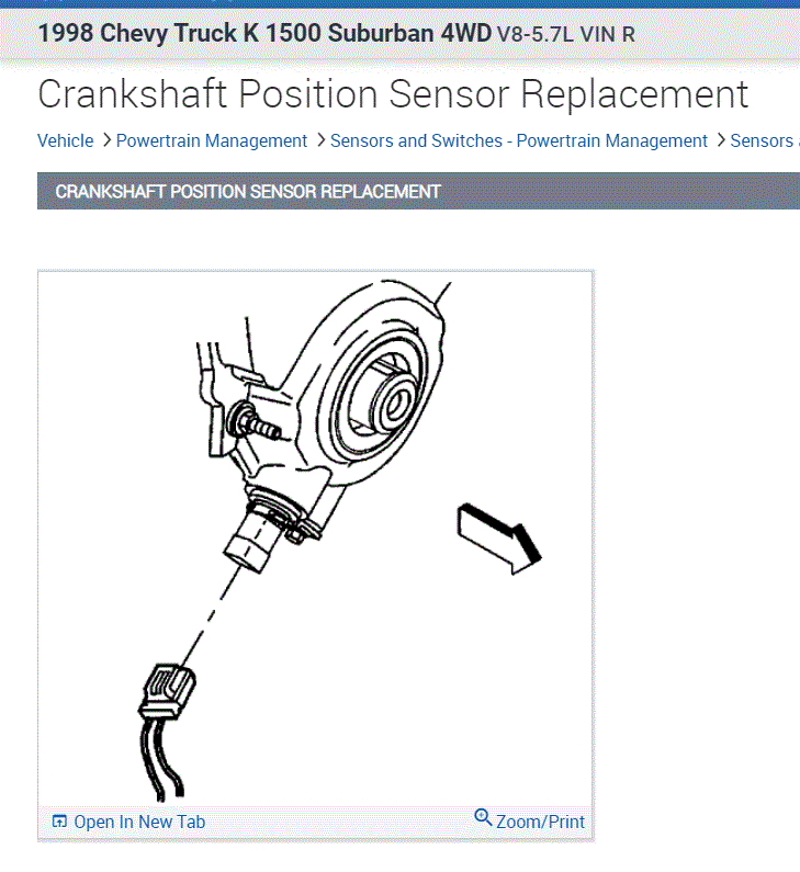

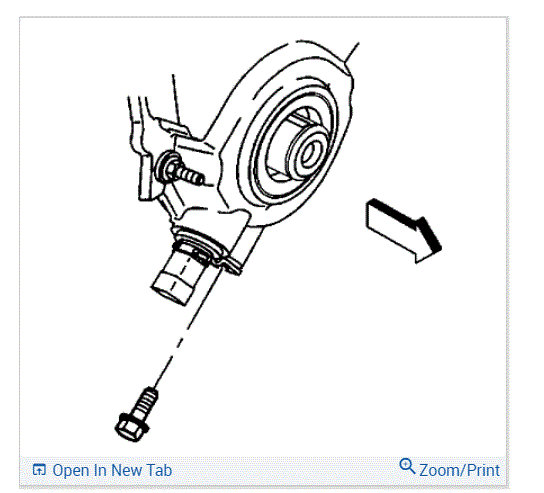

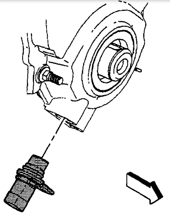

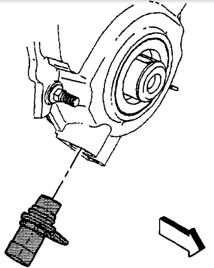

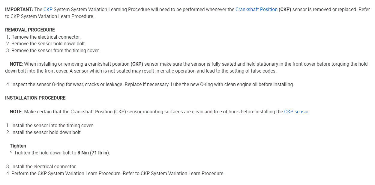

Tiffany,
If you aren't getting spark to the spark plugs, chances are it is related to the crankshaft position sensor. If you have a tachometer in the truck, crank the engine and see if the gauge moves a little. If you have a live data scan tool, check for an RPM signal when cranking the engine. If there isn't one, the sensor is my first suspect.
Take a look through this link and let me know if it seems to mirror what you experience.
If it does, that is where I would start. Here is a link that explains how one is replaced:
If you look at the directions below, they are the directions specific to your vehicle.
